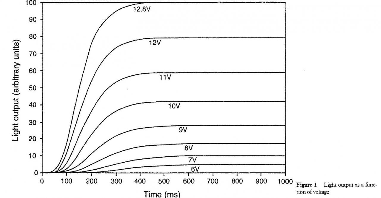

January 10, 201114 yr comment_341437 For incandescent bulbs, light output will drop proportionally to voltage. According to this reference, dropping the voltage by 5% drops light output by 20%. That means you're getting 80% of the light at 13.3 volts that you would at 14 volts. It's not unusual to have a 2 to 3 volt drop at the headlights. That's a drop of 14 to 21% in voltage. (Attached is a chart I pulled from this study.) If you're going to drive at night in a 40 year old car, add relays to the headlight circuit! For LEDs, light output is also proportional to voltage up to a point, so a parking light relay harness can improve light output. (For the record, I have no idea at what point a voltage increase does not increase light output.) Link to comment https://www.classiczcars.com/forums/topic/38188-240-alt-swap-questions/#findComment-341437 Share on other sites More sharing options...
