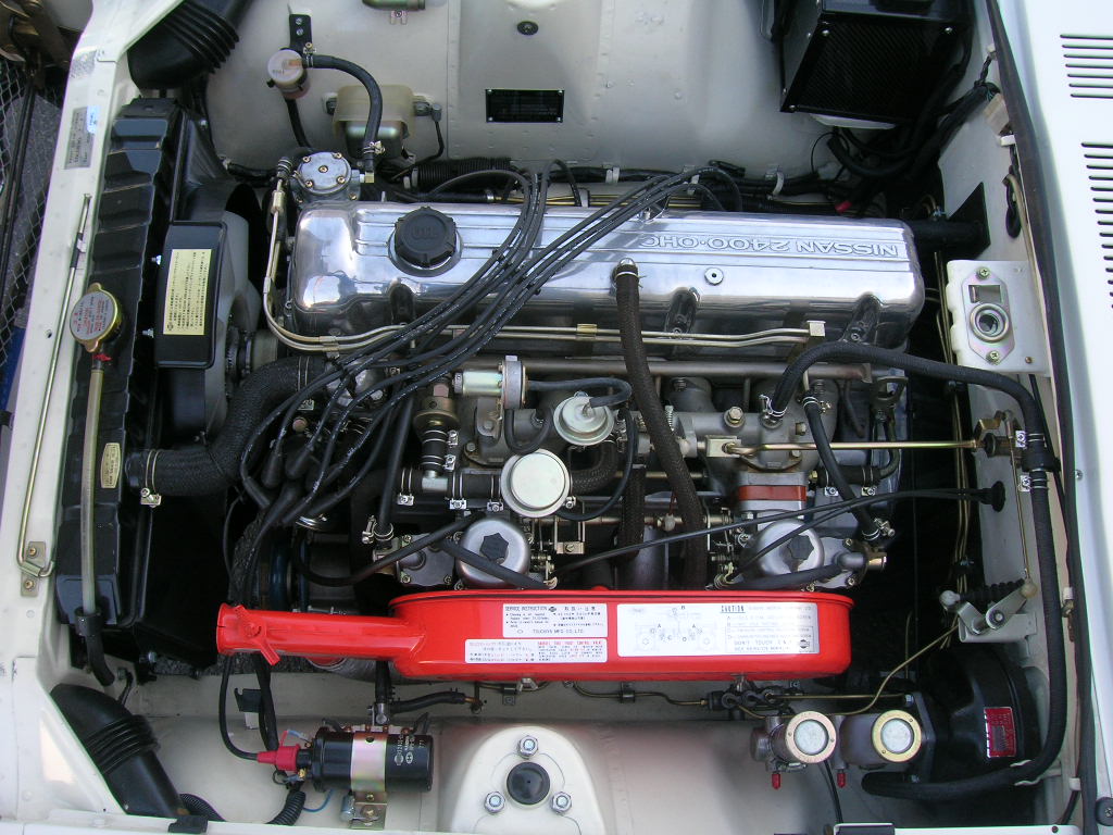

Posted January 10, 201114 yr comment_341463 A week ago, I came across 6 feet of old braided Jaguar vacuum hose that happened to match the size and look of 240Z vacuum brake booster hose so I tried something today. I cut to length and then stuffed a aluminum wire through them and stuffed the two into my oven at 400 degrees. The object was to see if they well retain the shape of the wire. After about 40 minutes, I quickly doused them in cold water. And guess what! it worked! The pick shows them in the oven before I closed the door. I made the wire so that there was no part of the hose touching the frying pan or the oven walls. In my excitement, I forgot to take a pic of the hose but well tomorrow night. SO if you can find braided hose that can work, there is a chance you can modify it to what shape you want. I cant say this well work for water lines because of the pressure but you might want to give this a try for other things. JUST MAKE SURE YOU DONT BURN YOUR HOUSE DOWN! Watch it! Polecat:) Link to comment https://www.classiczcars.com/forums/topic/38199-hoseturning-a-cat-into-a-zed/ Share on other sites More sharing options...

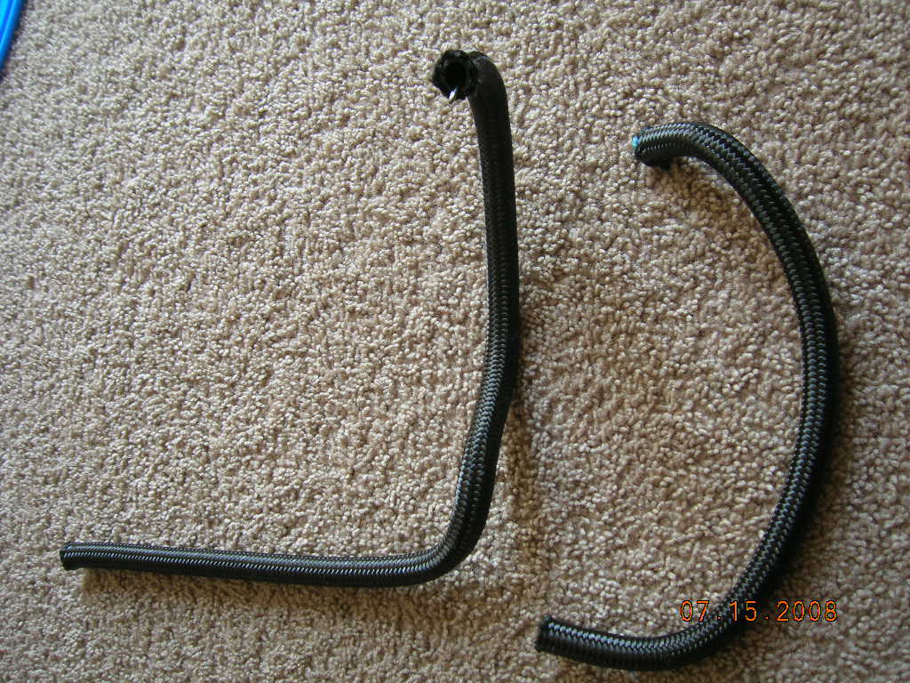

January 11, 201114 yr Author comment_341588 Ok Here is a update on the hoses that I shaped. After a full 24 hours, they still retained there shape and are flexible. So far OK. The old decreptid hose is the one on the left in each pic as to the new Jag hose thats been reshaped. Esprist, how much do you think those hoses well be when they are available? And well the set include the early 72 manifold to check valve hose? Thats the one that cant be found. Polecat Edited January 11, 201114 yr by Polecat Link to comment https://www.classiczcars.com/forums/topic/38199-hoseturning-a-cat-into-a-zed/#findComment-341588 Share on other sites More sharing options...
January 11, 201114 yr comment_341591 The results look good to me so far. Boy, that gives me some ideas for some other projects. Link to comment https://www.classiczcars.com/forums/topic/38199-hoseturning-a-cat-into-a-zed/#findComment-341591 Share on other sites More sharing options...
