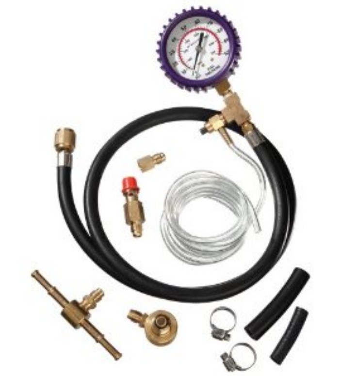

Most fuel pressure gauges come in a kit and look something like this - http://www.amazon.com/Actron-CP7838-Professional-Pressure-Tester/dp/B0009XQUKC/ref=sr_1_2?ie=UTF8&qid=1294694575&sr=8-2 - and cost about that much. They're usually in a bubble pack somewhere in the store.
My car too stunk things up, and got bad mileage, when the fuel pressure regulator was bad. It's always good to know fuel pressure on a fuel-injection system.
If your mechanics have not actually measured the fuel pressure yet, then they're not being very thorough, especially considering the symptoms you've described.

We never measured fuel pressure, after the fuel pressure regulator. I am not sure how to do that?? They are cheap enough I should just buy a new one. Fuel pumps (good ones) are not cheap of course. I think my source has bosch type replacements.
OK, well I have seen those kind in my local stores, however, I didnt think they could be used on the 1978 z car. I mean there isnt any port to hook it into on the fuel rail, right? Can I use this acton version that you showed, on the Z car. I want to leave it in there, while I go for a test drive. That hose looks pretty long. I just wanted to use like a few inches of fuel injector hose, right after the fuel filter. Can I hook that one in the URL, up to the 78 z car right after fuel filter?
I may just go ahead and order one of those, or see if my local foreign car parts store has one. Once in a while I get lucky and they have a few parts for my car. I mean it cant hurt to change it right? And how easy is it to change anyway???

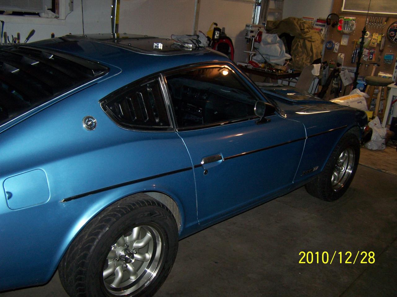

There are a couple of pics of it....before and after I added new tires and rims, and side louvers. I also added an air dam which definatley stablized it at interstate speeds. Also when I first saw it on the showroom floor in 2008 in chicago. Thats when I saw it, drove it, bought it.
But she is still definately sick and needs help. Its going to be along uphill battle.
