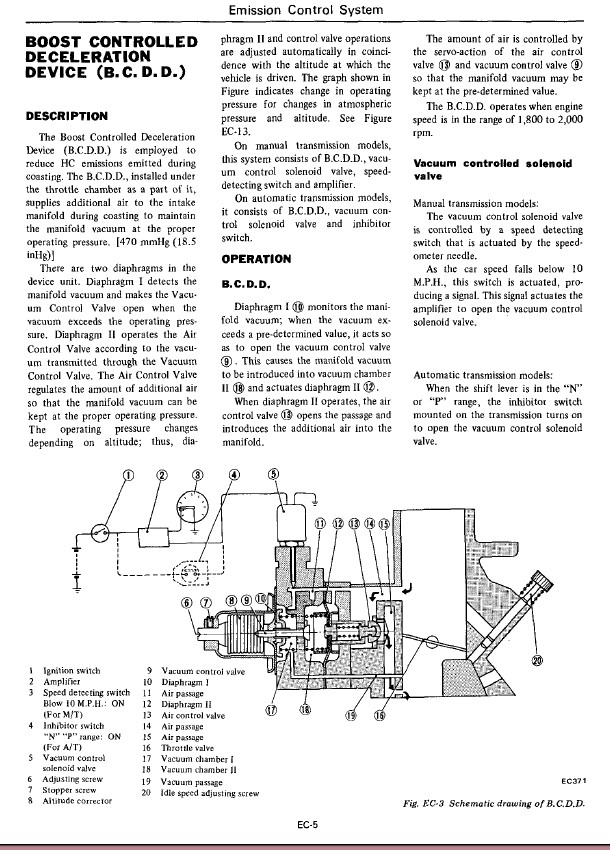

Posted January 10, 201114 yr comment_341516 I've searched multiple forums and have not yet found an answer. What does the throttle chamber on the bottom of the TB actually do and why is it adjustable? Link to comment https://www.classiczcars.com/forums/topic/38204-throttle-body/ Share on other sites More sharing options...
January 10, 201114 yr comment_341519 You're probably looking at the BCDD. It's described in the Emission Control section of the FSM. Link to comment https://www.classiczcars.com/forums/topic/38204-throttle-body/#findComment-341519 Share on other sites More sharing options...
January 11, 201114 yr Author comment_341634 Thanx Zed Head, thats the part, my manual refers to it as the "Throttle Chamber." Link to comment https://www.classiczcars.com/forums/topic/38204-throttle-body/#findComment-341634 Share on other sites More sharing options...
