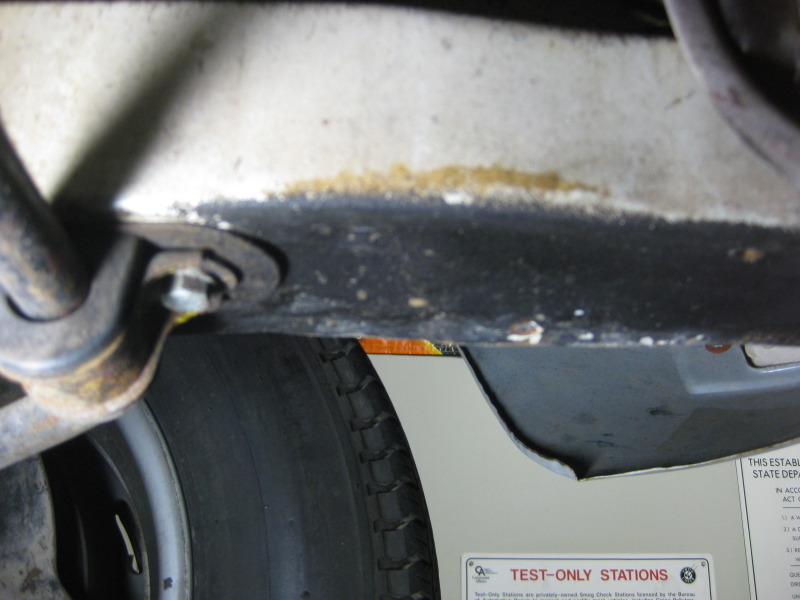

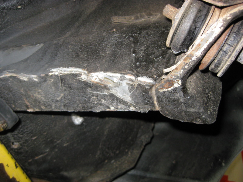

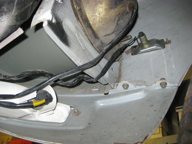

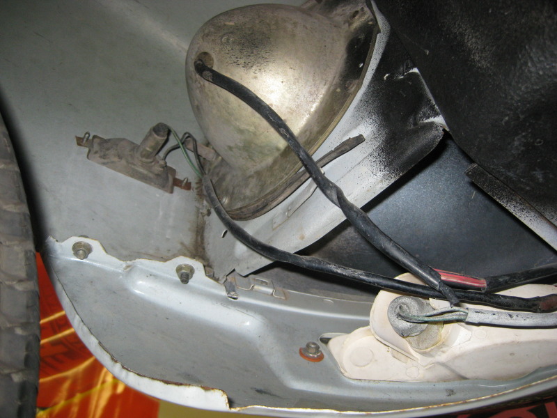

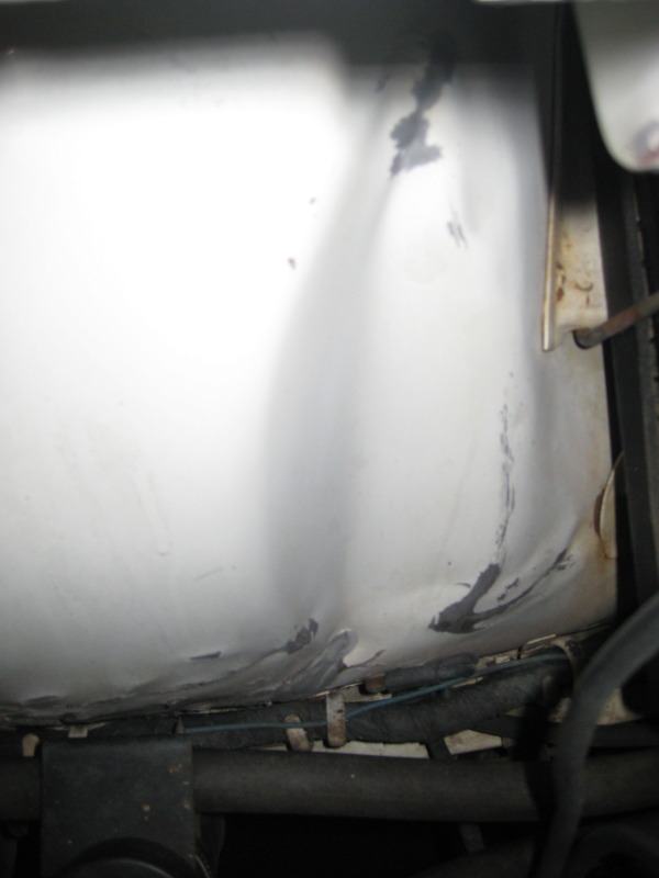

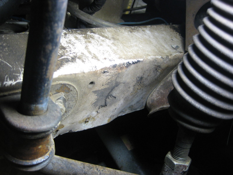

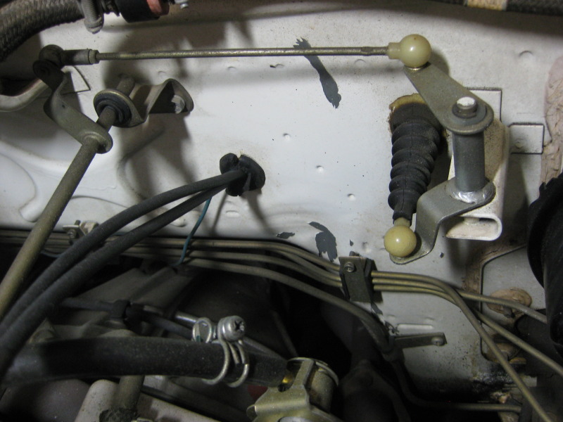

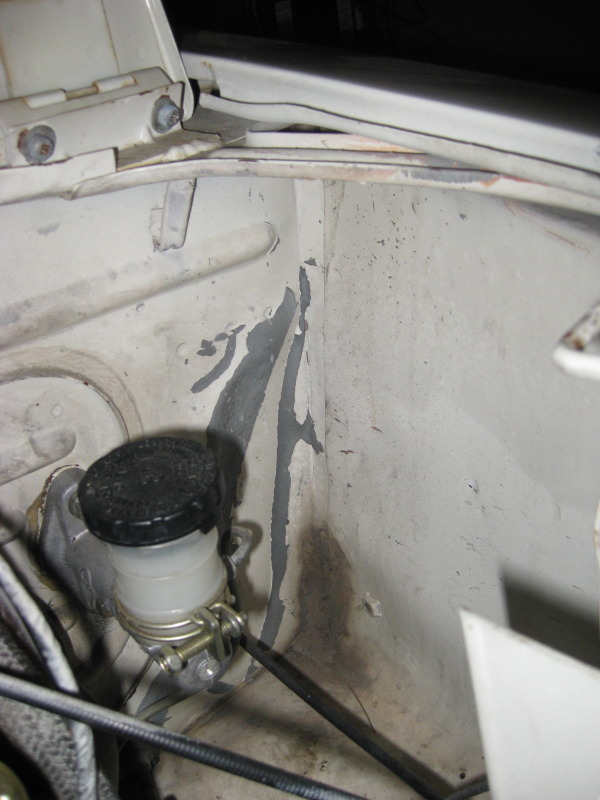

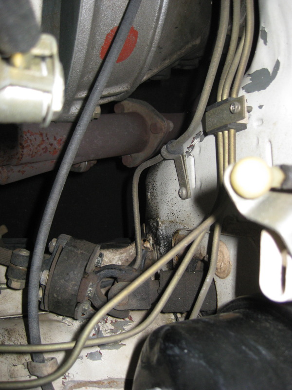

Based on the pictures he posted, I still think it could be a 10k mile car, but it was definitely hit hard in the front. Both the inner fenders and parts of the firewall are buckled, which you can tell by the flaked off paint. It looks like both of the fenders, valance, and headlight buckets were replaced and the back sides of the panels left in the original grey primer/paint that replacement parts came with. The frame rails look like they have been straightened. It may still be a good driver if the alignment is ok, but to make it factory correct again would be a lot of work and costly. Hopefully the buyer is knowledgeable enough to understand what he bought and is ok with what it is.

I agree, I think someone will not be happy with the purchase when they get a good look at it. The repairs could have been done better on the car. Normally pictures hide most things, and we found a lot of things.
Now if the car was close to me I would have taken a look, and paid to have the car's body checked out. I saw a lot of great parts, it the car was to twisted to restore more than likely what he was asking I could part it out for my project. I think the car might be twisted enough not to restore to original but to make a custom car, that way it would look good with the sub-framing being reinforced in case of structural cracking, and use the parts to help restore my current Z.
