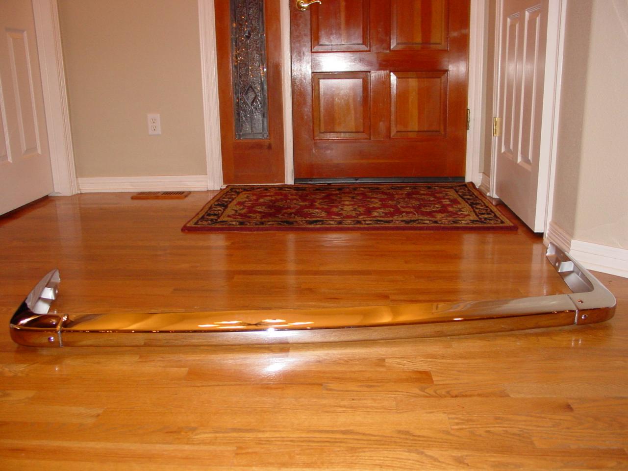

Hi Kenny,
Your bumpers came out great!
I love Denver Bumper, they are a great company and provide good, old-fashioned customer service.

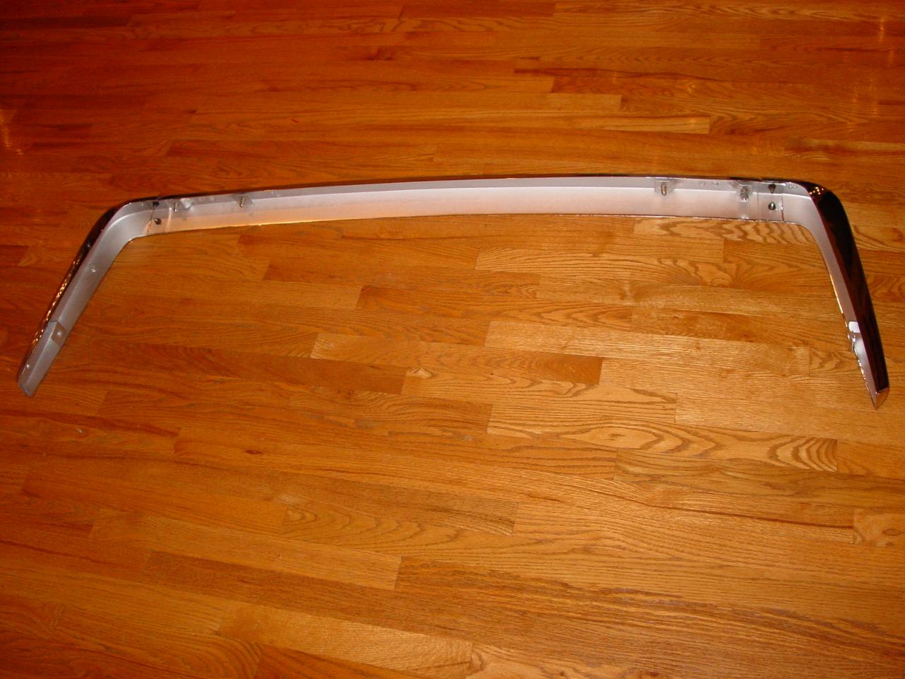

I had my front and rear bumper done by Denver bumper last year. I loved the results but I have to say that the back of the bumpers are now rusting badly. :disappoin This surprises me as the backs did not look like bare steel but I guess whatever they put on the back was not good enough to keep rust out. I plan to take them off and POR 15 the backs next weekend.
Yes, the backs are raw metal and they absolutely need to be painted before mounting them on the car. I use Rust-Oleum Painter's Touch "Metallic Aluminum" on my bumpers (see below pics).

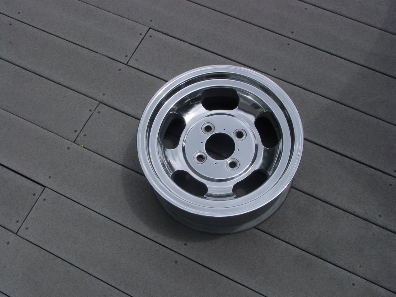

Denver Bumper not only re-chrome bumpers, but they will also restore the old slotted mags. They dip the wheels then buff them out and remove any curb rash for a very reasonable price (see pic below). Mine are now mounted along with new tires on my latest '71 project.

Before using POR15 you need to have that rust blasted off or it will continue it's meal underneath the coating. It is possible to blast the inside without damaging the outside. I had a set of bumpers plated in 2000 and although no one told me either I just new it was a good idea to put something over the inside surface. I just used truck bed liner and 11 years later no rust. But by all means don't just cover the rust get it removed. Good Luck.
I believe POR 15 can be painted directly over rust. That is the point of it. As long as you use their three step process of Marine clean, Metal ready, then the POR 15 paint you should be all set.
I wouldn't recommend using metal ready around fresh chrome. One drip or splash and you have pitted chrome.
