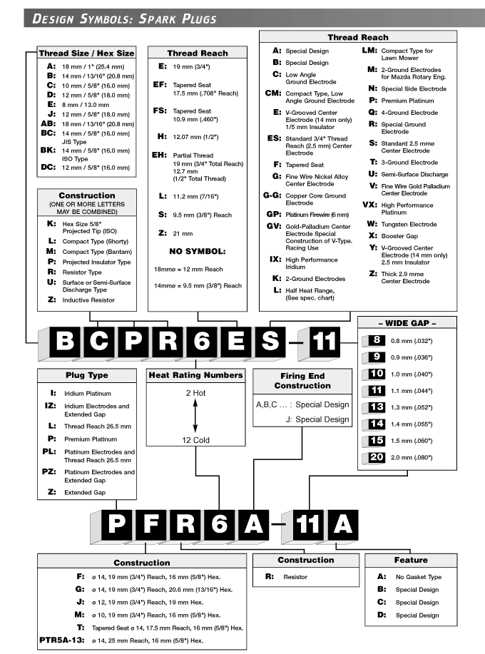

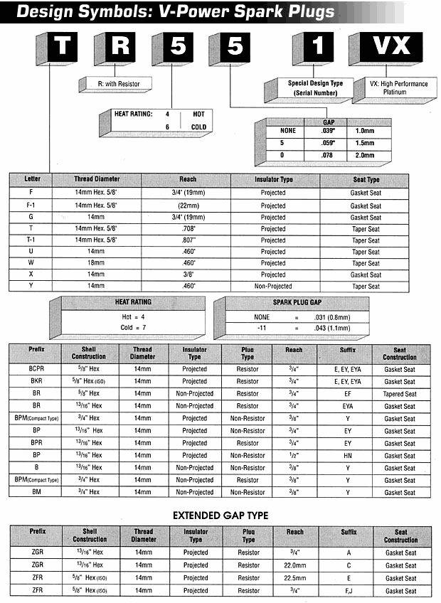

Here are the NGK spark plug guides for us.
Using the chart attached below, we see that the NGK BPR6ES spark plug (for example) refers to:
B - 14mm Thread Size and 13/16" Hex Size
P - Projected Tip
R - Resistor Type
6 - Heat Rating (2 = hot, 12 = cold)
E - 19mm Thread Reach
S - Standard 2.5mm center electrode
