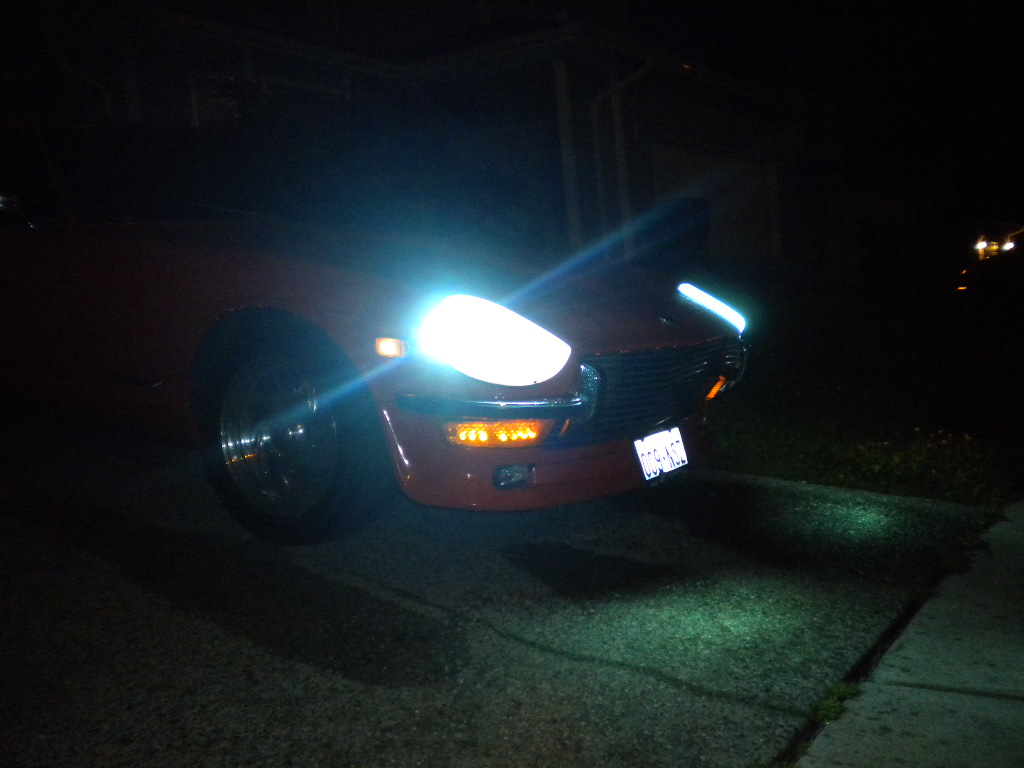

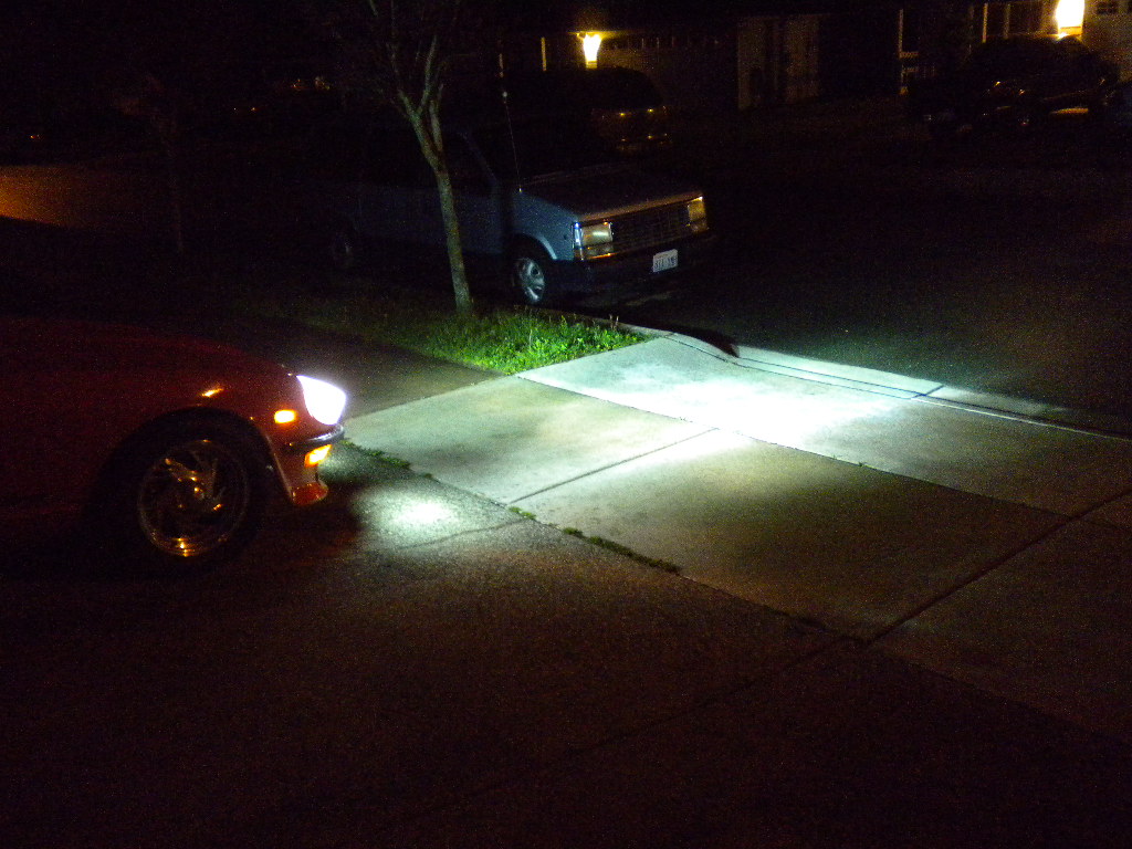

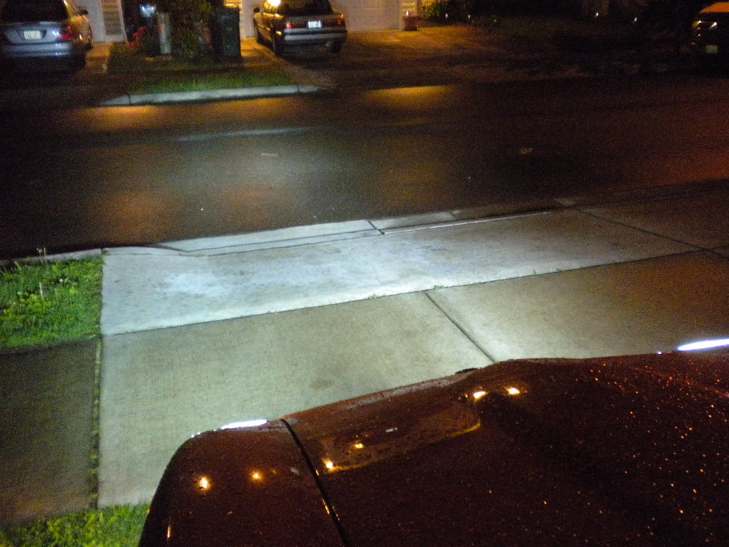

I'm running Hella's with H4 style 6000K Bixenon HID's with 35 watt Ballasts.
Great fit, great Low Beam, Hi beam is Awesome. Very clean and it's said that HID bulbs last longer than standard H4's. Here's a couple pics....
Dave
Car is on a downward sloped driveway, that's why the lights seem to be right in front, rather than further out in the road.
