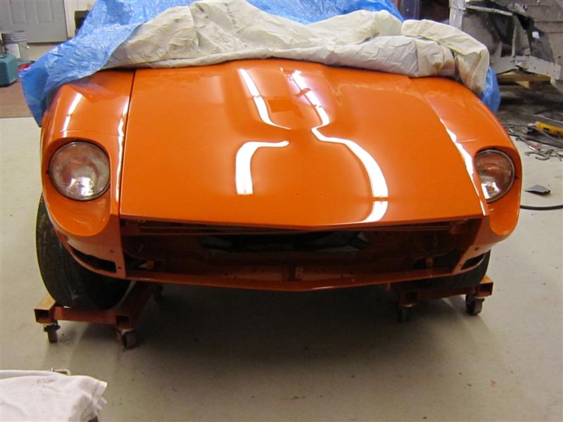

If you have grit or dust in the paint you can block sand it out CAREFULLY with the 2000 before you buff it. You cant do too much with the metallic without affecting the way it looks. I didn't use metallic just Acrylic Enamel with out a clearcoat, blocked with 1500 and then 2000 before buffing it out with the Dewalt DW849 buffer and Norton buffing kit from Eastwood. I taped off the edges with 1/4" painters tape and didn't sand the edges at all. Removed the tape after the wool pad and just took it really easy so as not to cut through with the 2 polish pads and was amazed at how quick the paint polished up. If you don't have any grit in the paint just start with the buffer and see how it looks. you can always go back and redo any spots that aren't smooth enough. The attached pic is how the car looks now. I took a couple of days working really slow so as not to screw up.
