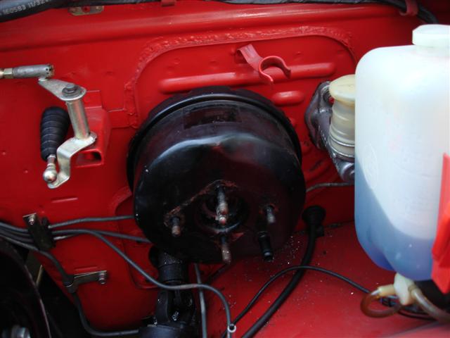

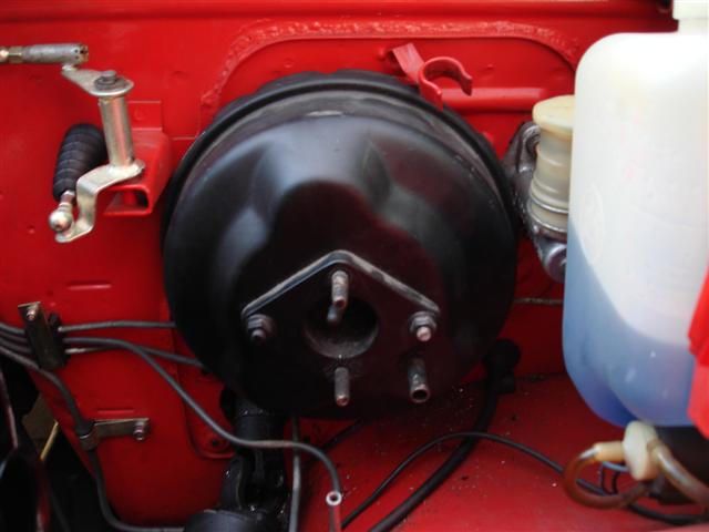

Here are some pics I grabbed off the net of a 280zx booster on a 240z. Some extra mounting holes seems to be all that is required.
Unfortunately I have not been able to edit my tech tips for years so I have not been able to add these great items that are on my hd. I'll keep the Classic Z site well stocked from now on :)
btw I have a feeling other boosters from other Japanese cars will work with minimal mods.
