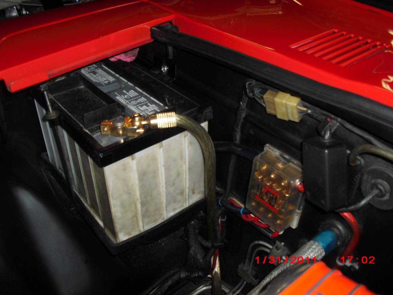

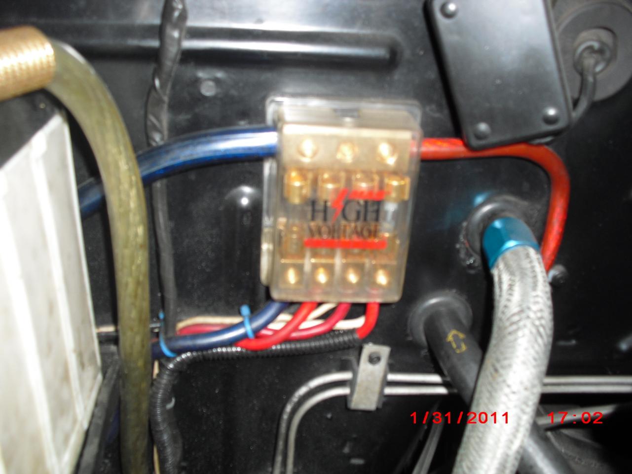

I personally like the 2 gauge Hi Strand power cable. Similar to Powderkeg's set-up. In my 70' 240Z, I have an 800 watt stereo, 55 watt lower driving/fog lights, 35 watt 6000K BiXenon HID's, Mallory Unilite Dist. MSD 6AL wit Promaster Coil, Dual fan set-up on the radiator, Honda wiper motor upgrade, Honda Blower motor upgrade and all the other lighting is LED.

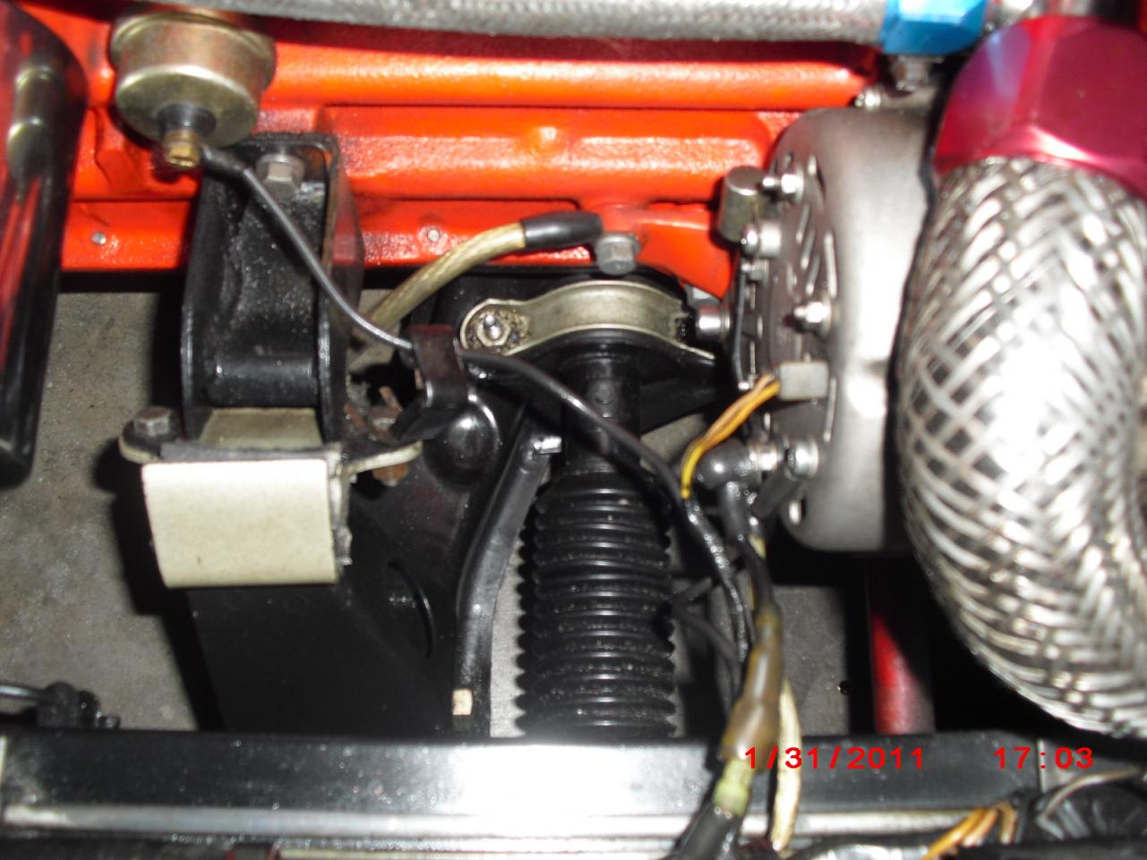

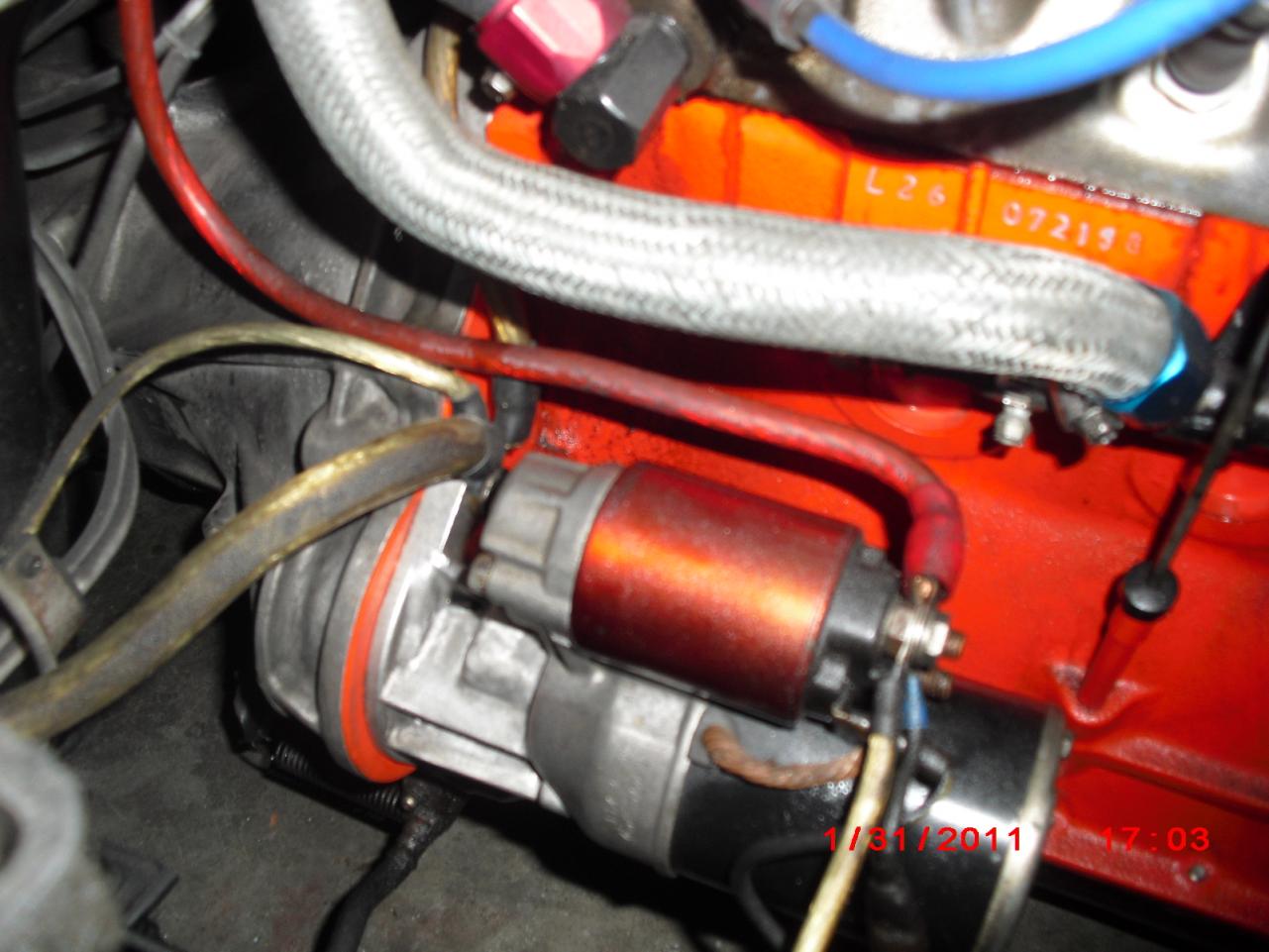

So with all that in mind, I have a 4 gang fused Distribution block on the firewall, gold plated allen screw battery clamps, 2 ga power and ground wire, 8 gauge ground from battery to firewall and from the ground bolt on the tranny to the ground terminal on the engine harness. There's a lot more but the pics tell the rest......

Nice looking job, so what is your preference, solder or crimp?
BOTH... The distribution block doesn't really allow for soldering but the allen screw clamps the hell out of it.
Anything that has a crimpable ring terminal gets crimped AND soldered. Then covered in a Silicone sleeve or Heavy Duty heat shrink.. Sometimes 2 layers.
I haven't had electrical issues for years. It's so overdone that you swear you can hear the car begging for me to add something else to it, just to see what it can handle. haha
Dave

New cables and GOOD GROUNDing connections to the block and the firewall. Clean the oxidation off the firewall seal with good dielectric grease. I got 12 from 6 volts at my starter and what feels like 30 horses back. It's a new car! The previous owner asked me why his ex-Z was running so good. I let him know i replaced the ignition switch, then the coil, then the starter wires, and finally found the battery wires and grounding to be the big time fix.
