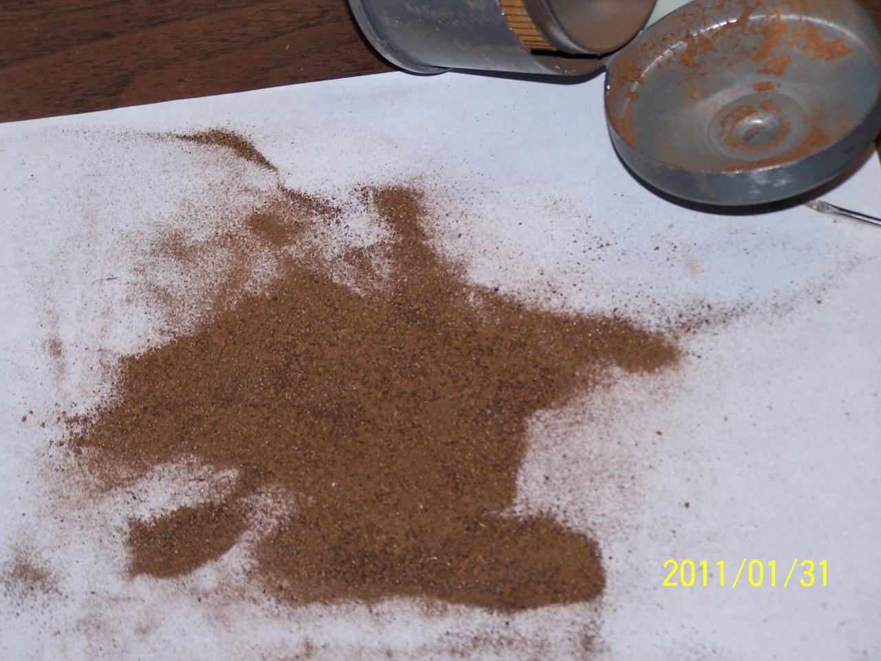

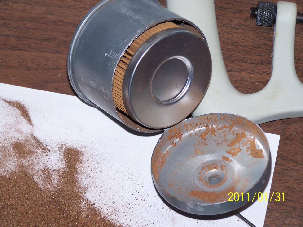

Well here is a picture of my fuel filter. I took it off the car in the summer of 2010, and just forgot about cutting it open. We have suspected there is a rust problem in the tank. Based on other facts we have been collecting about the car, we think it sat for a while. And probably with a half filled gas tank. And therefore the top of the gas tank is probably all rusty and corroded etc
I believe I only drove 200/300 or so miles on the one in the picture. But I cannot be sure because too many things have happened since the last year or so.
However, I have another fuel filter on the car now, which I am gonig to pull off to check it. I drove about 1000 miles this summer with the current fuel filter on it. So that one I will know for sure, it was around 1000 miles on it. And I always filled up the tank, figuring it would be collecting all kinds of nasty stuff in it, if the tank really is messed up.
I will cut it open too, after it dries out for a week or so. And see what comes out. If its the same as this, then that is probably not a good thing.
I cannot imagine that a fuel filter should have nearly this much material in it. If so, I would be surprised. But what do I know, Im a noob. Am counting on your help to tell me if this is shocking or normal.
Thanks! PS Sorry i posted this on another thread about fuel tanks, and figured this was better to post it here instead.
Edited by argniest
This is "normal" in the sense that tons of Z's have this problem. I would definitely consider dropping the tank and sending it to a radiator shop for some acid treatment/resealing. $300-400 goes a long way, or at least it is better than replacing a motor. Not only does this crap get into your engine, but it also gives the gas a weird looking color that could be harmful to your engine. Luckily it looks like the fuel filter you had on the car was the rear filter, meaning you have a 72 and above (?). Did you get a chance to look at the fuel filter in the front? Also you can pull the bolt on both float chambers of your carburetors (assuming you have SUs) and check the screen filter that is circulates the tip of the bolt. Check those screen filters to make sure they are clean.

Well, now I am really kicking myself for not opening that thing up before. But hey I am not a car wisperer. I am just doing my best to get things taken care of in the order that seems to make sense. It does seem like a lot of material in there!!!!! And the bad thing is that once I hacked the top off, I kind of tapped the filter on the paper again, and like 25% more stuff came out. And it was a lot finer material.
I think there is another cavity inside of it, that leads to the nipple on the top of it? I havent poked that part open yet. But since I dont know exactly how this kind of a fuel filter works, I am not sure what else there is to see.
What I am saying is that, OK, the filter material trapped a LOT of particles, but then I was thinking somehow that there is another mechanism in this filter where the fuel flows too like via pressure, it gets squeezed into the output side?

WoW! Are you sure some kid didn't dump a pail full of beach sand into the tank. I'm with spitz17, pull the tank befor causing untold damage to the engine.
Well its not sand. It feels very powdery, and not a hard material as far as I can tell and some of it is very fine small particles like finer than flour in a kitchen.

I looked at your profile so I know what car model we are dealing with a 78 280Z. Please check the front filter for rust if your filter is red, that is not good. Let me give you some good news fuel injectors will allow very little rust into the engine, you can now guess the bad news. If the filter is red you will more than likely need to do a serious cleaning of the ejectors. Drop the tank and flush the steel fuel lines with some rust cleaner, and don't forget the return lines. Some radiator shops can boil the tank last time I did this it cost me $40 and no tank for 4 days, about 7 years a go. Well worth it. MY first Z came with a rusty take.
After you get the rust out of the tank you have several options to keep it from happening again. The best advise only store or let the car sit with a full tank of gas, you need oxygen to oxidize. You can seal the tank but I've seen and heard of the sealers pealing flaking, even disintegrating and plugging things up. The best treatment I like is the use of 1qrt of non-detergent oil (or marvels mistory oil, actualy any oil with no cleaners will do, I even think the lucas fuel injector cleaner works, its oily) every oil change in a half full gas tank, take a drive (only need 3-4 miles) and make some hard turns to slosh it around, then fill the tank, it works. The car I have now the last two owners have done that its whole life 40 years and no rust in the tank. The only downfall is you get a little blue smoke for one tank of gas.
Yeah, argneist, that's a LOT of rust! You've just now replaced your injectors and don't have any significant run-time on them, so I doubt you've done them any harm (yet). IMO, there's no reason to pull your injectors and fuel rail. Just drop the tank, clean it out, seal it, change your filter, and you should be good.
