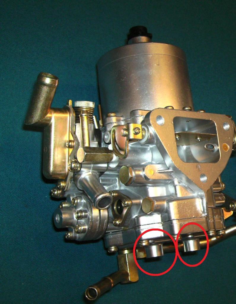

Hi again, so I tried to take a more in depth look and I think I pinpointed the smoke problem. It seems like oil from the rear carb, the one closest to the windshield, is leaking oil onto the exhaust. I attached a picture of a flattop carb (not my carb) with circles around where I felt the oil. Any idea how to fix this?
Clean the engine. I'm no flat-top expert, but I'm thinking what you think is oil is either: a) oil, but engine oil migrating through the grime or: B) gasoline going through the grime and becoming oily.
I guess it could be carb oil, but I have a hard time imagining how such a shattered carb could even function.
