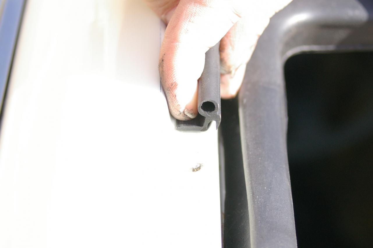

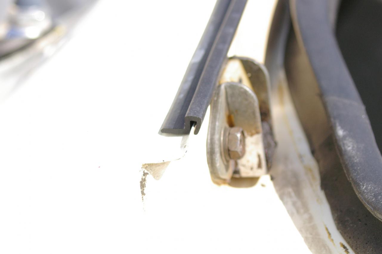

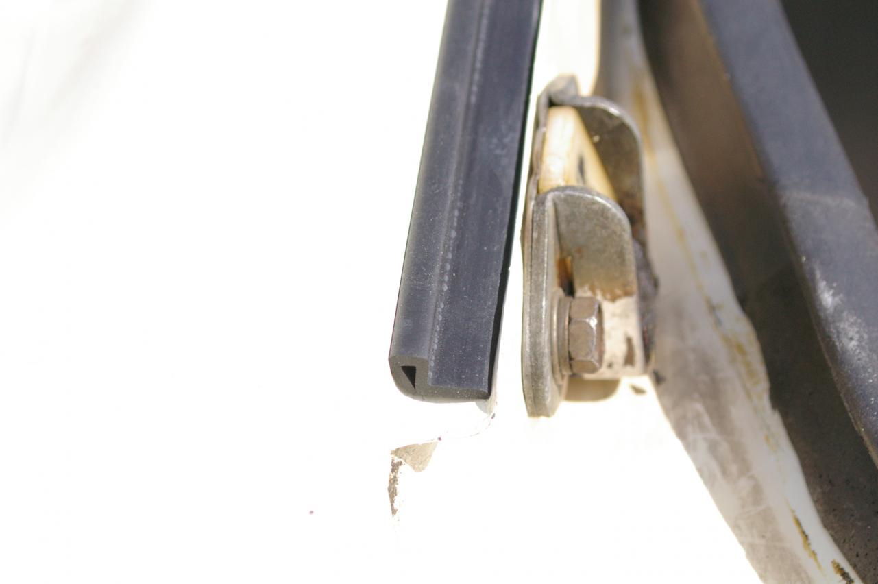

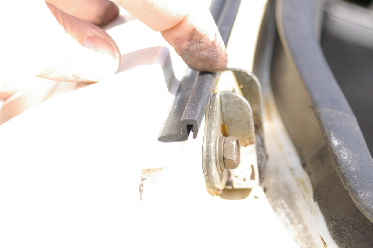

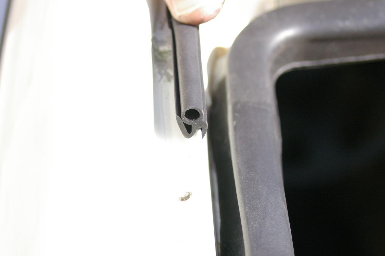

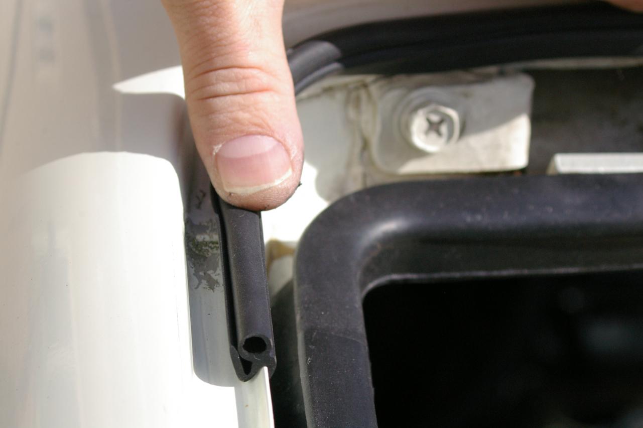

I applied the main rear hatch seal today. I am also trying to apply the outer rear hatch seal that comes in three pieces from Black Dragon. There was not any on the car in which to reference...so not sure how it lays on there.

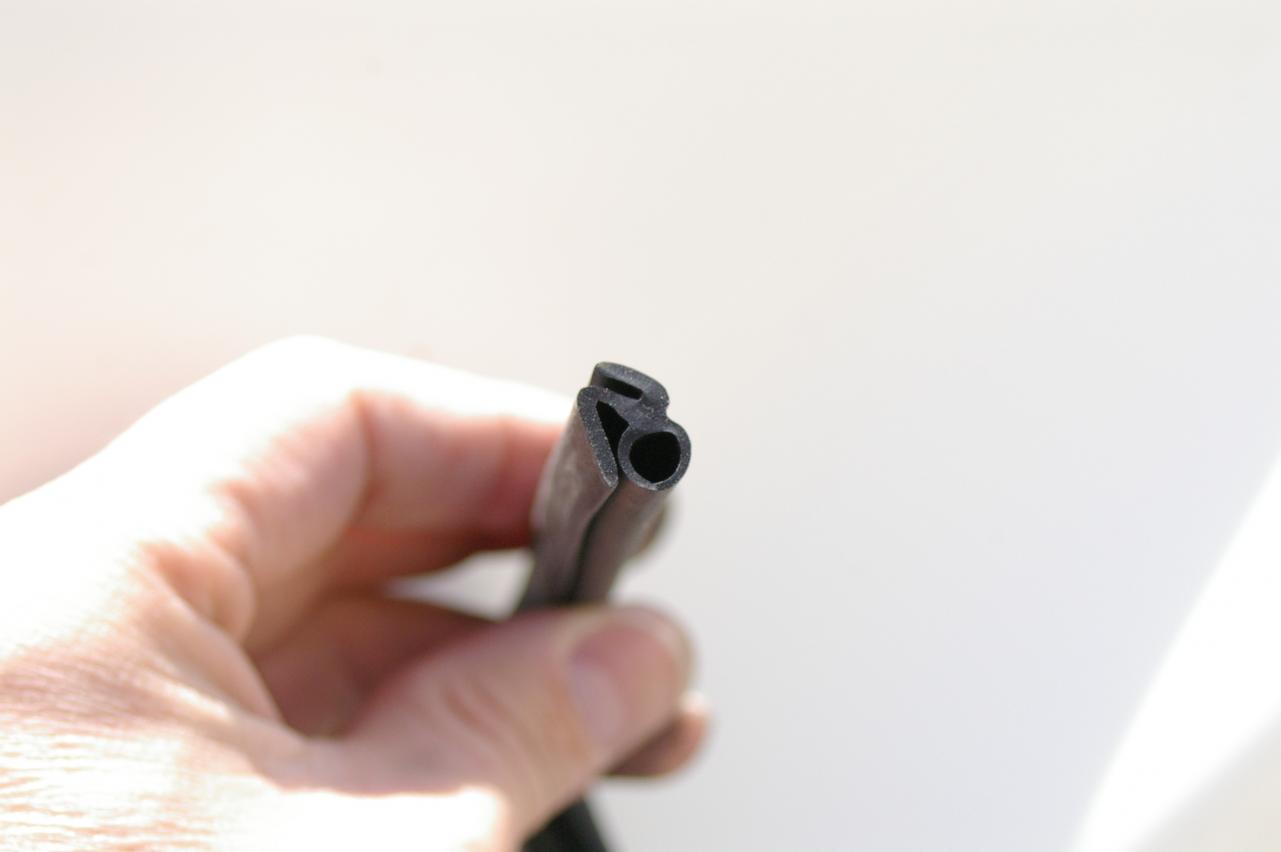

The two sides are alike in profile, while the top is a different profile.
Any ideas on how they should lay inside or ontop of the channel? I through in some pics on possibilities. I just don't want to get it wrong...taking it off after gluing it on would be a pain.
HELP!! :)

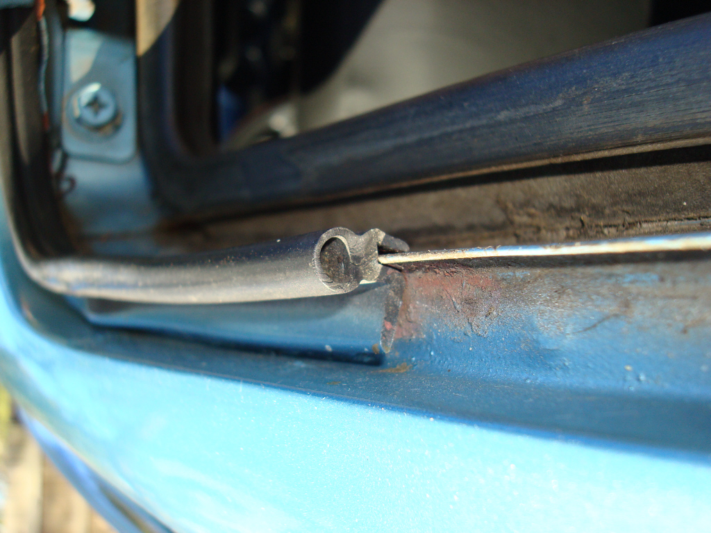

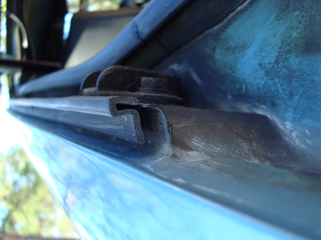

I still have the original weatherstrip and the flat part is not glued. According to Wick Humble "How to restore your z-car" he says to apply weatherstrip cement to the jamb lip and press the rubber strip into it carefully.
