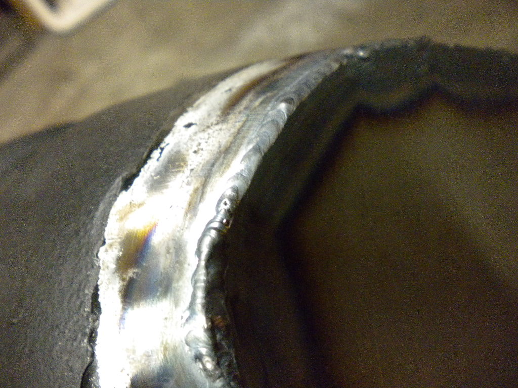

When my local metal guy welded my custom tank, He mentioned something about filling the tank with an "Inert Gas". Something about it also helping suck the weld inside as well. I tried to upload the shots, which are all the same size etc, etc, but it will only let me upload 1 pic?? I'll try and show the inner shot later on, after I restart my computer.
Can't upload the close-up pic but this inside shot shows how the weld was sucked in by the inert gas. So it looks like he welded the inside as well.

Hi Dave:
Great pictures and very nice welding on thin metal. Your local metal guy would seem to know what he is doing.

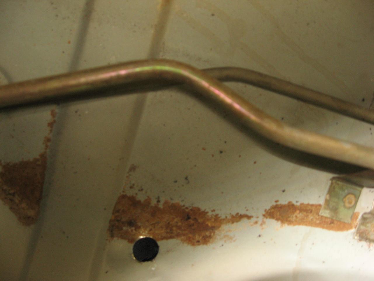

Thanks for the tip Dave, I was actually going to ask you about that tank. I saw pictures of you're modified tank awhile ago. The tank looks really clean on the inside, that's why I bought it so I think needs no cleaning. It is "bone" dry right now, I have put my nose to it and I smell no gas at all. It will sit in my basement for some time before I start any work on it as there is other work to do for the time being. The hole is about 1 inch in dia. so if I decide to weld it I wonder if I could just use the same mig gas I use with my wire feed (Metal Inert Gas) to fill the tank.
here is a shot of the tank (not easy to photograph the inside sorry).
This is the drilled out hole and a little rust, this is the only rust in the tank I believe is is caused by water entering through said hole.
that's not too bad at all. Hell, you could rubber plug that hole, in a pinch. OR... Square off the hole, weld in a filler plate, spray or brush on a protectant from the inside (you'll likely have to use a stick or extension to reach the hole repair on the inside) then POR15 the outside? just a thought.
