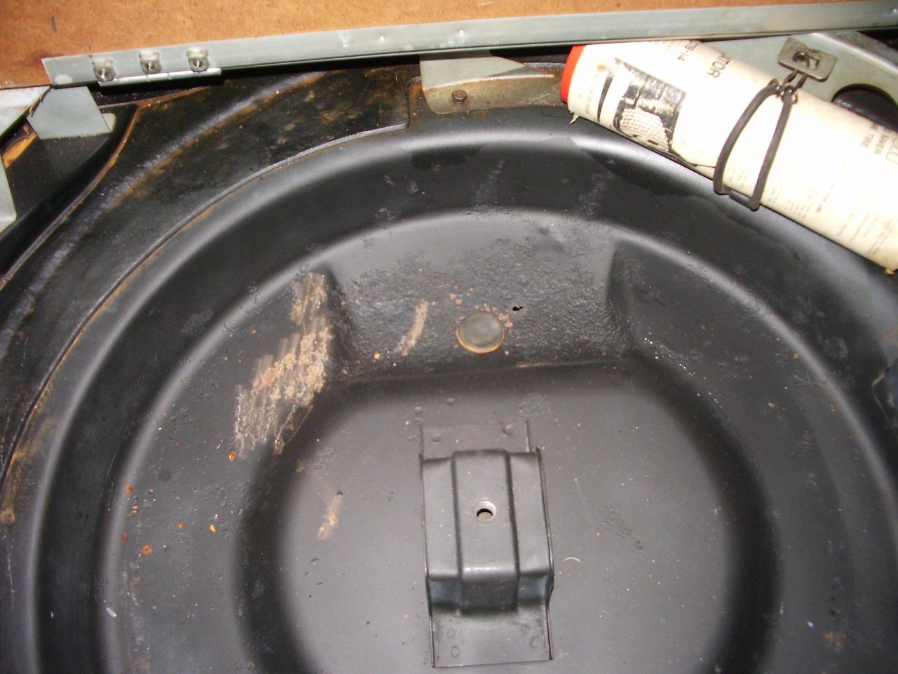

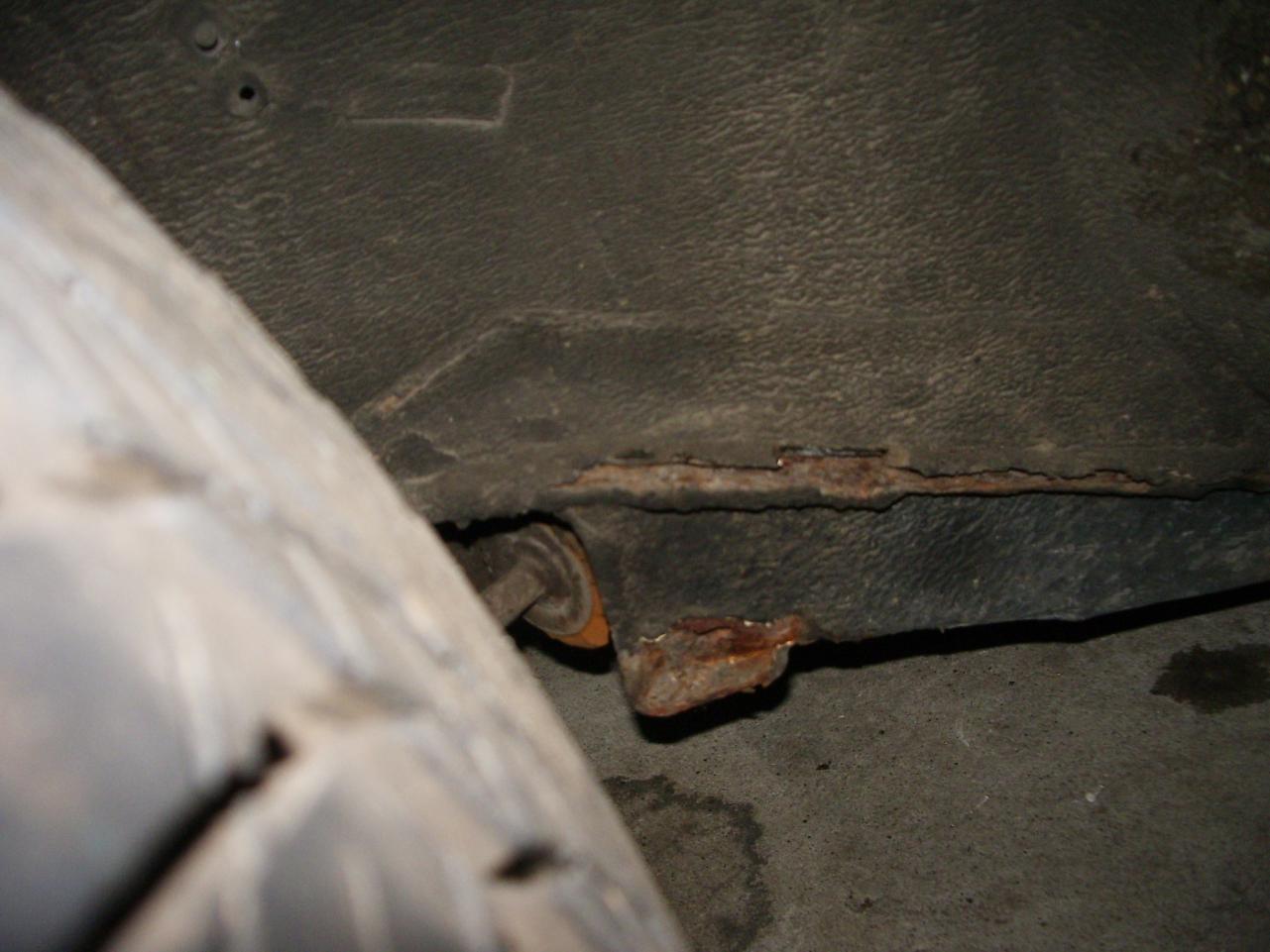

February 20, 201114 yr comment_346621 Outer doesn't look too bad but keep in mind these car rot from the inside-out. Frame rails are a big one to lookout for(look at it from inside the front wheel wells and under the car). Check out the rear tire well too. Pics related. Link to comment https://www.classiczcars.com/forums/topic/38632-first-time-buying-a-z-car-what-to-look-out-for/?&page=2#findComment-346621 Share on other sites More sharing options...
