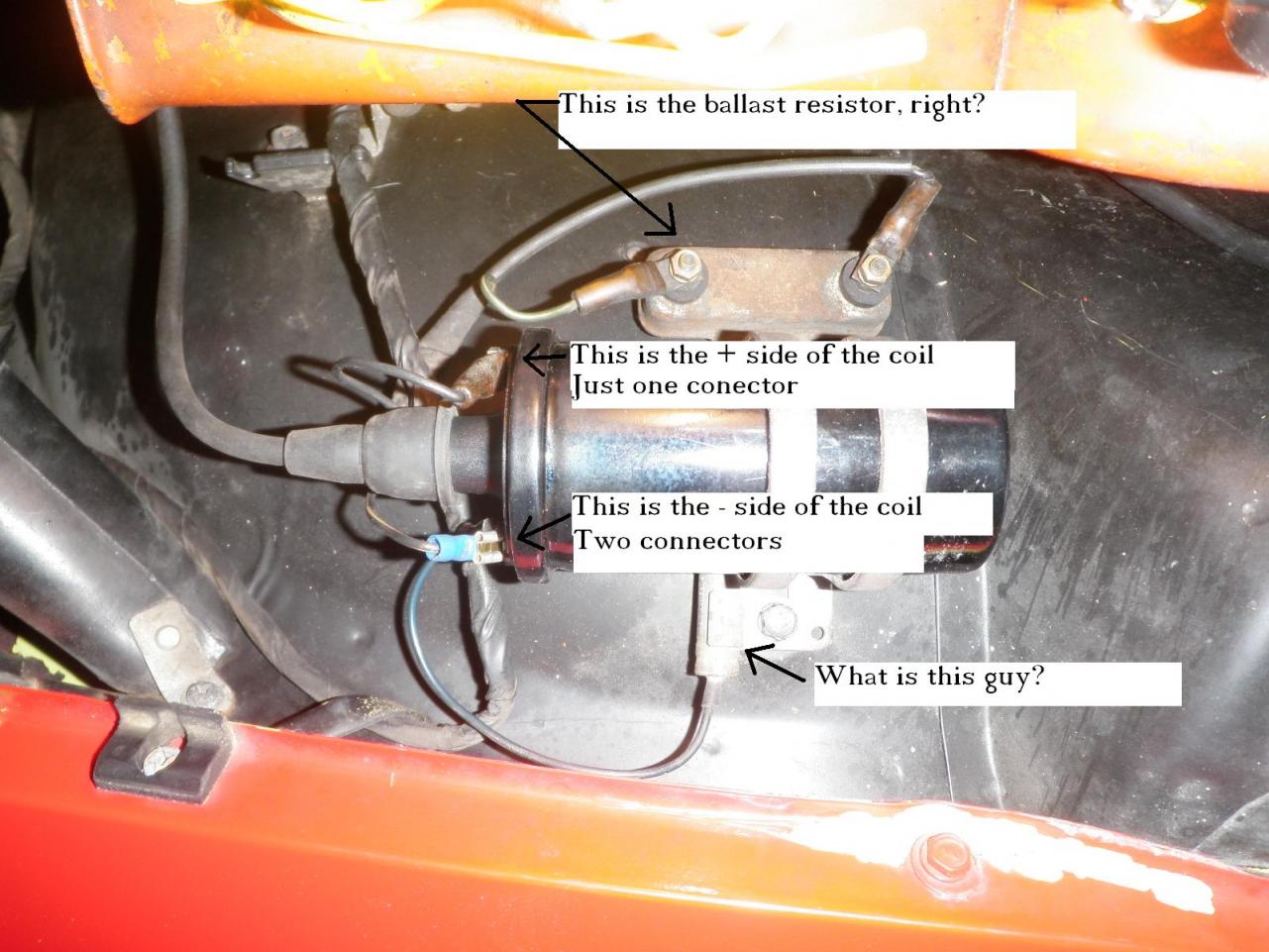

I attached a picture of my too-small-for-the-bracket coil...

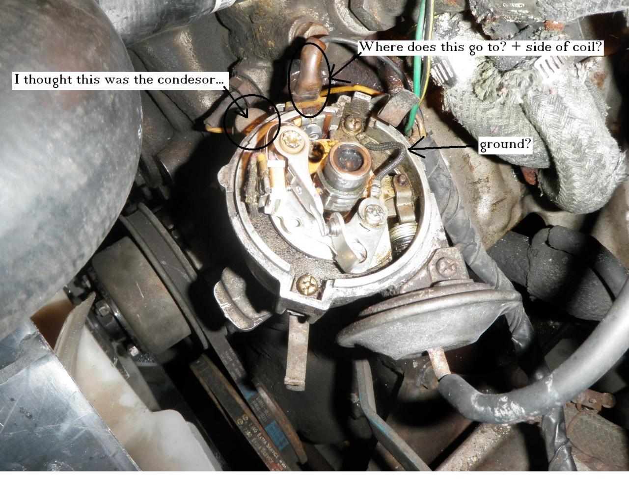

Also, please let us know whether or not you have stock points or if someone installed a different ignition system (Pertronix, Crane, MSD, HEI, etc.). If you're not sure, take off the distributor cap and rotor, take a picture of the distributor, and post it.
Also, make sure the condensor is on the negative side of the coil. It looks like it's on the positive side in your picture. By the way, the condensor and ballast resistor look VERY old. Consider replacing them.
It would help, too, if you would tell us if the car is an automatic or manual. The automatic had a dual point distributor.

I took a picture of the dist. I made some notes on the pictures, I'd appreciate it if you could take a look.
If you are getting 12 volts at the -side of the coil your points are closed, coil fires when current stops flowing. Take a small screwdriver and open the points, I bet you get a spark, in that case try resetting your point gap. Also the rubbing block on the point set needs to be lubed with point grease, if you don't your point dwell will continue to deteriorate till the car stops again.
