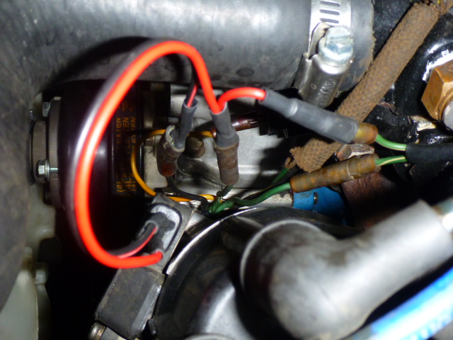

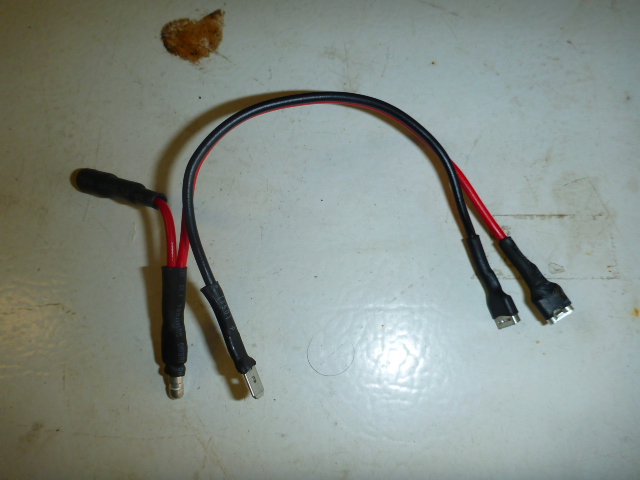

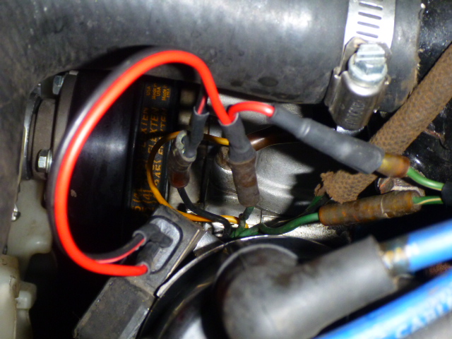

First step: Stop what you are doing!
Second step: Install an E12-80 electronic ignition!
I just did the swap with my '73 and it works awsomely!!!
It is a direct bolt on and only requires a small jumper to utilize the stock wiring.
You can find distributors used or new at rock auto and you can select the total advance depending on what year of 280ZX you choose. I am running an '81 w/ 55 degrees advance. It is 8 more than stock but I have a big cam an fully functioning EGR.
Instructions for a later car but has all the important info.
http://atlanticz.ca/zclub/techtips/distributor/index.html
