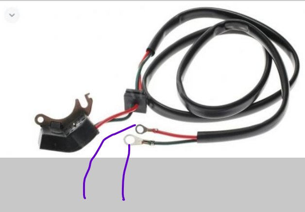

also - could it be a bad pickup?? anyway to check the  pickup?? does gap need to be correct for spark?
also - is 280z pickup same as 260z pickup?
will the photo of the 280 pick up work in 260?
