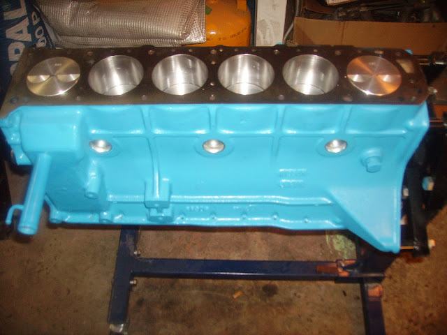

And they should have, are you sure the block haven't been decked?, i have a -73 block with aftermarked pistons, didn't even think about measuring the deck hight, but i have no problems, running a E88 head.

Chris.....No the block wasn't decked. I don't think a lot of people would even notice .030. It looks like you have the same .030 out that I'm talking about (just by sight). I've talked to people that say it's no problem with 73 pistons and E88 or E31 heads. I've also talked to people including Dave Rebello who say you should have .060 clearance. You certainly don't have .060 clearance if you come out .030 and the gasket is .060 inches, but I don't see why .030 isn't enough, and many are running this set up including you with success. Anyone else out there running the 73 pistons(valve reliefs) with the early E88 or E31 heads?

Chris.....That's the head the pistons were designed for.....You've got no problem.If you look at your block pictures,you can clearly see the .030 edge I'm talking about sticking out of the block. My question is......is it OK to run these pistons without modification with the early E88 or E31 heads where the chambers are designed for the "0" deck clearance flat top pistons. If anyone has used the 73 flycut pistons with the early heads, I'd like to hear from you. If the pistons you installed had valve reliefs whether Nissan or aftermarket, they are 73 pistons.
