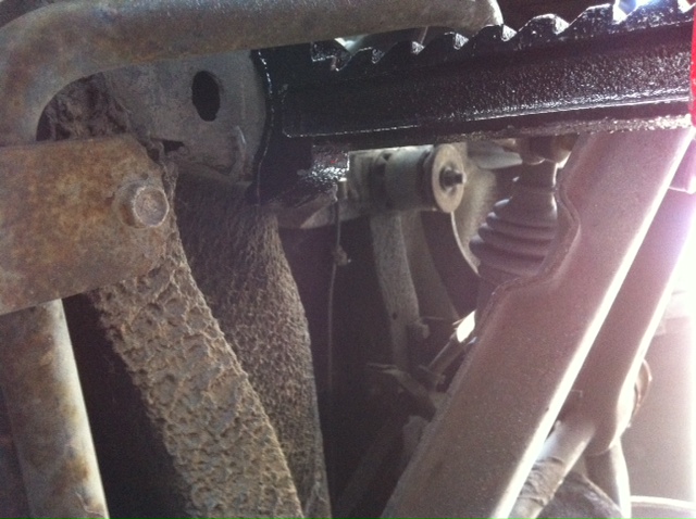

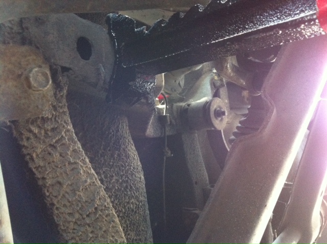

February 26, 201114 yr Author comment_347455 Ok I put the back on jack stands but I am not completely sure i put it in the right place. I looked at the FSM but the pics are a little hard to see. I took a couple pics and attached them. Also what do you mean by rotating the driveline? Ive heard this before but I never understood how? :stupid: Thanks for the help everyone PS. sorry for the crappy pics. Link to comment https://www.classiczcars.com/forums/topic/38711-1977-280z-unserviceable-u-joints/#findComment-347455 Share on other sites More sharing options...
February 27, 201114 yr comment_347463 After you initially get the bolt lose, hold the wrench stationary and rotate the driveline 1/8th turn or whatever it might be and then reposition the wrench. It is easier than trying to the wrench in that tight area. It is a preference thing I suppose. I think you'll catch on.I can't tell from your pics. When I use stands, I put them under the seat belt indentations on the floor. The key is a good solid location that is out of the way, won't do damage to the car, and SAFE. Link to comment https://www.classiczcars.com/forums/topic/38711-1977-280z-unserviceable-u-joints/#findComment-347463 Share on other sites More sharing options...
