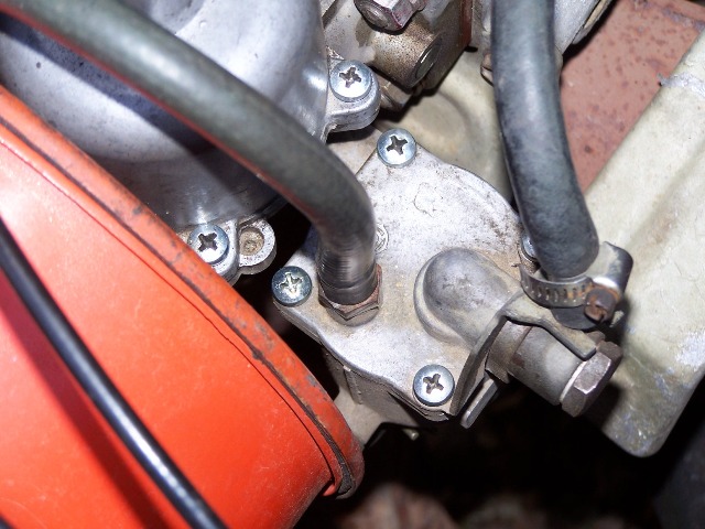

March 1, 201114 yr comment_347898 I had a similar problem with my 280Z with 72 SU Carburetors. My fuel line was clogged. And my Mechanical fuel pump was leaking. You said you don't think it's a clogged line... are you sure? Spray starting fluid into the bowls of the carburetors. I just pulled the hose from the top of the carb bowl and sprayed starting fluid through the inlet in both of the carbs. (See photo) The car started and ran for about a minute. I then blew out the hard lines from the tank to the fuel pump and carburetors. The car started on it's own and ran fine until I noticed the fuel pump leaking. Ordered a new one from AutopartsWarehouse.com for $19.95. The car runs fine (Except for two bad plugs wires..on order). Sounds like you may have to check your fuel tank for debris. A recoating of the tank may be in order. Also do you have a factory service manual? They are easily downloaded from this site. Good luck. Dave Ruiz Link to comment https://www.classiczcars.com/forums/topic/38747-no-fuel-coming-into-filter/#findComment-347898 Share on other sites More sharing options...
