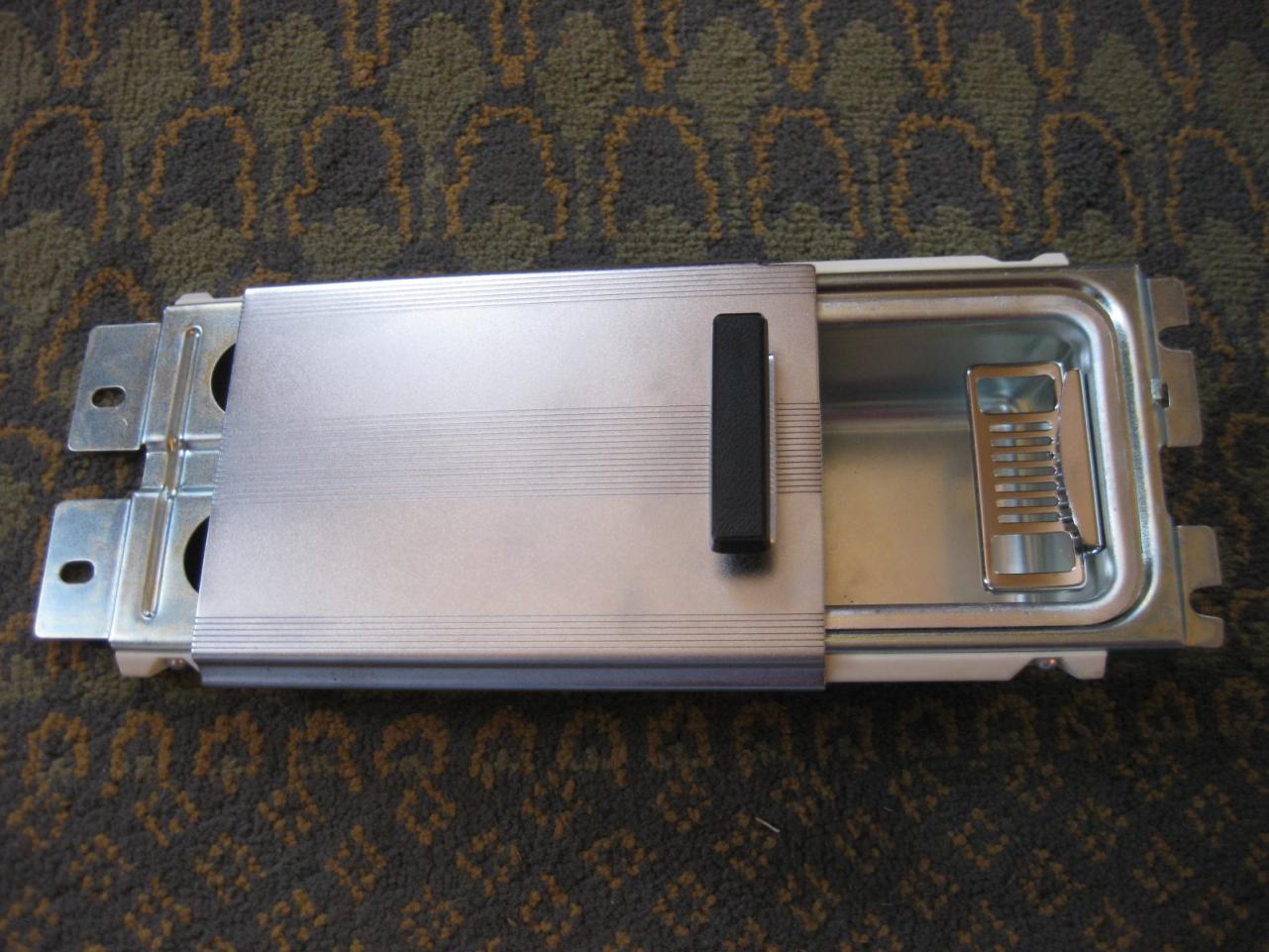

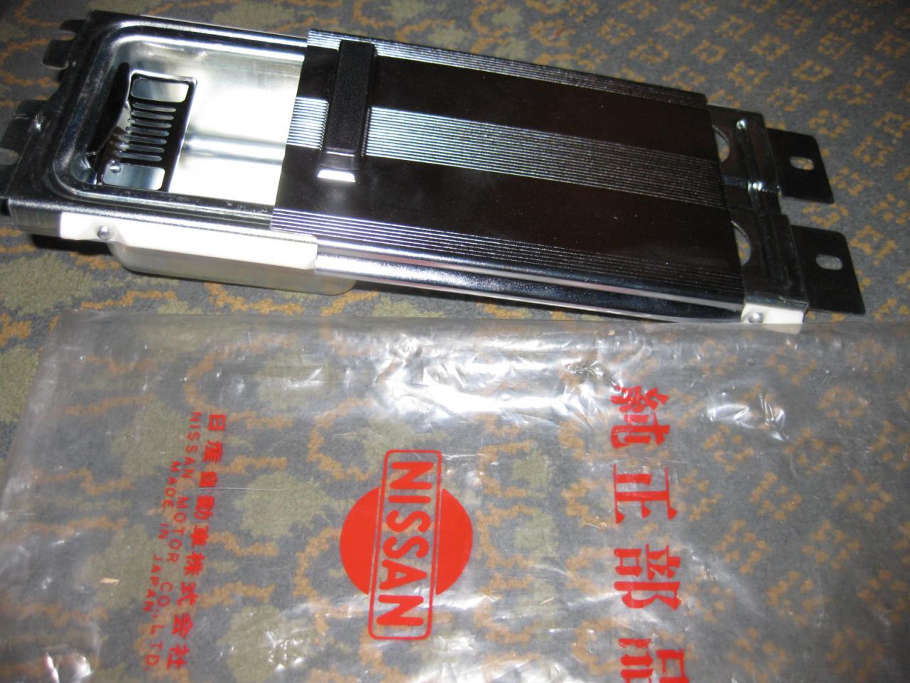

Posted March 5, 201114 yr comment_348304 All-- I was recently fortunate enough to purchase a NOS ashtray assembly for my Series 2 (73) 240Z. In the past we've had discussions about the surface finish of the sliding lid and how difficult it is to restore that when it has been damaged. Does anyone have a suggestion as to how to treat the surface so as to prevent it from oxidizing/tarnishing/staining/marring?? :bulb: I don't intend to use it for it's purpose, but do intend to install it in the car. Any ideas or thoughts are welcome!!! Jim D. "Zup" Link to comment https://www.classiczcars.com/forums/topic/38797-protective-treatment-for-nos-ashtray-assembly/ Share on other sites More sharing options...

March 5, 201114 yr comment_348324 Does anyone have a suggestion as to how to treat the surface so as to prevent it from oxidizing/tarnishing/staining/marring?? :bulb:I don't intend to use it for it's purpose, but do intend to install it in the car. Jim, My only suggestion to keep it perfect is don't use or open it . Seriously, though, I don't think there is any kind of coating that you could put on it that would still look original and provide any kind of protection. I also have a NOS ashtray like that, but my original is in good shape, so I'm just keeping it in the box for now. -Mike Link to comment https://www.classiczcars.com/forums/topic/38797-protective-treatment-for-nos-ashtray-assembly/#findComment-348324 Share on other sites More sharing options...

March 6, 201114 yr comment_348406 After going through great pains to have several lids faithfully re-plated, I found a new one too, being that I have several NOS consoles, but never expected to have a NOS cover,here is what I did:1) Maas Metal protector applied to all exposed metal2) Test fitted a used cover to a NOS console, to check for interference.3) Shaved the console where interference was found by gluing 320 grit sand paper to the used lid and taking it through its motions. You can't see where the sanding was done with the lid installed-much less with the console installed.This accomplished two things1) The metal is sealed and protected-with something that will not hurt plastic.2) No chance of wear to the lid surface:added clearance between the console and the lid so even sand on the lid would not scratch. Link to comment https://www.classiczcars.com/forums/topic/38797-protective-treatment-for-nos-ashtray-assembly/#findComment-348406 Share on other sites More sharing options...
March 6, 201114 yr Author comment_348420 You guys are great! AJ--I agree. Patina is a natural process--- the result of time, exposure and use. I just want to contol it somewhat! I DO love the cars!! The question is whether to use Gibb's or Maas, as Will suggests above. The lube on the plastic slides is not a problem. Will----What a carefully thought through plan! Brilliant! :bulb: I do have an old assembly that I can use to do as you describe. You have identified exacty the problem I have witnessed on other assemblies----chafing of the cover against the plastic console resulting in marring of the metal finish. :tapemouth Thanks to you all! Jim D. "Zup" Link to comment https://www.classiczcars.com/forums/topic/38797-protective-treatment-for-nos-ashtray-assembly/#findComment-348420 Share on other sites More sharing options...
