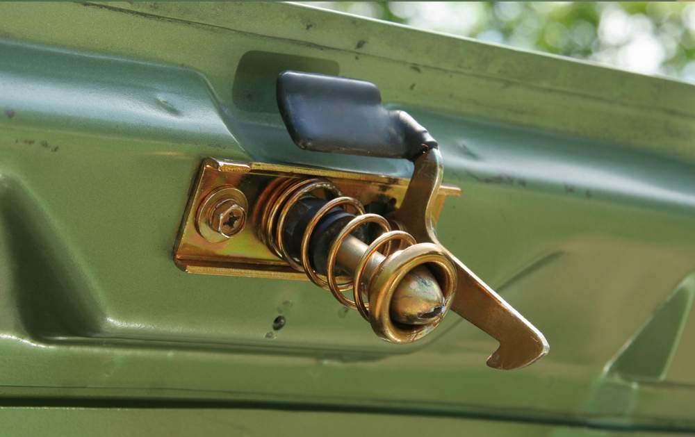

Hi All. I notice that the hood on my 76 Z does NOT close without having to pull back the hood latch on the hood. I have tried loosening the bolts that hold the hood to the hinge..and pushing the hood toward the cabin. Does not seem to help. In fact, it starts changing the fit and finish of the hood to the fenders. I also tried adjusting the latch and keep...but remains off enough to still be a minor issue.
The pull release in the cabin seems to work fine. The hood pops up, then I pull on the latch to release the hood. Just coming back down...it hits the point of the latch on the latch-keep.
This appears to be the original hood to the car...and it has not been in any accidents. Perhaps I can just grind the latch angle down some.
Has anyone had this issue and tried to fix? I know my 78 Z dropped all the way down and closed without having to pull back the latch.

Thanks EScanlon. The Saftey catch latch (fixed to the hood) is hitting the catch on the fire wall. The latch, as you know, is angled so that as it closed on the catch, it pushes back until the hood closes to the 1-1/2 in mark, or so.
However, in my case, it seems that the latch is too forward, making the "point" of the latch hit the catch. Isn't that confusint to say. I'll try to get some picks tomorrow.
The pin is going in fine, and the hood releases fine. Simply put, I cannot simply slam the hood shut from an open position. I must pull the latch back so that it does not hit the catch...then I push the hood completely closed.

I tried adjusting the catch on the firewall...but it would not move out far enough. I have included pics that help show the problem.
Pic "As-Is" shows how the latch is hitting the catch.
Pic "S/B" shows where I think it should be if....without me having to pull on it.
Again, this pin hits perfectly.
Meant to add: It does not appear to be installed at an angle. I did take both pieces off (hood and body) just to clean. reinstalled, but same issue. I moved the latch as far toward the cab as I could, and the catch as far toward the nose as I could. What you see in the pic is each at its furtherst point.
Leads me to wonder if I should adjust the hood hinges that attach to the body.
Thoughts?
