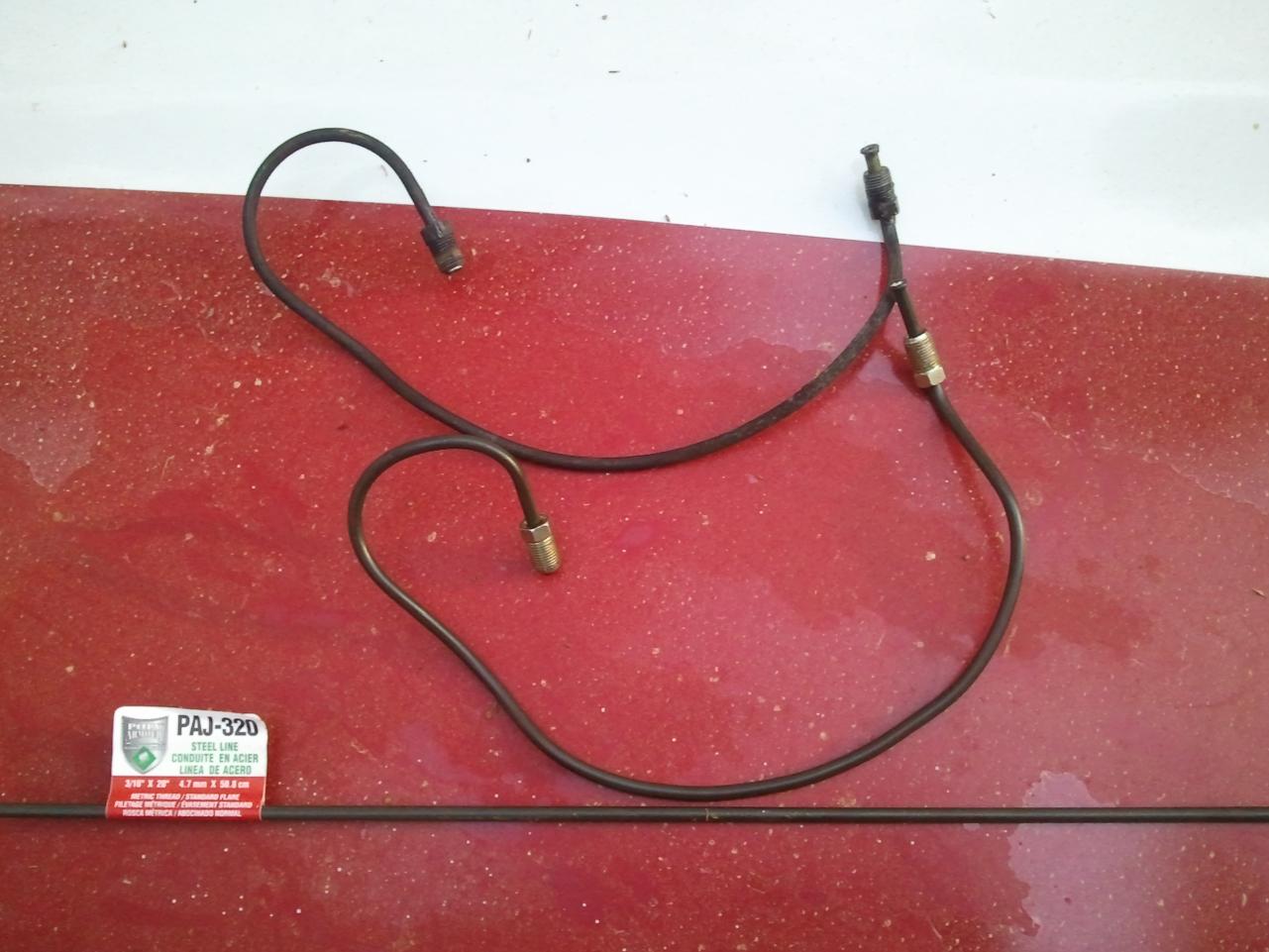

March 24, 201114 yr Author comment_350589 Well brakes are disassembled. Ready for cleaning and painting then reassembly. Think I'll make new hard lines at the wheels. The little ones are chewed up the worst. But they're so small I should be able to make my own well enough. 3 of the 4 brake hoses were cracked through rubber sheilding and braiding underneathe one was cut and clearly had been ballooning. The new braided steel hoses look great. Missing those "C" clips that hold the hoses in place on the front lines. Already replaced points, rotor cap, disto cap, NGK wires and NGK plugs. I had cleaned the old stuff so it would run but I doubt I was getting a really good spark. Should be much better now. Waiting for Unisyn and Just SU's dvd to complete the tune up. All goes well by Saturday or Sunday I will have a fairly good little driver Z. Wish me luck. Link to comment https://www.classiczcars.com/forums/topic/38867-3-years-of-sitting-what-to-do-first/?&page=4#findComment-350589 Share on other sites More sharing options...

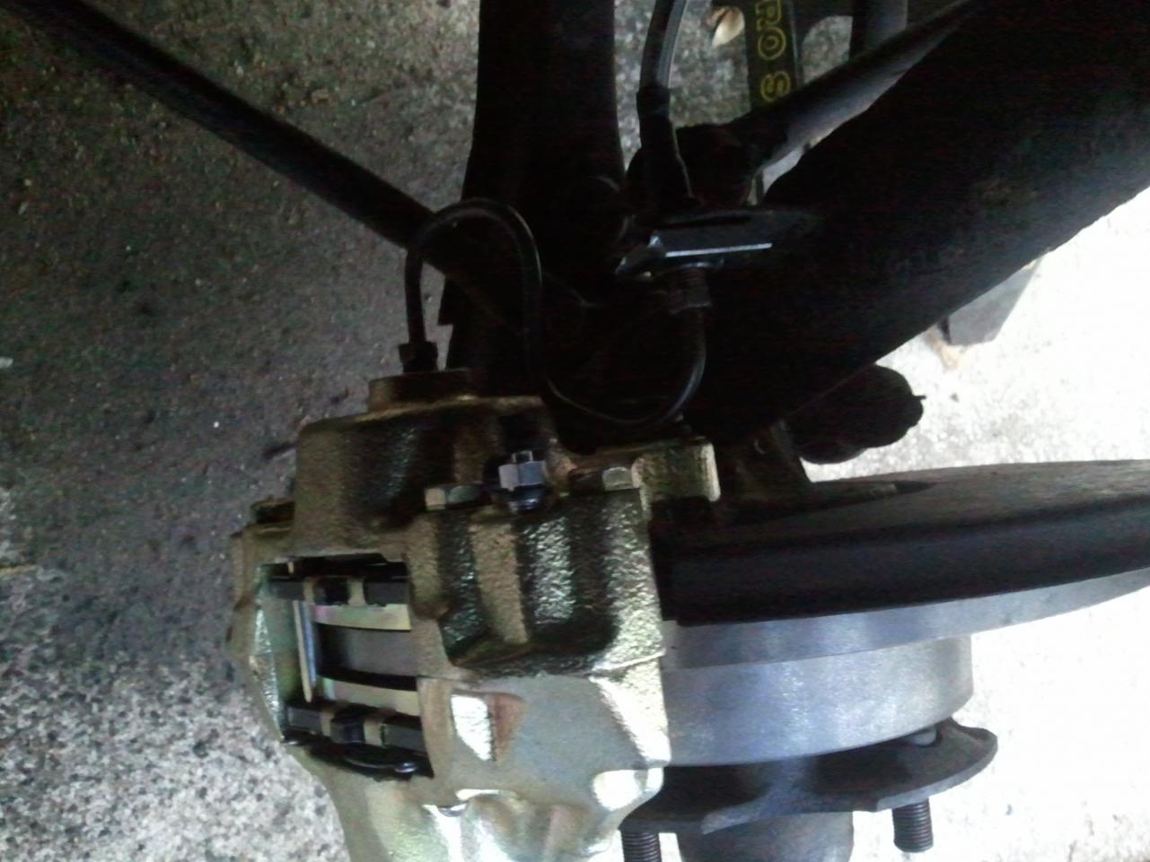

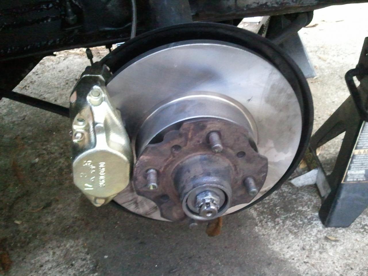

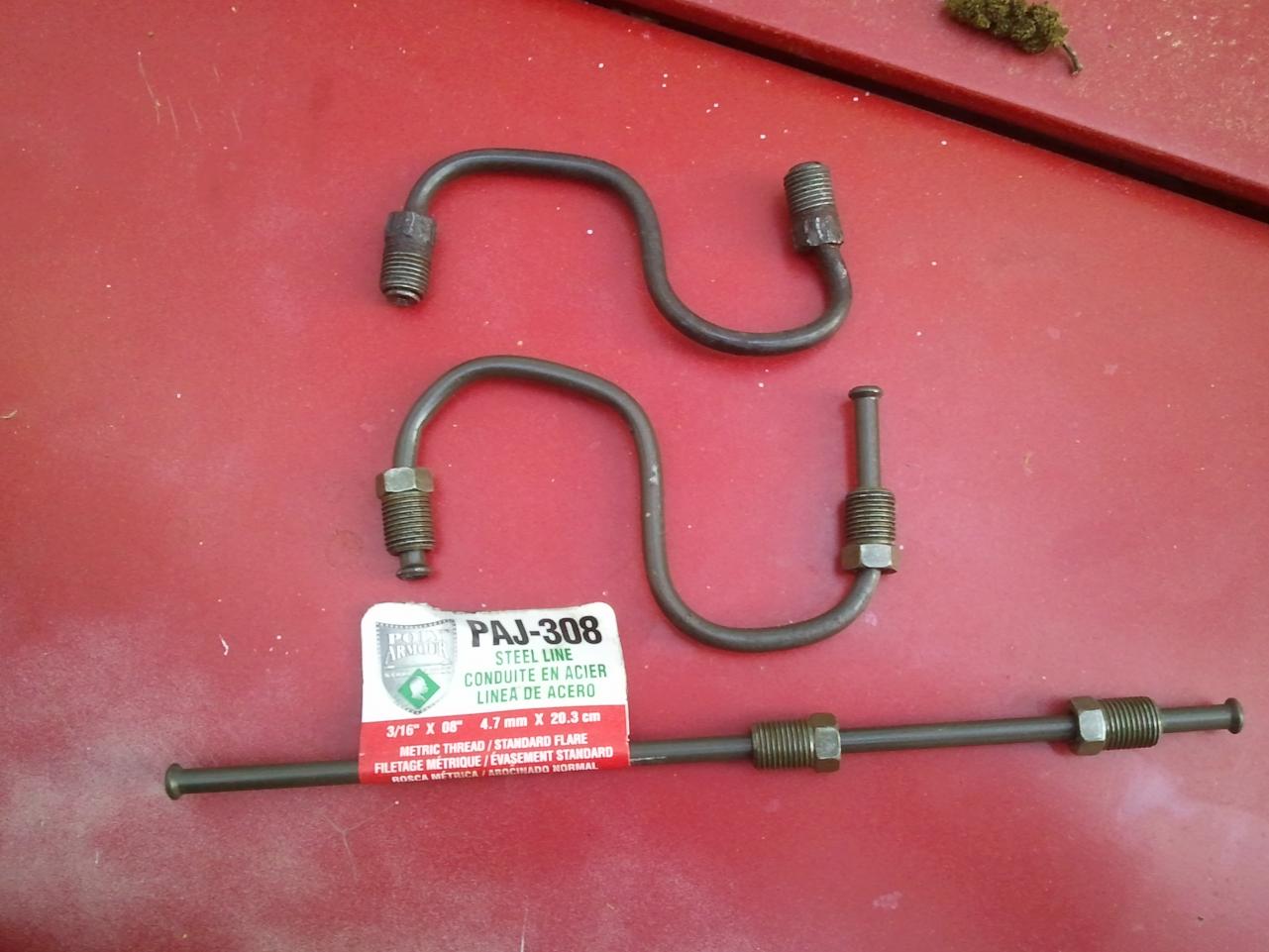

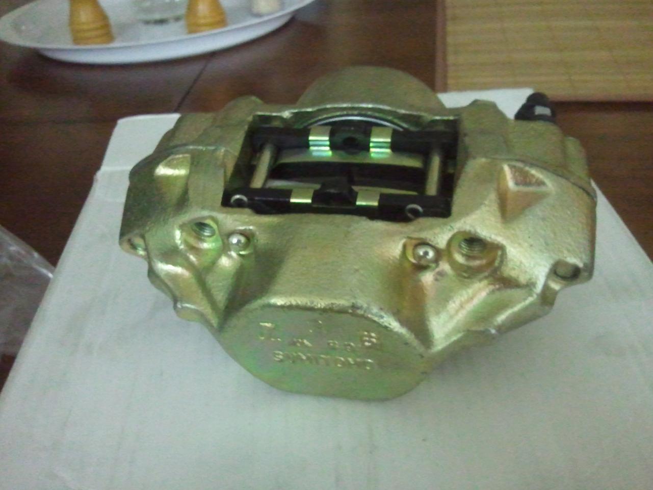

March 25, 201114 yr Author comment_350749 Not going as fast as I'd hoped. One of the old rotors did not wanna let go of its hub. But a chunk of wood, 2 jackstands and a 10lb sledge convinced it otherwise. The second saw what I did to the first and practically fell apart once the bolts were out. I like the new Centric posi-quiet calipers. They pretty. Coming loaded they simply dropped right in. Easiest calipers and pads I've ever installed. Made some new hardlines for the wheel. Could not get the exact length needed in a premade line but got close. Installed my new lines in the front. The look pretty good. Got the feeling the rear drums are gonna kick my butt. Those wheel cylinders look complicated. Seriously? Floating wheel cylinder held in place with opposing c clips? Bleh. And that emergency brake / self adjuster mechanism intergrated in the wheel cylinder. Shoot me now. It's gonna suck. Oh btw, there's alot of rain predicted for this weekend. I'm working outside on a concrete slab. I had to turn up the speed and ignore my plans to clean, polish and paint while I have pieces apart. So the front hub got a quick clean but not much else. I did take the time to clean the backing plates and dust shield and do a quick repaint with some high temp black paint. Hopefully slow the rust somewhat. Here's a few pics. Edited March 25, 201114 yr by EverRude Link to comment https://www.classiczcars.com/forums/topic/38867-3-years-of-sitting-what-to-do-first/?&page=4#findComment-350749 Share on other sites More sharing options...
