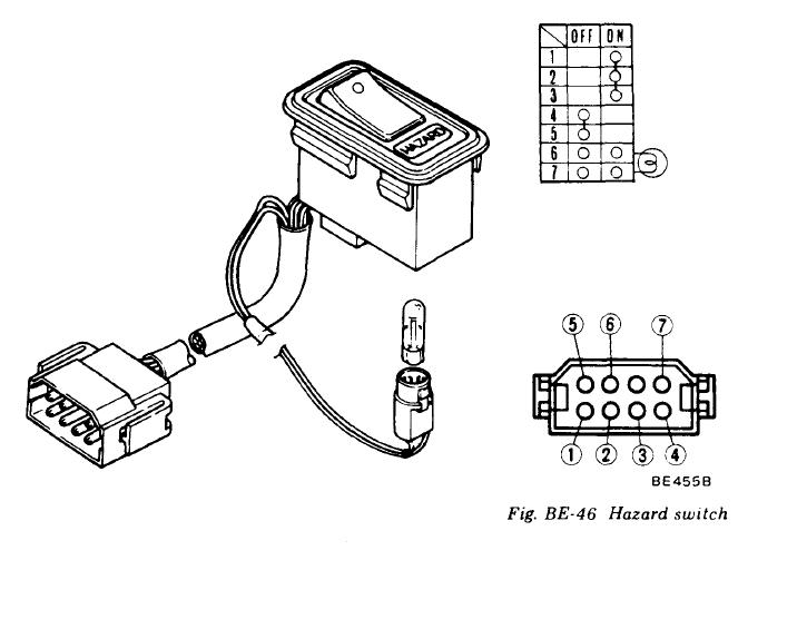

My 78 didn't have the light for the Hazard switch, and I couldn't even find any evidence that there ever was one.I was considering putting one in, as the hazard switch is a fairly important item, IMO. I would just need a lamp socket and the metal holder. Can You getthose little metal plates, or should I have to make one? No spares in the spares box.
Are you talking about the hazard swithc or the light itself. I was having issues with the light not turnig on. It should have a seat belt light and a hazard light that lights up when you turn the car light on, and not when you turn the hazards on. If you follow the seat belt light you should be able to find the hazard light. Good luck
I was referring to the lamp inside the hazard switch. There wasn't any consistency between the few wiring diagrams I have. One shows the lamp wired to the hazard switch connector, and another one has no lamp. The FSM shows the lamp wired to the connector. See the attachment.
