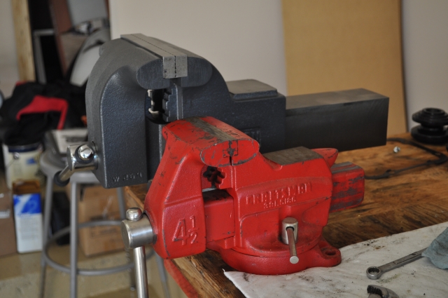

So after struggling with the installation of the first set of new rubber control arm bushings, I took the advice of the 5TH Horseman and purchased a new bench vise from Northern Tool that was a significant upgrade from my last one.
All I can say is what a difference. They went in like a breeze.
I also used the appropriate sized sockets from my impact wrench which are much beefier and stronger.
This will give you a sense of the size differences of my old vise and my new one.
What a difference the right ools make.
