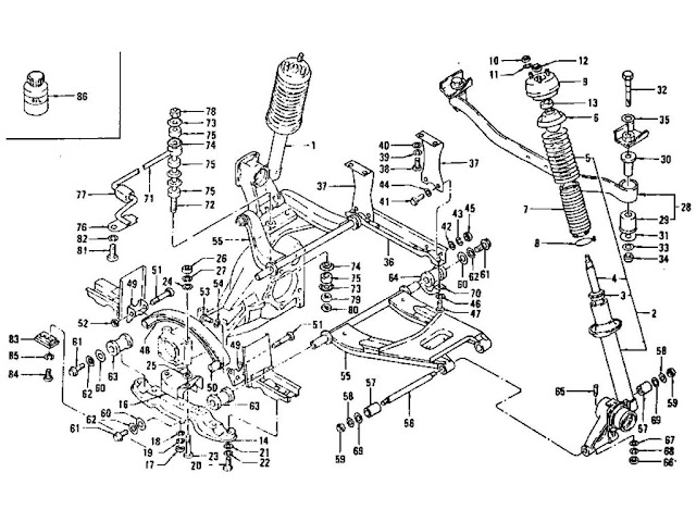

Posted March 17, 201114 yr comment_349582 Replacing my entire brake system. Notice some PO bent up the rear backing plates and presume using them to pry off stuck drums. Hopefully I can straighten them. What is a good sourse for replacements if not?Also since I am replacing my entire brake system and considering using silicone fluid. The inability to absorb water should make replacing metal parts less necessary in the future since they should not corrode as much. Am I wrong? Link to comment https://www.classiczcars.com/forums/topic/38920-rear-backing-plates-for-71z-brakes-and-silicone-fluid/ Share on other sites More sharing options...

March 17, 201114 yr Author comment_349618 Finally figured out for myself that the backing plates are part of strut tube. No choice but to try and fix then as best I can when I install brakes. Link to comment https://www.classiczcars.com/forums/topic/38920-rear-backing-plates-for-71z-brakes-and-silicone-fluid/#findComment-349618 Share on other sites More sharing options...
March 17, 201114 yr comment_349633 Finally figured out for myself that the backing plates are part of strut tube. No choice but to try and fix then as best I can when I install brakes. Incorrect, the plates bolt to the strut. Link to comment https://www.classiczcars.com/forums/topic/38920-rear-backing-plates-for-71z-brakes-and-silicone-fluid/#findComment-349633 Share on other sites More sharing options...
March 17, 201114 yr comment_349635 ...the plates bolt to the strut.True. But you have to split the flanges and replace the rear wheel bearings to replace them.If you do decide to replace the backing plates, I'd consider using the plates from a later S30, as rear wheel cylinders for the later cars ('72-78) are more affordable, and easier to come by. Link to comment https://www.classiczcars.com/forums/topic/38920-rear-backing-plates-for-71z-brakes-and-silicone-fluid/#findComment-349635 Share on other sites More sharing options...
March 17, 201114 yr Author comment_349636 Gah wish I had asked this before. Just bought a set of those incredibly expensive series 1 wheel cylinders. At this point it seems I am committed to this. Repair should be doable though it may require some heat. Bending tin is what I am best at so I'll go with it.I was confused because I read several rear disk conversion threads that stated to cut the backing plate off. Noone seemed to mention the ability to remove it. Guess they need part of it in place as a spacer and or saving themselves the headache of removal and reassembly?Thanks for correcting me and the advice guys :-) Edited March 17, 201114 yr by EverRude Link to comment https://www.classiczcars.com/forums/topic/38920-rear-backing-plates-for-71z-brakes-and-silicone-fluid/#findComment-349636 Share on other sites More sharing options...

March 17, 201114 yr comment_349642 I was confused because I read several rear disk conversion threads that stated to cut the backing plate off. No one seemed to mention the ability to remove it.They cut them off because they don't want to mess with the wheel bearings. If you are doing wheel bearings at the same time, they are an easy bolt-on part. Link to comment https://www.classiczcars.com/forums/topic/38920-rear-backing-plates-for-71z-brakes-and-silicone-fluid/#findComment-349642 Share on other sites More sharing options...
March 17, 201114 yr comment_349647 True. But you have to split the flanges and replace the rear wheel bearings to replace them.If you do decide to replace the backing plates, I'd consider using the plates from a later S30, as rear wheel cylinders for the later cars ('72-78) are more affordable, and easier to come by.I guess I'm just used to going all out! When I do something like brakes it usually ends up being a much bigger job... "say those bearings are pretty old", "should probably replace these nasty bushings too", "might as well paint the suspension while it's apart"... Link to comment https://www.classiczcars.com/forums/topic/38920-rear-backing-plates-for-71z-brakes-and-silicone-fluid/#findComment-349647 Share on other sites More sharing options...
