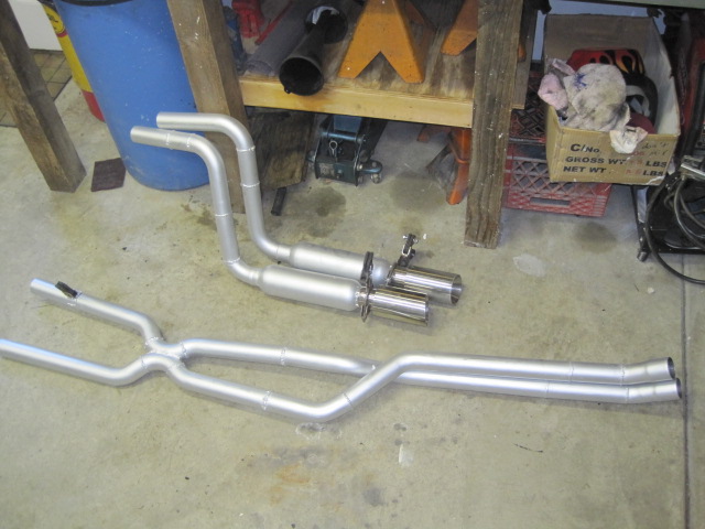

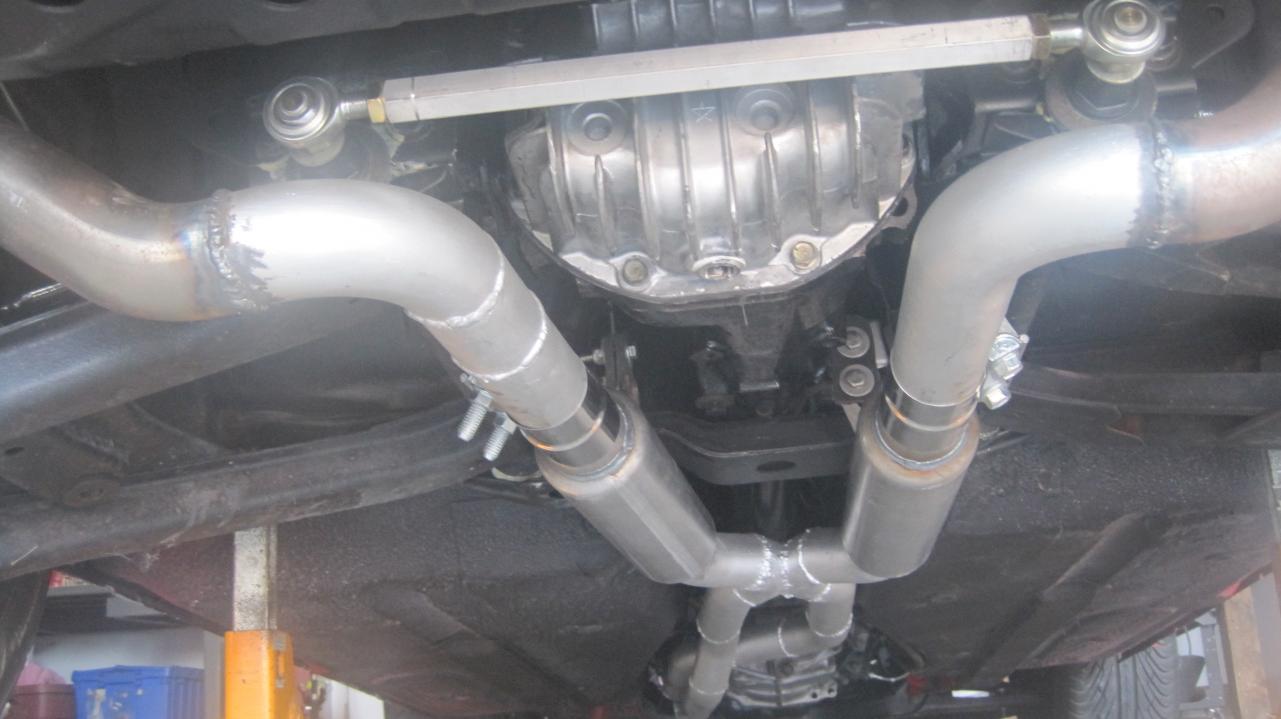

As for the OP's second question, a single 2.5" to 3" pipe is better than duals because of weight concerns, price and possibly loss of secondary scavenging effects if you plan on true dual pipes. I have a Clifford header and plan to use it to replicate the old dual system because I like the look and sound not because it is the best performer.

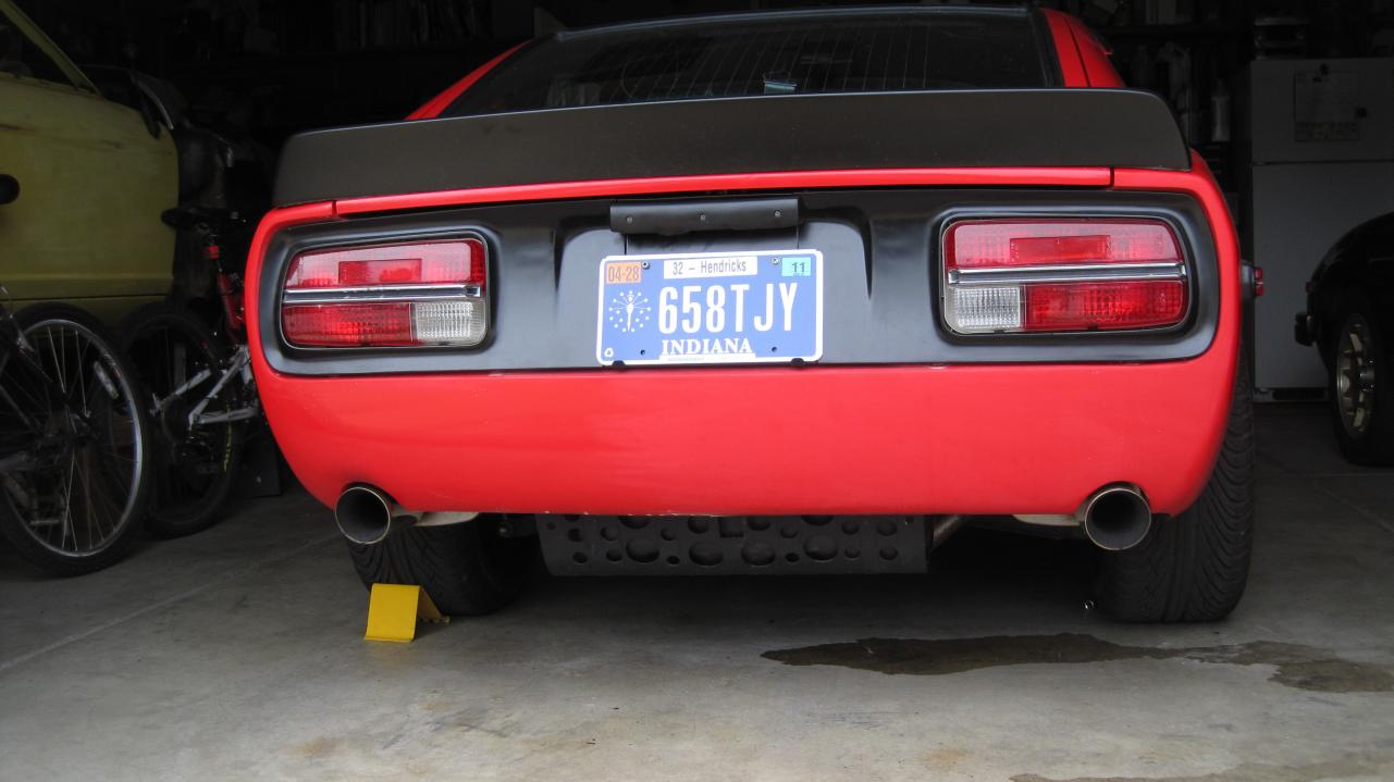

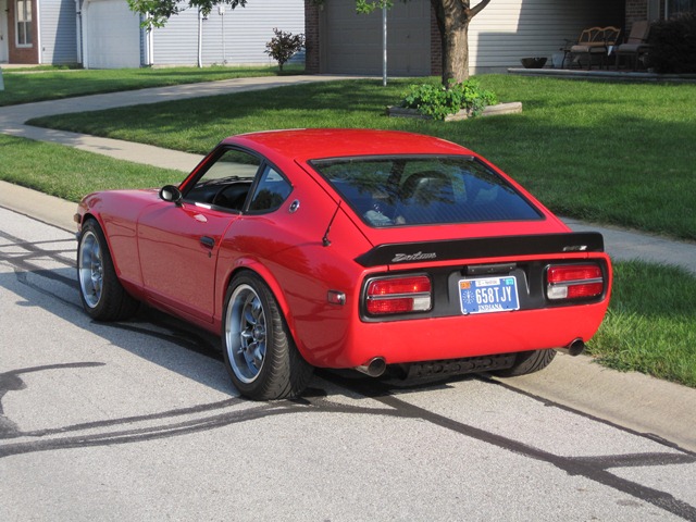

Oh, and the biggest reason for duals is they are WAY-COOL
Yeah, especially split duals like yours, on cars where you don't expect to see dual exhaust. Too bad it requires so much modification to do it on a Z - props to you for going the extra mile there.

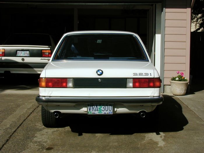

I've seen this in the past on some of my own cars. In both of the examples below, if someone comments about the car (or commented, in the case of the long-sold BMW), 3 times out of 4 it was about the exhaust.
The BMW was factory - the 323i was the euro top-end model of the 3-series (2.3 L inline six, 4 wheel disc) and came with factory dual exhaust.

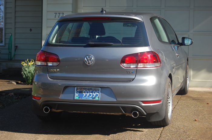

On the Golf TDI (diesel) I converted to the GTI dual exhaust. Changed the whole look of the rear of the car.
