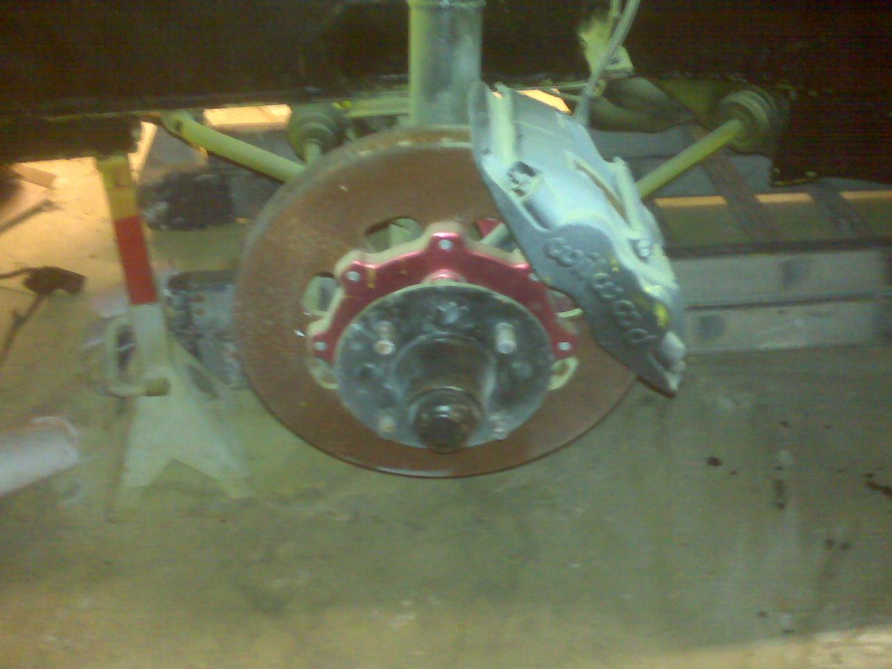

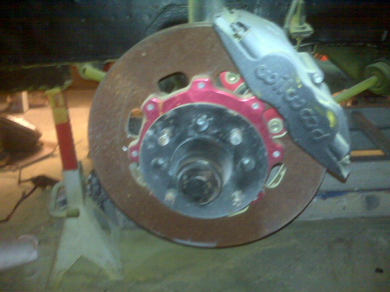

Hey guys, take a look at the wildwood brake upgrade. can someone advise if the wheels will clear the calipers. I think I mentioned it earlier but no one said anything about it. Please let me know if I will be needing spacers or does the wheels goes right on.
Ok, then I guess there will not be any issues with the 16s. Madkaw tell me how you got dual exhaust pipes n reference the gas tank on the right side. I no this is not the thread but you can email me what kind of set up. exhaust n what engine. chachacourt@yahoo.com

Sure Nativez, I will be posting some pics to keep this thread going. I the windshield and the mouldings from Nissan. The calipers were taken to a shop to get powder coated paint yellow to match the car. black wheels, yellow calipers, yellow car hummmm hummm. I had talked to a guy at Lamborghini and he said the best way to paint calipers are powder coat. Wildwood will be in glossy black.
