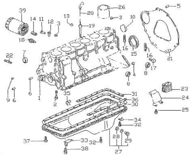

I am looking for those parts ,my datsun is a 1977 280z,and my oil pan leaks even after changing the gasket at the Nissan dealership here in Tucson Az,and i was told that there are no longer avialiable..Does any one as a picture of those parts so i may go to the junk yard and know what to remove, or were i could buy some .

From the Datsun / Nissan Parts Microfiche:
11124-R1000..............Reinforcement - Oil Pan (This piece goes around the rear of the engine, and along the passenger side of the engine.
11124-P6500..............Reinforcement - Oil Pan
11123-N3300.............Reinforcement with Heat S/Plate (This piece goes along the driver side of the engine near the Exhaust Downpipe)
11123-N4200.............Reinforcement with Heat S/Plate
The Datsun / Nissan Mircofiche does not specify a change over date from the first part numbers to the second.
