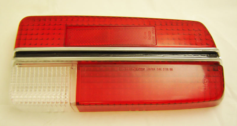

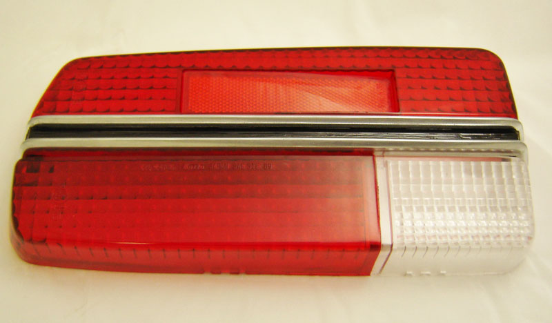

May 14, 201113 yr comment_355783 Zed2, thanks for taking the time to research this issue for everyone. To be honest, for some time I've been contemplating doing exactly what you proposed. During my thought process, however, I realized that remanufacturing them in plastic was only putting the same problem back on, plus, a more expensive plastic chrome process is required for exterior pieces than for interior ones. The ideal solution would be to make these parts out of metal, but cutting them out of solid stock using a CNC machine would be pretty costly. Low cost casting using aluminum, or pot metal would be a nice compromise, but chrome doesn't always adhere well to those materials either and they can become affected by exhaust gases and corrode too.Here's my latest evolution on this. The goal is to replace the lost metalization from the plastic substrate in the most cost effective and durable manner. I believe it would be much easier to use a press to stamp a metal "appliqué" between two dies to replicate the surface and textures of the strip. This appliqué would then be adhesively affixed to the tail lamp strips still mounted on the car. In this way no disassembly of the lens is required and the cosmetic issue is addressed, permanently. The appliqués can be stamped out of thin stainless steel stock to resist corrosion and shipped in pairs to owners along with adhesive and installation instructions.Criticisms are welcome. Link to comment https://www.classiczcars.com/forums/topic/39028-240z-chrome-taillamp-strips/?&page=4#findComment-355783 Share on other sites More sharing options...
May 14, 201113 yr comment_355784 Keith,If the part is indistinguishable from the original I would still possibly be interested. jlp Link to comment https://www.classiczcars.com/forums/topic/39028-240z-chrome-taillamp-strips/?&page=4#findComment-355784 Share on other sites More sharing options...
May 15, 201113 yr comment_355793 The appliqués can be stamped out of thin stainless steel stock to resist corrosion and shipped in pairs to owners along with adhesive and installation instructions.Criticisms are welcome.Sounds sort of like the dash cap solution, but stamped instead of vacuum formed. I'm guessing the labor, dies, and stamping press will bring the price near the $150 price mentioned in the other solution mentioned above. The vendor for replica early Z lenses that are currently available could probably provide a more cost effective solution if willing to sell just the chrome strips. Certainly, this is a part many of us would buy if the quality and price were right.Dennis Link to comment https://www.classiczcars.com/forums/topic/39028-240z-chrome-taillamp-strips/?&page=4#findComment-355793 Share on other sites More sharing options...
May 15, 201113 yr comment_355798 I visited with Kip today. Here is his assessment; Manufacturing strips out of metal would cost the same as plastic (as original). The metal strips could be chemically dipped chromed as opposed to the method used for the plastic which we all know deteriorates. To create the mold and manufacture the strips w/chroming would be $150 pair; minimum 10 pairs. There is no shelf life to the mold, so presumably another batch could be produced at a later date.Based on this cost plus shipping, the interest level at the $90 poll results, and the time to coordinate the project, I think that the project isn't feasible at this time.KeithKeith,If the part is indistinguishable from the original I would still possibly be interested. jlp Link to comment https://www.classiczcars.com/forums/topic/39028-240z-chrome-taillamp-strips/?&page=4#findComment-355798 Share on other sites More sharing options...

October 18, 201311 yr comment_433999 I’ve been following this thread for some time, watching to see if someone would reproduce 240Z tail light bars, what the quality would be like and what the cost would be. Several here have promised to make them available, but to date no one has parts in any quantity to sell.My name is Randy Lewis. I’ve owned many, many early Z’s, 510’s and Roadsters and have been part of the Datsun community for over 20 years. I drive and show my cars frequently. I’m regularly accused of being anal about quality and I’m always complimented on how my cars show. In February, I was encouraged to reproduce 240Z tail lamp bars by local club members. I can personally attest to the cost to reproduce complex parts to OEM quality standards. The cost of the tooling alone is thousands of dollars. This is not a venture for the weak of heart. Never the less, I made the decision to proceed seven months ago.I determined I would only do this if I could offer OEM or better quality. I’ve forwarded my production samples to several well-known and respected individuals in the Z community (including MotorSport Auto in Orange, CA) to validate production quality. I’ve received a volume of pre-orders based on their assessment. My parts are triple chrome plated and have all the proper mold marks on them, as the tooling was produced from OEM parts I provided my supplier. The black paint fill in the center of the bar is identical to the originals. Each set of bars (left and right) will be shipped in poly bags, complete with the correct push-on fasteners and installation instructions. I guarantee the quality of the parts you receive. If you’re unhappy, you can return them for a full refund within 30 days, less the cost of postage.• Tail lamp bars sold as a pair (right and left sides)• $175 for the pair plus postage• $15 flat rate postage anywhere in the U.S. (except bulk orders)• Package sent Priority Mail (insured)• Orders for 20 or more pair discounted 10%• PayPal accepted for payment. • Orders accepted immediately • Shipping to begin within 10 daysI don’t know how long my initial run will last but I’d encourage you to act fairly quickly as these parts have been in demand for some time and I’ve already committed some of my initial production run. Orders will be received via e-mail at: parallax.randy.lewis@gmail.comYou’ll be advised via e-mail when your order is ready to ship. Order will ship as soon as I receive payment notification from PayPal. Link to comment https://www.classiczcars.com/forums/topic/39028-240z-chrome-taillamp-strips/?&page=4#findComment-433999 Share on other sites More sharing options...
