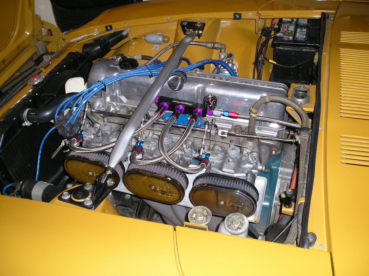

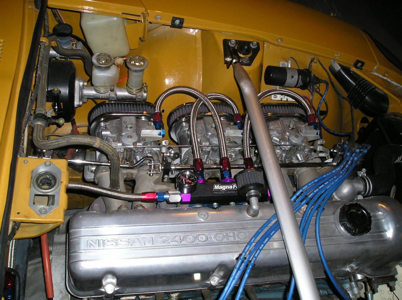

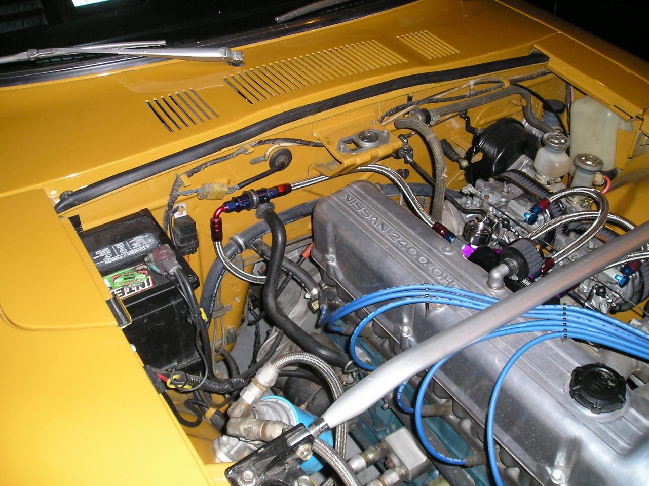

I ran a 3/8" hard line from a filtered electric pump at the tank into braided Aeroquip line, through filter, then to fuel block, then to each carb. Gauge installed on block. No return line, no mechanical pump. No heat problems. Fuel pressure <6 psi.
Hope this helps.
Frank
Bolted to the intake/exhaust bolts from the head.
I was quite surprised that the heat soak from the head/exhaust didn't boil the fuel, but it's worked quite well since early last summer. This car has never exhibited the vapor lock problems that other Zs have had. I don't really know why, either.
