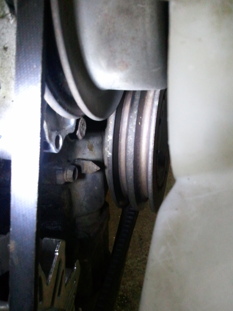

post-20168-14150815338169_thumb.jpg My timing scale differs from yours. There is 5 little nicks on the wheel and only one "arrow". In wich position should the wheel/chain be? Im totally newbie in timing things. Also where this white piece of chain should be when in TDC?
The pulley turns clockwise as viewed from the front, so the first tick to sweep past the pointer should be 0 degrees with the others are at 5 degrees apart. In your photo, the top tick is 0. Maybe paint it yellow or red :)
The painted link on the timing chain may or may not line up. It does not matter. Just get piston in highest position and two front cam lobes for cylinder #1 up- then you are good for TDC.

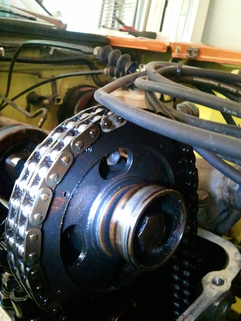

Dauym cam sprocket, i better loosen it a bit before setting it to TDC... After turning the cam few times i found out the TDC, white chain in 2o'clock and first nick on the arrow. But i lost it when i started to loosen the cam sprocket LOL. Amazing is that i havent break a single bolt so far and exhaust and intake manifolds were super easy to remove.

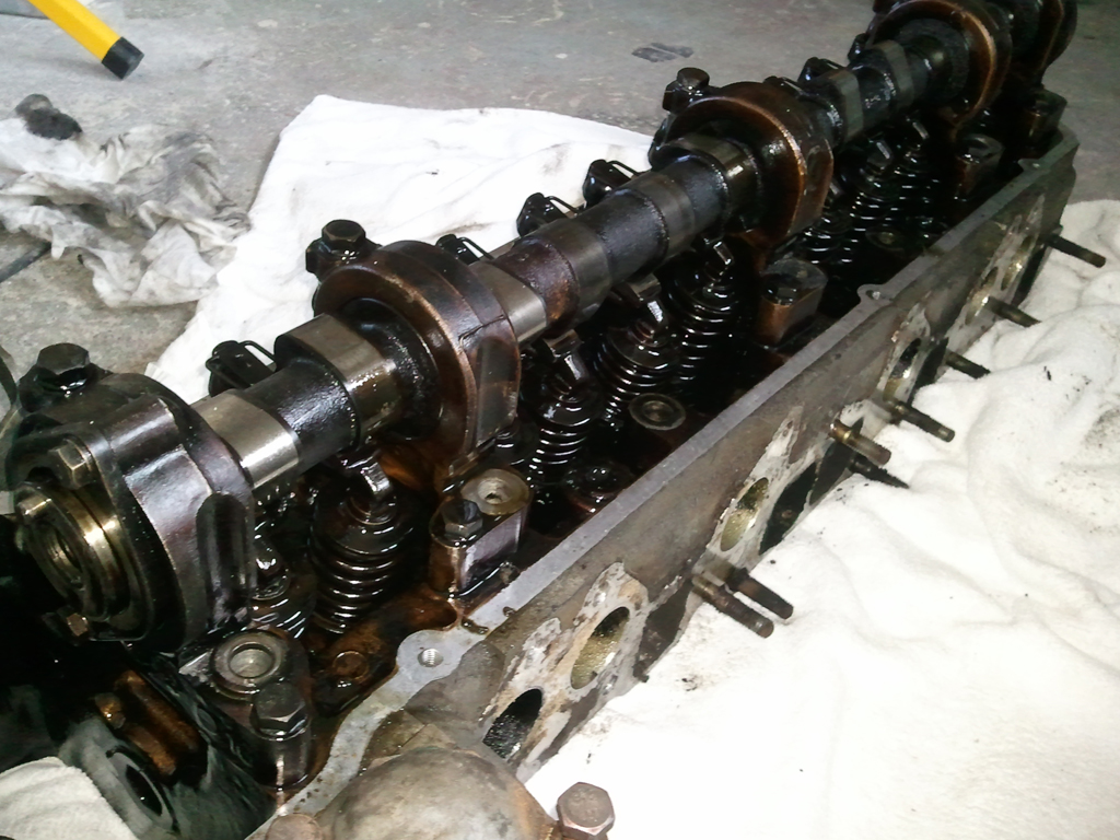

Li'l update on the current situation: Head is off and chain is tight for now. BUT i forgot to look in which hole the camshaft guide was in cam sprocket. There is 3 holes in sprocket. It SHOULD be in tdc, cam lobes are up (\ /) and piston also. Thanks to my lovely wife who helped me to lift the head up and hold the chain on place. post-20168-14150815383334_thumb.jpg
Since you are not replacing the timing set (chain, gears, guides and tensioner), you would likely have to advance a hole or two anyways. When you reassemble, start with hole #2 and check the chain stretch per the FSM. If it needs more, go to hole #3. If that doesn't do it, it's time for a new timing set.
Don't forget to stuff a clean towel down around the chain until you are ready to reinstall the gear. Every small part in your garage will get sucked down that open hole like it's a giant vortex.
It looks like cylinder #6 was the one with the head gasket leak since it's the only clean piston.
