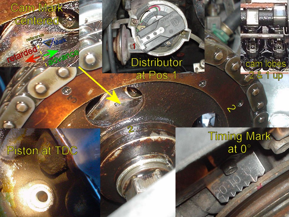

July 15, 201113 yr comment_361584 If you are absolutely sure that the sprockets on the cam are meshed with the same links on the chain then you are ok. Other wise you may be a link or two off in advance or retard direction. This will result in a problem. The best thing to do now is to continue with the chain attachment (assuming head is torques down) then remove the wood (keep valve cover off) then : 1, Turn the crank using a big socket. (hopefully the valves will not hit the pistons so be careful and stop if you feel any interference) 2. Do 2 revolutions then align the timing mark on the damper to 0 degree mark and the \ / angles for cylinder 1 lobes (you know what I mean) "TDC" 3. Check the cam sprocket alignment reference and triangle marks. If the triangle and reference marks are close then you are good. If they are significantly to the right or left then you must remove the cam sprocket (using wood again), then re-install the cam sprocket rotated either way so that the dash and the triangle line-up. See the picture below. Edited July 15, 201113 yr by Blue Link to comment https://www.classiczcars.com/forums/topic/39146-new-head-gasket/?&page=5#findComment-361584 Share on other sites More sharing options...

July 17, 201113 yr comment_361754 Change oil because debris could have entered it.Also make sure with the damper at O degrees check the marks on the cam sprocket to make sure it is correct. THIS IS VERY IMPORTANT. Link to comment https://www.classiczcars.com/forums/topic/39146-new-head-gasket/?&page=5#findComment-361754 Share on other sites More sharing options...
July 18, 201113 yr Author comment_361802 Yes i turned cam few times and sprocket marks and cam marks match as does the lower 0 degree mark. So all SHOULD be fine..?! Well i better change that oil then, i use cheap Mobil 10W-40, which seems to be a good oil for my Z. Link to comment https://www.classiczcars.com/forums/topic/39146-new-head-gasket/?&page=5#findComment-361802 Share on other sites More sharing options...
