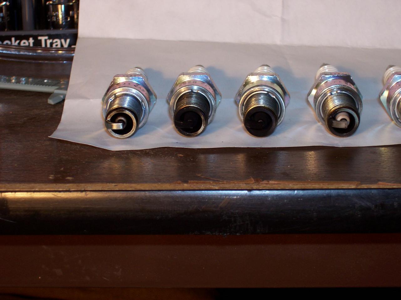

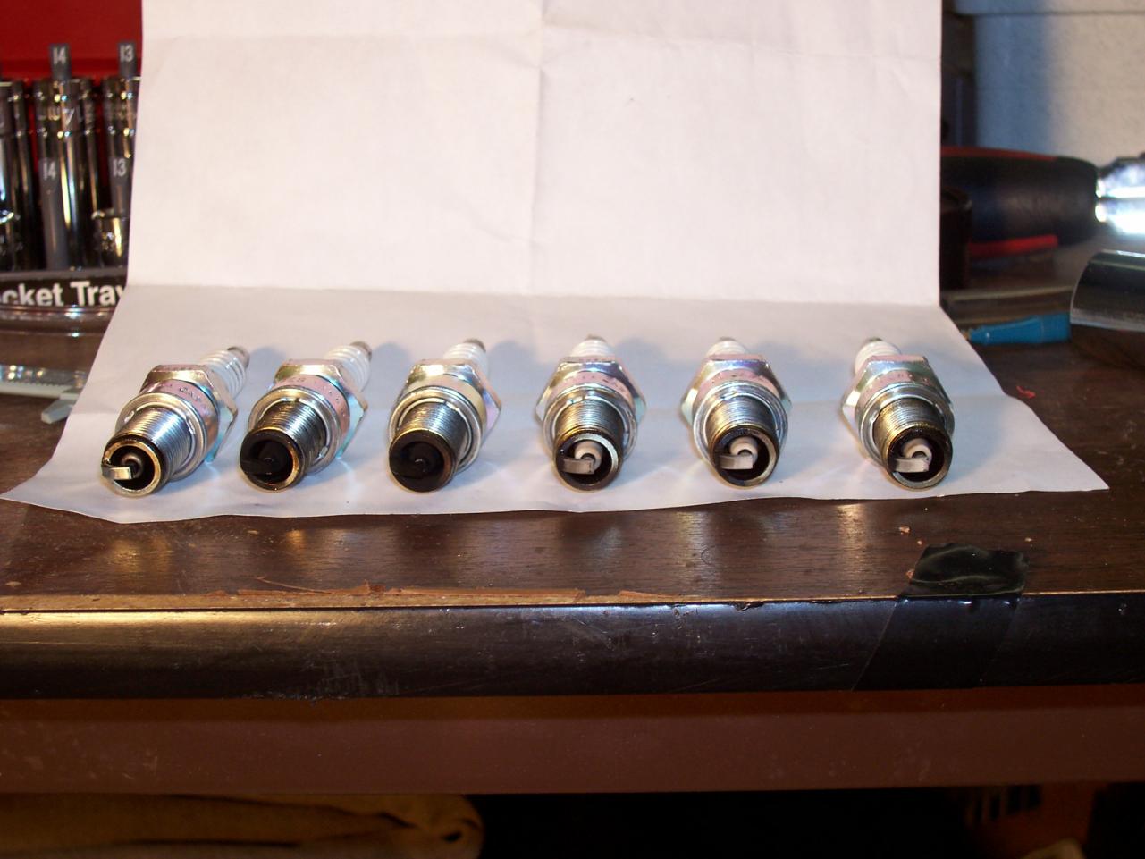

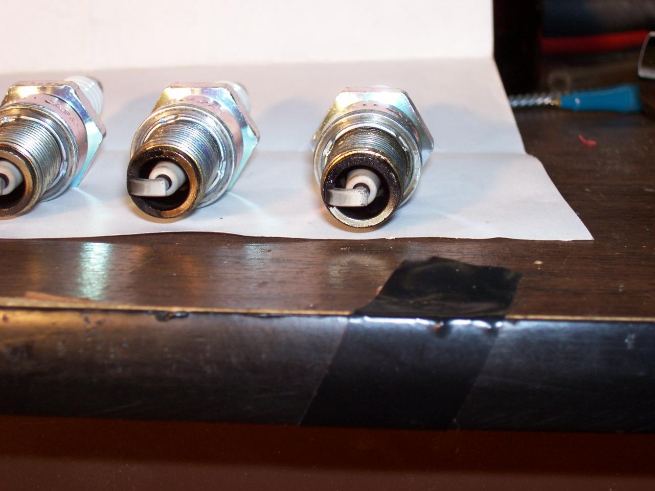

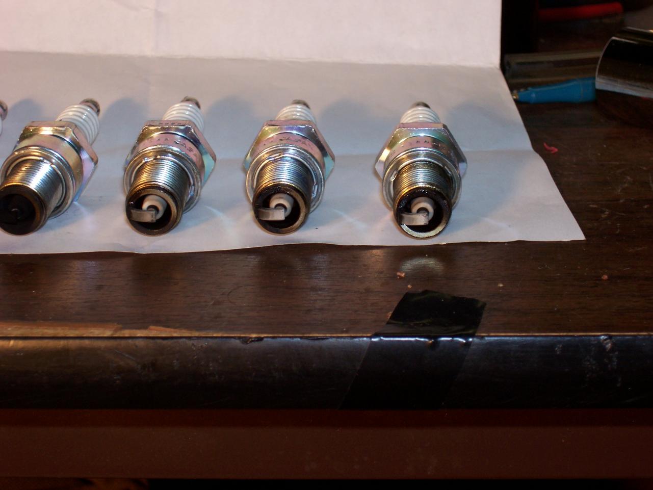

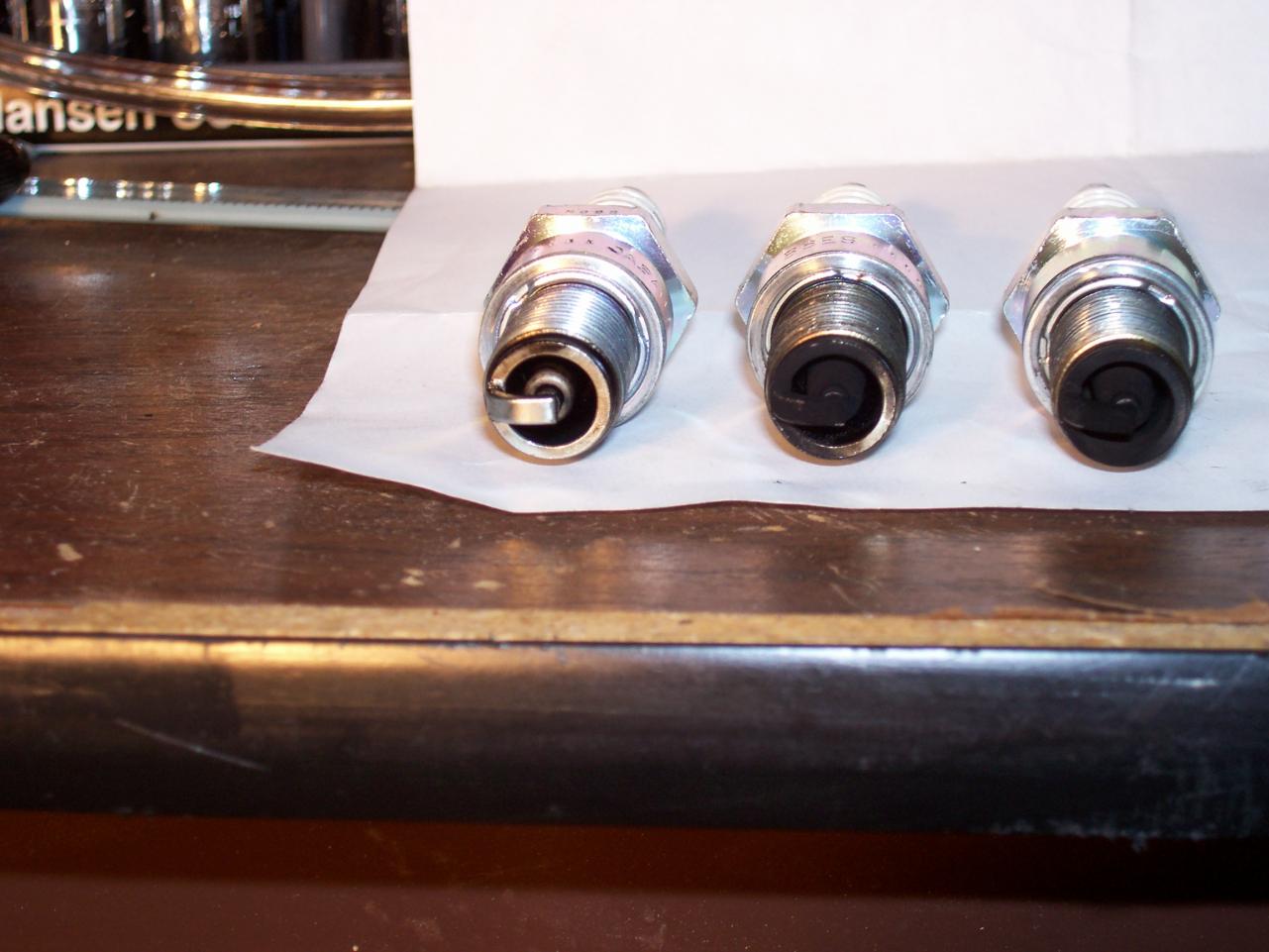

Also, I thought it might be good to show a recent pictures of my plugs based on how the engine is currently running. post-23329-14150814521855_thumb.jpg
The plug on the left side is #6, and going to the right side of picture is #1. I have driven it a little more 100 miles? since these pictures. Plugs 3,2,1 seem a little more like tan than gray. Plugs 5 and 4 are always kinds of black. But since this picture, they are starting to look like they have a little brown patch on the tip and not quite as black. Remember my timing was recently changed.
And most interesting to me is how #6 barely looks like its being used. I mean shouldnt it have something on it?
Based on those pics, you've got something else significant going on. All of those plugs should read approximately the same. The black ones are running way to rich. The #6 is a huge miss.
I agree with cozye. Adjust your valves and do a compression and leak down test.
Well I figured I better post the picture, because I was somewhat baffled how 3,2,1 all seemed to be very similar, and I think are looking OK. But 5,4 are not good, and #6? its like not even burning in my eyes. The thing is, the local mechanics hooked up a oscilloscope with a two tablet computer screens (one big one and a smaller one) and said nothing was missing. I watched them run the test and looked at their computer screens. Of course I have never seen that procedure done before....so the be honest I didnt really know what I was looking at. But they claimed burn time was good, firing pattern looked OK, and other parameters were OK too with the secondary ignition. I didnt really understand all that stuff yet.

Argneist, I'm wondering whether your #6 injector is injecting. You might have a bad connection.
#'s 1-3 look lean. #'s 4 and 5 look really rich. I'm also wondering whether you have connectivity issues with your injectors or drop resistors.
And of course you might have significant valve adjustment issues. Perhaps Cylinders 1-3 are drawing a lot more air than cylinders 4 and 5. (All cylinders supposedly get the same amount of fuel, assuming the injectors fire.)
