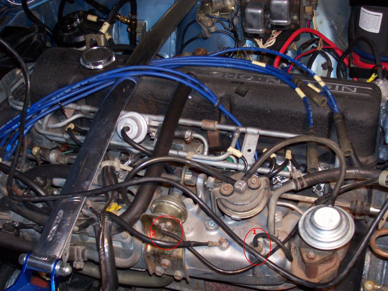

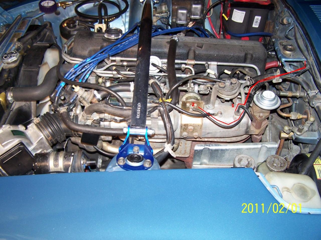

April 19, 201113 yr Author comment_353235 The pictures shows #1 and #2 hoses that I disconnected for HVAC system and plugged them off and the intake hole I plugged off too. But the picture doesnt show that I also disconnected the brake booster vacuum hose too. I should have numbered that #3. But then you know where its at anyway. I decided to remove the vacuum lines for the brake booster and the HVAC system from the equation (someone else was talking about HVAC causing vacuum problems. I unplugged the two hoses from he intake manifold, and then capped them off using a small section of vacuum hose with a bolt in the end of it. I also removed the hose from the fast idle actuator and capped it off. So basically, from a vacuum standing point, things were simplified a lot. If I understand correctly after looking at the system in the engine area, and also the FSM, that means I have effectively removed the HVAC vacuum from the system. So if HVAC was causing a vacuum problem before, after removing those hoses from intake etc...that it could not be contributing to a vacuum problem after removing them. Is it possible the ECU is powering up the injectors (because I swear I can hear them clicking) but not sending the correct kind of a signal to the injectors to spit out the fuel ... or not at the right time, or not enough or too much of it? I was also wondering about the dropping resistors, since they are the last stop from the ECU to the injectors. I see a test in the FSM for the Dropping resistors that I am going to try tonight. I noticed those two hoses were sharing the intake runner for #6,5,4 cylinders (but mostly nearest #6 runner). Well after removing those vacuum lines, it had no effect on engine performance So that seems to tell me it had nothing to do with those systems. I thought maybe I had a smoking gun. But nope I guess not. ************************** So what is VERY interesting to me is this, in the process of testing for HVAC vacuum problems, I decided it was time to also pull off the fuel injector (electrical) connectors, one by one, from 6,5,4,3,2,1. Well I cant believe what happened. As soon as I pulled FI electrical connector for #1,2 and 3, the engine immediately took a nose dive, and plugging it back in, it went back to its normal sounding speed. But when I removed 6,5,4 fuel injector electrical connectors NOTHING HAPPENED. The engine sound did not change. I tested it many times last night and this morning earlier. Although one caveat, when I plugged #4 injector connector back in, the engine for about 1/2 second picked up speed, and then settled back down. And every time it was repeatable. Pull #4 off, no change, plug it back in, a small bump up in the engine sound and then back to original sound. Unplug #5 and #6, no change in engine sound. I waited like 30 seconds sometimes...still no change. I dont know what this means yet, but if the engine isnt responding to pulling off the FI connectors for 6,5,4,, and combined with the spark plugs on 6,5,4 looking odd (#6 looks clean like its not doing anything, and 5 and 4 are black -even after 30 or 40 miles of driving) this cannot be a good thing for the engine performance. Any thoughts or ideas why 6,5,4 are acting like that, when 3,2,1 are acting how I would expect them to operate. Also, someone else asked me about whether or not I have good spark. I had a technician hook up an oscilliscope/computer tablet screen last week, and I called him back today to verify and tell him what I found out about the FI connections, and he said based on what he saw with his 20 minute inspection with the computer/oscilliscope that we are not looking at a spark plug issue. He said the secondary ignition system firing pattern and burn time looked fine, and we didnt have any misses...except maybe a tiny little on #2 This makes me think we are having a fuel related problem, and that the injectors are not delivering fuel correctly. Also, I might be getting a fuel injector tester because someone has one I can borrow, or I can go there and have them tested while still on car by a technician, just to make sure the injectors themselves are working (they are brand new injectors and were not on the shelf very long). I would like to believe these new injectors are working in the sense that they are physically capable of delivering fuel, but its the ECU that is causing the issues or maybe the dropping resistors? Edited April 19, 201113 yr by argniest Link to comment https://www.classiczcars.com/forums/topic/39246-a-few-questions-about-afm/?&page=3#findComment-353235 Share on other sites More sharing options...
