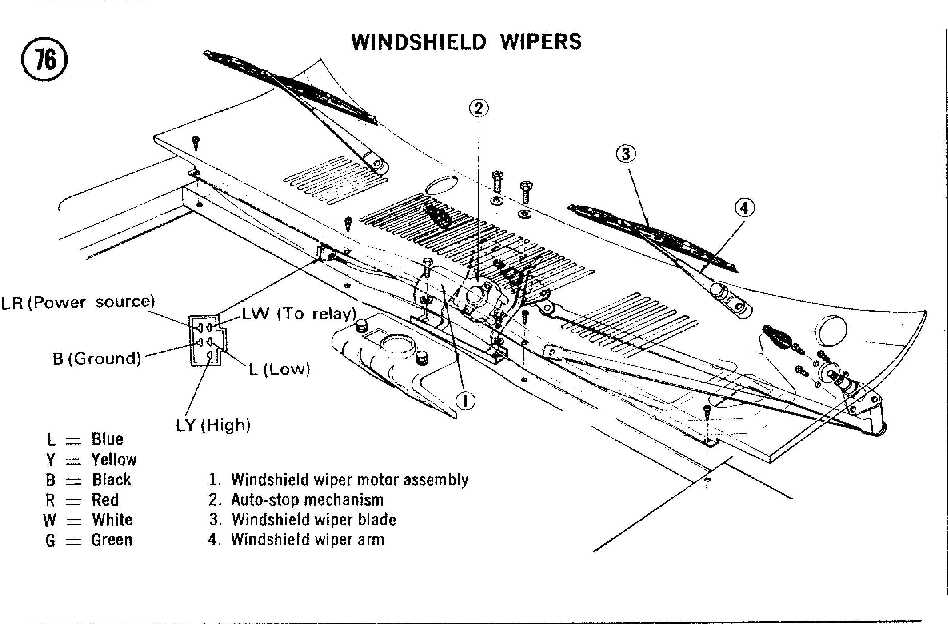

I scanned this in from an old Clymer's manual, the first one with the blue cover.
Although it shows the "blow-up" diagram, it doesn't show the parts detailed in my post, but it should help as far as the general assembly and location of the wipers.
Hope it helps.

P.S. I had to shrink it and split it into two pictures in order for it to be allowed on the site, if you want a larger image of it, in order to read the numbers / words better, let me know or e-mail me with your address.
