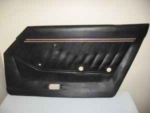

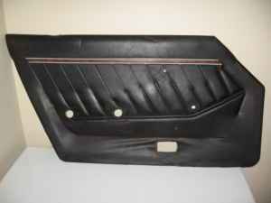

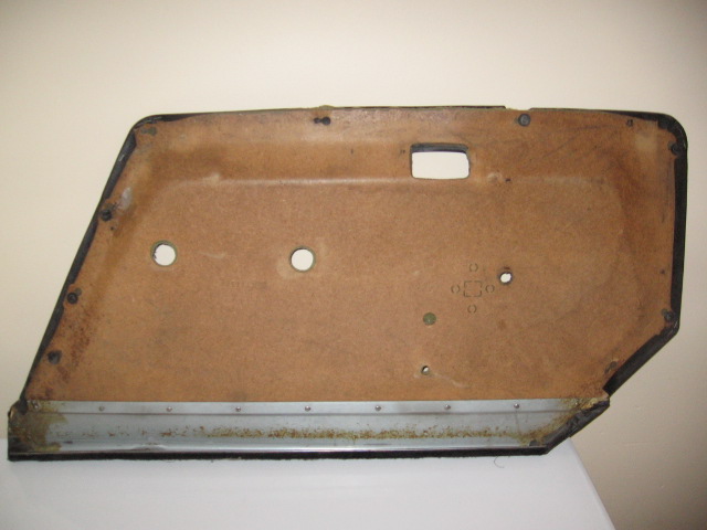

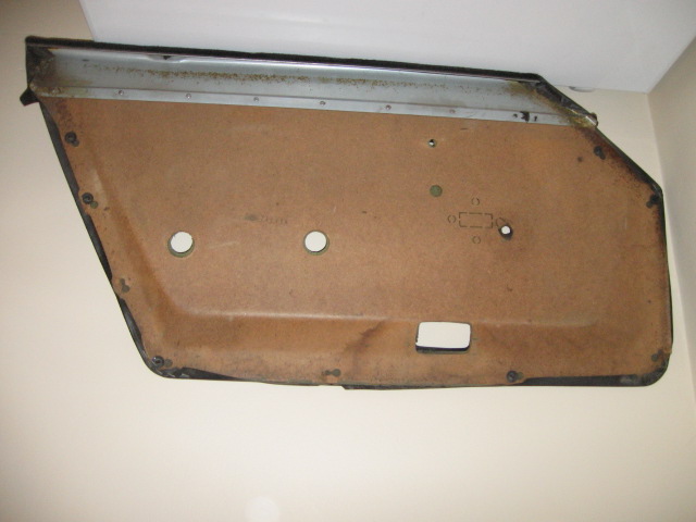

April 19, 201114 yr Author comment_353243 Thanks for the good info, guys, I appreciate it. The guy who has the 280Z panels up for sale isn't sure what year 280Z they came from. As I mentioned, my plan is to remove the vinyl on the 280Z panels and only use the boards for my new 240Z door skins. I have attached some pics of the door panels and as Steve and Jeff indicated, if these are 77/78 panels, they will not work. Please let me know if these are the 75/76 or the 77/78 panels. Link to comment https://www.classiczcars.com/forums/topic/39274-will-280z-interior-door-panels-fit-in-a-240z/#findComment-353243 Share on other sites More sharing options...
April 19, 201114 yr comment_353270 OK I have an answer here.1974 (260Z) 1975-1976 early 280z are the same door panels and they could be fitted on 240z. However, door armrest and passenger pull handle location will be problems.You either stay with 280Z type door handle/armest and drille holes on door sheet metal. Or install 240Z armrest and pull handle, but there are few holes showing.Now 1976 late to 1978 type is totally different. It is biger, clips holes do not match at all. Farthermore, door lock-rod-hole is about 1 inchi off. Classic Datsun Sells incredible door skin kit, which look just like factory ones with chome molding.You know how picky I am. They are very good. If you spent $150 -250 for a set of used door panel, I would go and get them re-covered. Link to comment https://www.classiczcars.com/forums/topic/39274-will-280z-interior-door-panels-fit-in-a-240z/#findComment-353270 Share on other sites More sharing options...
April 19, 201114 yr Author comment_353323 OK I have an answer here.1974 (260Z) 1975-1976 early 280z are the same door panels and they could be fitted on 240z. However, door armrest and passenger pull handle location will be problems.You either stay with 280Z type door handle/armest and drille holes on door sheet metal. Or install 240Z armrest and pull handle, but there are few holes showing.Now 1976 late to 1978 type is totally different. It is biger, clips holes do not match at all. Farthermore, door lock-rod-hole is about 1 inchi off. Classic Datsun Sells incredible door skin kit, which look just like factory ones with chome molding.You know how picky I am. They are very good. If you spent $150 -250 for a set of used door panel, I would go and get them re-covered.Esprist, Thank you for the good information. Actually, I purchased my blue door skins with the chrome strips from Les at Classic Datsun and they look great! That's why I've been so picky trying to find solid door panel boards to mount the new skins on. Sounds like it might be more trouble than it's worth to modify 280Z door panels. I think I will continue my search for a pair of solid 240Z door panel boards. Thanks again for the help guys. Link to comment https://www.classiczcars.com/forums/topic/39274-will-280z-interior-door-panels-fit-in-a-240z/#findComment-353323 Share on other sites More sharing options...
