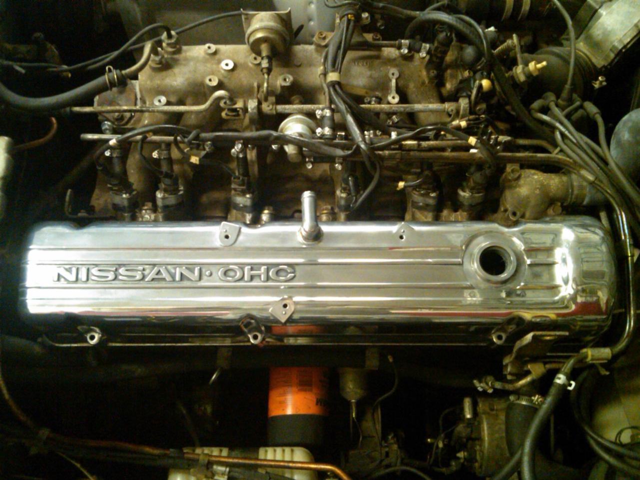

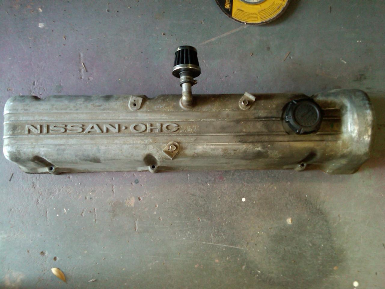

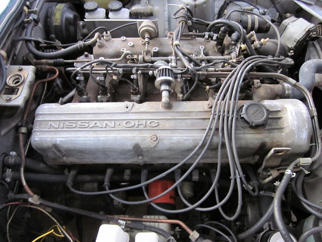

Took one picture of it off the car before I started. Two pictures with the cover back on the head. Decided to do this while I did my cold valve adjustment. It is not mirror finish but has a pretty decent look to it now. post-21670-14150814583914_thumb.jpg

I wasn't real sure on how to go about this so I did some trial and error. I found wet sanding with 400 and 320 grit sand paper knocked down all the pitting and corrosion pretty well. I went to a local heavy duty parts house and bought a yellow and white buffing wheel. With the yellow buffing wheel I applied brown jewelers rouge to the wheel and applied it with my 7" Makita buffer at about 1800 revs. This really cut well and took out the majority of the sanding marks which were pretty limited to begin with. After I used that wheel and compound I switched to the white wheel and some light green compound. Both of this compounds come in long trapezoidal block and are found at trucking parts stores. I also bought some stuff called "white diamond" that I put on with a rag at the end, I don't think it helped shine it anymore but it was recommened and supposedly it protects the finish. You don't want to use the same wheel with different compounds. Be prepared to be covered in black soot/film when you are done and if you want to be divorced do this in the house. With only the large buffing wheels I couldn't get the recesses of the bolt holes for the valve cover too well. Ideally a little spindle buffing tip on a drill or straight die grinder would be ideal here. Help this helps.
