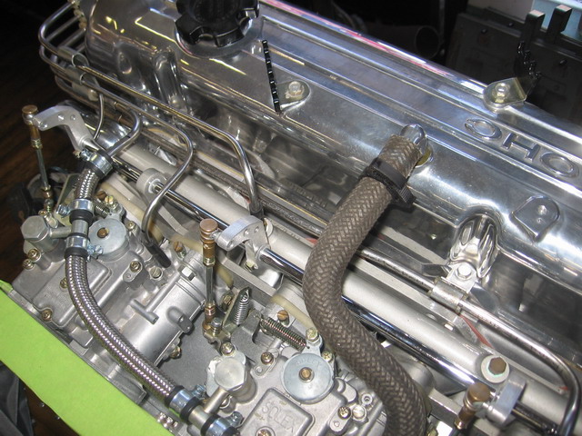

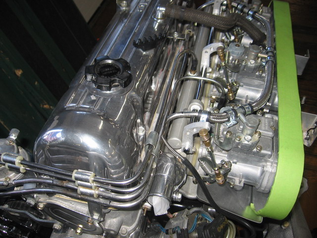

I designed a balance or vaccuum tube for my Mikuni manifold. It was fabricated by a machine shop that specialize in race car parts.
If you would like a copy of the drawing, please send me a PM.

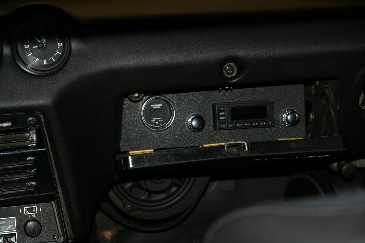

I wanted to update this install with the location that I installed my Air Fuel Gauge. Works great - out of the way and easily accessed for me to monitor if needed. If you're going to tune triples this is a necessity. Close up the glove box door and nobody knows it's there.

Mitchell, were did you buy your air fuel gauge? And did you have to install an O2 sensor? I'm trying to figure out an inexpensive way to fine tune my EFI.
Bob
Edited by rcb280z
O2 Sensor and Air Fuel Gauges are not cheap - did a ton of researching and ended up using one at Summit Racing (since the hidden radio was digital I figured why not for the AFR gauge) it reads the digital number and sweeps from halfway down - either on the lean side or the rich side. The 02 sensor installed in the collector of the header. Run some power and your good to go.
