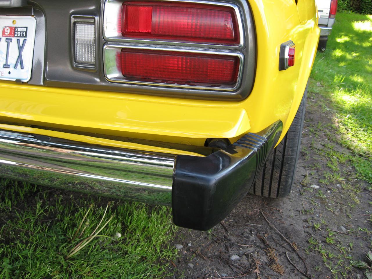

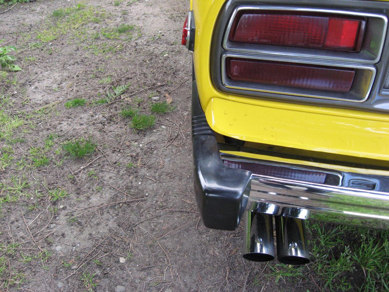

May 24, 201113 yr Author comment_356683 Darrel, the other end is strait, But there is an indication that the bumper is shifted a little to the left. But it also looks to have a slight twist, like the right bumper strut is bent up and in (makes sense looking at the original damage). Any how I am pretty sure I could get things lined up with time but I am am supper busy at work and I would like to start fixing some other non mechanical issues with the car. Take it back in or fix myself??? other side... Edited May 24, 201113 yr by grantf Link to comment https://www.classiczcars.com/forums/topic/39361-fudge-someone-rear-ended-my-car/?&page=3#findComment-356683 Share on other sites More sharing options...
May 24, 201113 yr comment_356706 That's why when it happened to me, I immediately looked for a high class restoration shop to get an estimate. Restorers know the difference. They would NEVER have put that right corner rubber part back on the car, and they would have included the plug that covers the bolt too. I hate to say it but... http://www.classiczcars.com/forums/showthread.php?42086-Fudge!!!-!!!!!-someone-rear-ended-my-car&p=362153&viewfull=1#post362153I hope they make it right for you now. Edited May 24, 201113 yr by cygnusx1 Link to comment https://www.classiczcars.com/forums/topic/39361-fudge-someone-rear-ended-my-car/?&page=3#findComment-356706 Share on other sites More sharing options...
May 24, 201113 yr Author comment_356737 cygnusx1, that acually is a replacement, the damaged one from the accedent was in better shape. The plug is not shown because I removed it to see if I could tweek it back strait. The shop I took it to had a really good word of mouth following. I just think that they rushed my car through. Link to comment https://www.classiczcars.com/forums/topic/39361-fudge-someone-rear-ended-my-car/?&page=3#findComment-356737 Share on other sites More sharing options...

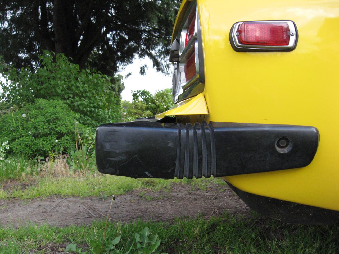

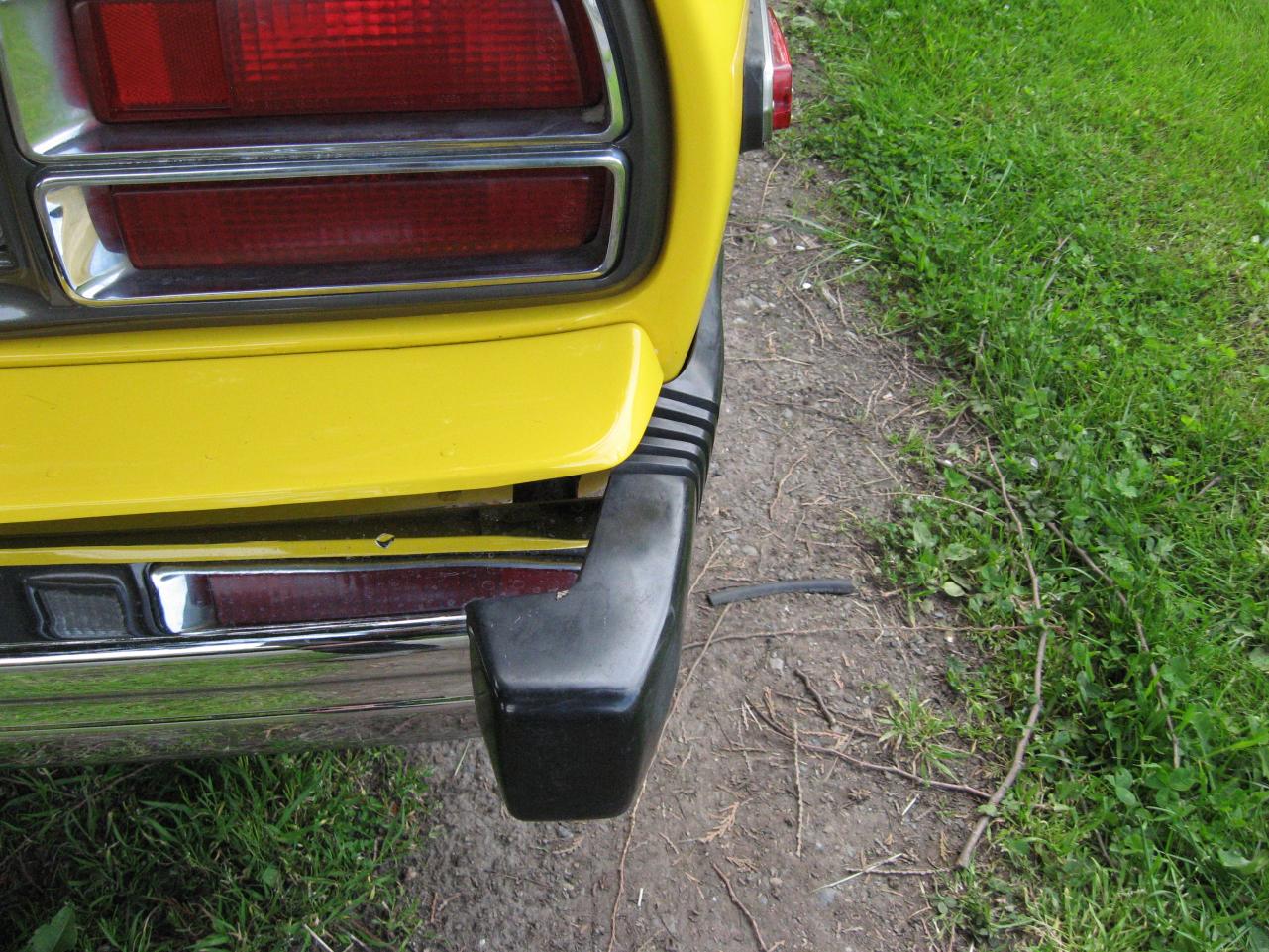

June 1, 201113 yr Author comment_357451 I got my some of my old parts back (well actually just the bumper end). It turns out the used one they installed was missing a bonded stud so they cannibalized the one from my old bumper end :mad: So I had to cut it back out of the POS they put on my car, and glue it back on. In addition the right hand bumper strut was bent in a little from the damage and I managed to tweak it back a little. here are pics of the end after my fix and after the professional job . Edited June 1, 201113 yr by grantf Link to comment https://www.classiczcars.com/forums/topic/39361-fudge-someone-rear-ended-my-car/?&page=3#findComment-357451 Share on other sites More sharing options...

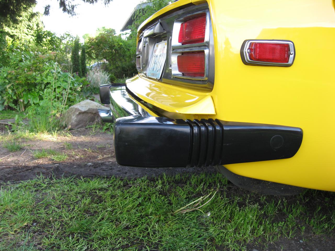

June 1, 201113 yr comment_357453 Do you have a pic along the top of bumper and bumper end for comparison?Looks alot better. Link to comment https://www.classiczcars.com/forums/topic/39361-fudge-someone-rear-ended-my-car/?&page=3#findComment-357453 Share on other sites More sharing options...
June 2, 201113 yr Author comment_357564 here. The first is what the repair shop did, second is after putting my old part back on and aligning the bumper Link to comment https://www.classiczcars.com/forums/topic/39361-fudge-someone-rear-ended-my-car/?&page=3#findComment-357564 Share on other sites More sharing options...
