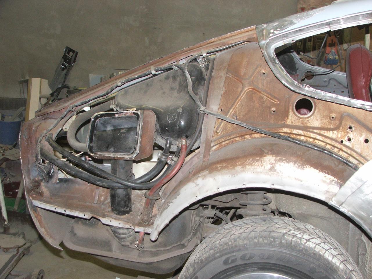

I have a 1972 and Chilton's indicates the same setup, so assuming they are the same and I've got them hooked up correctly:
Using Pat Carr's photo going from left to right:
The left-most and smallest (partially hidden) connects about 1/3rd of the way up the evaporation canister and hooks up to the tank on the passenger side, maybe midway up. You have to get under the car to even see this one. The second (medium) goes to the driver's side, top of the tank. The third (large) goes to the passenger side, top of the tank. The last and largest loops back to the filler tube.

Thanks for that cut-away photo. There was a rubber grommet on the line that goes to the driver's side of the gas tank and I couldn't figure out where that was supposed to go. Based on the photo, I now think it belongs right where the hoses passes through one of the supports so that the metal doesn't cut into the hose.
In any event, I picked up a handful of M5 stainless screws and washers from Ace Hardware and I'm happy to report the tank is now back where it belongs. Again, thanks to everyone who responded. Glad you guys have my back!
