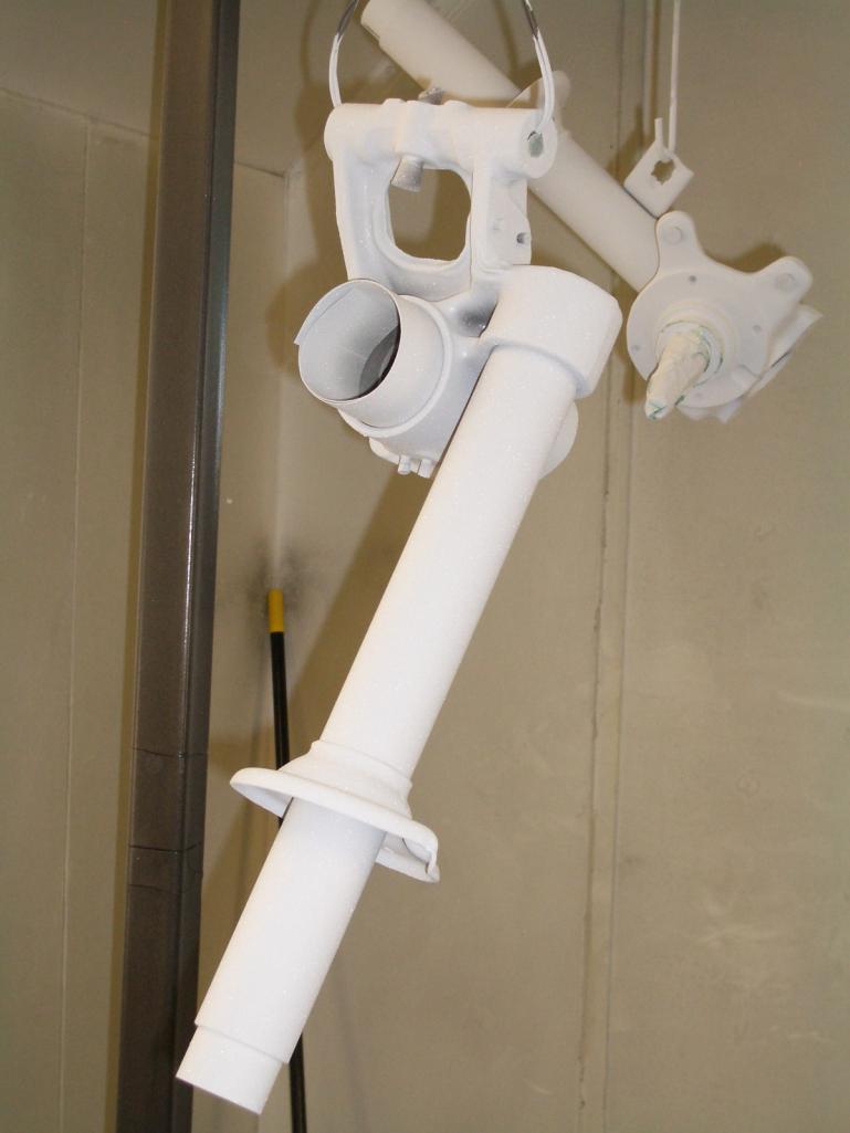

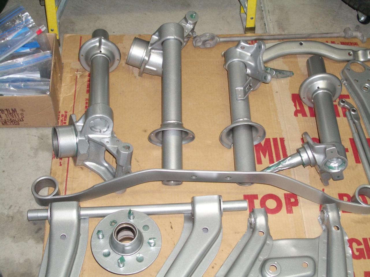

Have you considered powder coating the parts? Since you're planning on media blasting everything, I thought it was worth mentioning. Just did the same thing to the suspension pieces of my early 260Z and went with the powder coating instead of paint as it is more resistant to rock chips and such. Don't mean to hijack your thread but here are a couple pics..

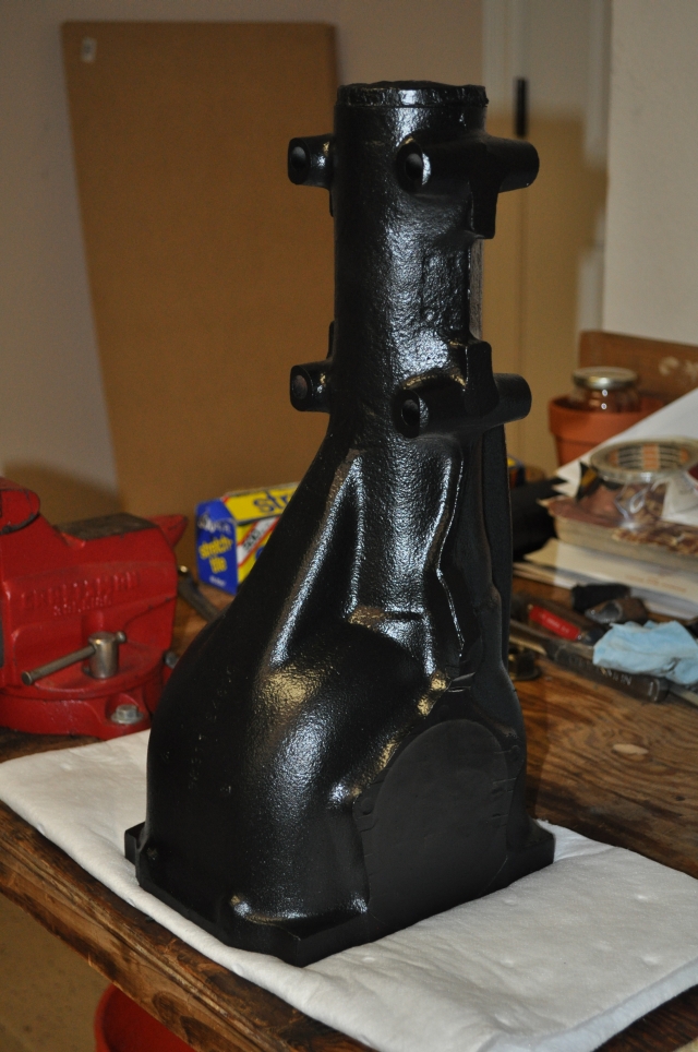

I just got done doing this to the rear of my late 260Z although I opted for the OEM rubber bushings rather than poly. I did not want the harsher ride associated with poly nor the potential of noise that can be created by these bushings.

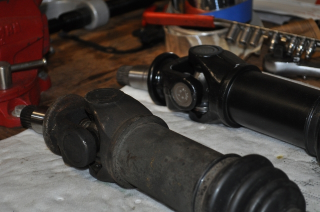

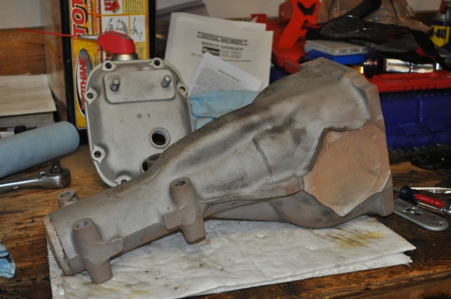

While I was at it I also opted to refresh the diff (clean, paint, new outer bearings and oils seals) so I literally had everything out of the rear end. I also rebuilt the half shafts with new U Joints as well as the drive shaft. Refreshed the electric fuel pump / filter assembly while I was at it as well. Also replaced the and brake cable which turned out to be a little trickier than I thouhgt. This project started as bushings and struts and ended up as a "while I have this apart I might as well ......................."
From a timing perspective, my son and I tore apart the rear (with the exception of the diff) and had it apart in less than a day. Over the course of the next 3 months I took apart all of the sub assemblies (ie struts, springs, shafts, diff, hand brake cable, etc), blasted them, painted them, and put them back together. My goal was to have this all completed by Easter when my son was going to visit me again and re-assemble the rear end. We met the target and had the car re-assembled and back on the road in a couple of days. I was in no hurry to get this completed so I took my time to do it right and would spend a few hours most evenings after work tackling each of the individual pieces.
I also considered power coating but in the end went with paint. I used Eastwood rust encapsulator as a primer and Eastwood Satin Chassis Black as a finish. All of the pieces came out great. I have included a few pictures so you can get an idea.
[ATTACH=CONFIG]44952[/ATTACH][ATTACH=CONFIG]44953[/ATTACH]
Hey Ben.. The powder coating job on the suspension cost about $1300. The job included every piece of the suspension and I didn't media blast the pieces myself.. Springs, sway bars, brake drums and backing plates, rotors and rotor shields, crossmember, fuel tank straps, under engine pan... Everything... Your project will likely cost less as you will be blasting everything yourself. I was able to save some labor costs because the shop allowed me to do all the high temp taping of areas that were not to be coated.
