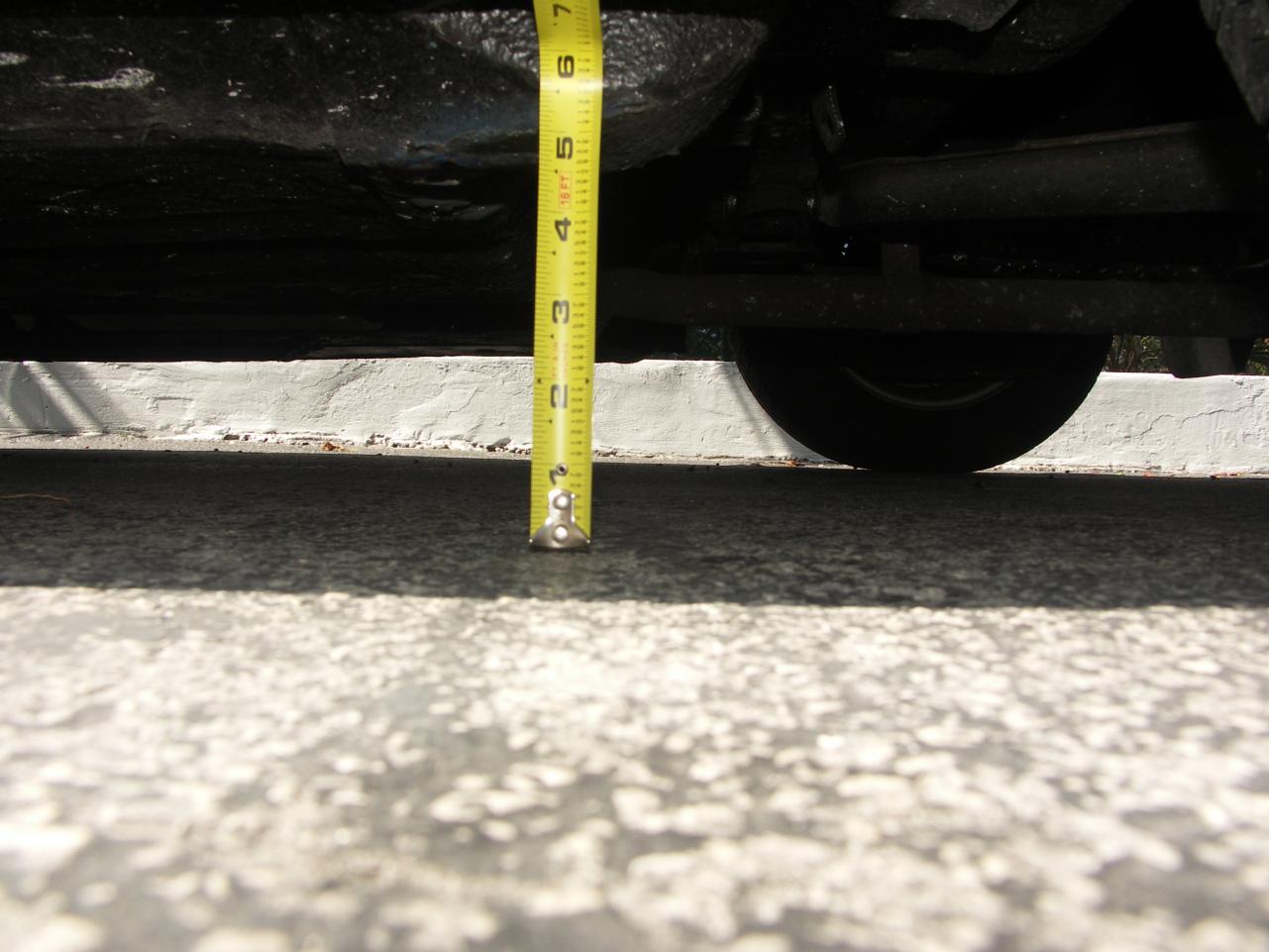

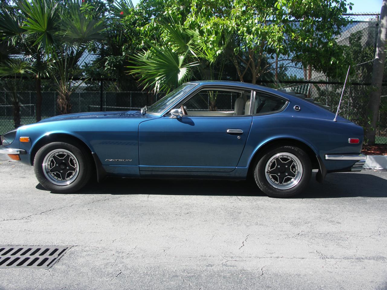

I've had Eibachs with KYBs on my 73 240Z for over a year now. Probably have put 2000 miles on them. So far' date=' so good, despite KYB's warnings not to use them with lowering springs. Other users here report similar success. I like how they ride, too. You end up with about 5 .5 inches of ground clearance when measured from the low spot in the frame rails right in front of the rear tire. See attached pictures. Notice the molded plastic mud flaps. The rear ones are gone now, as they wouldn't clear speed bumps. The front ones are fine, and I've left them on, as they do help prevent rock chips.
One nice thing about the Eibachs is that you barely need a spring compressor to get them on. Easy to install. If I remember right, either the fronts or backs could be compressed enough by hand to get the nut on the strut assembly.post-17507-14150814726117_thumb.jpg
