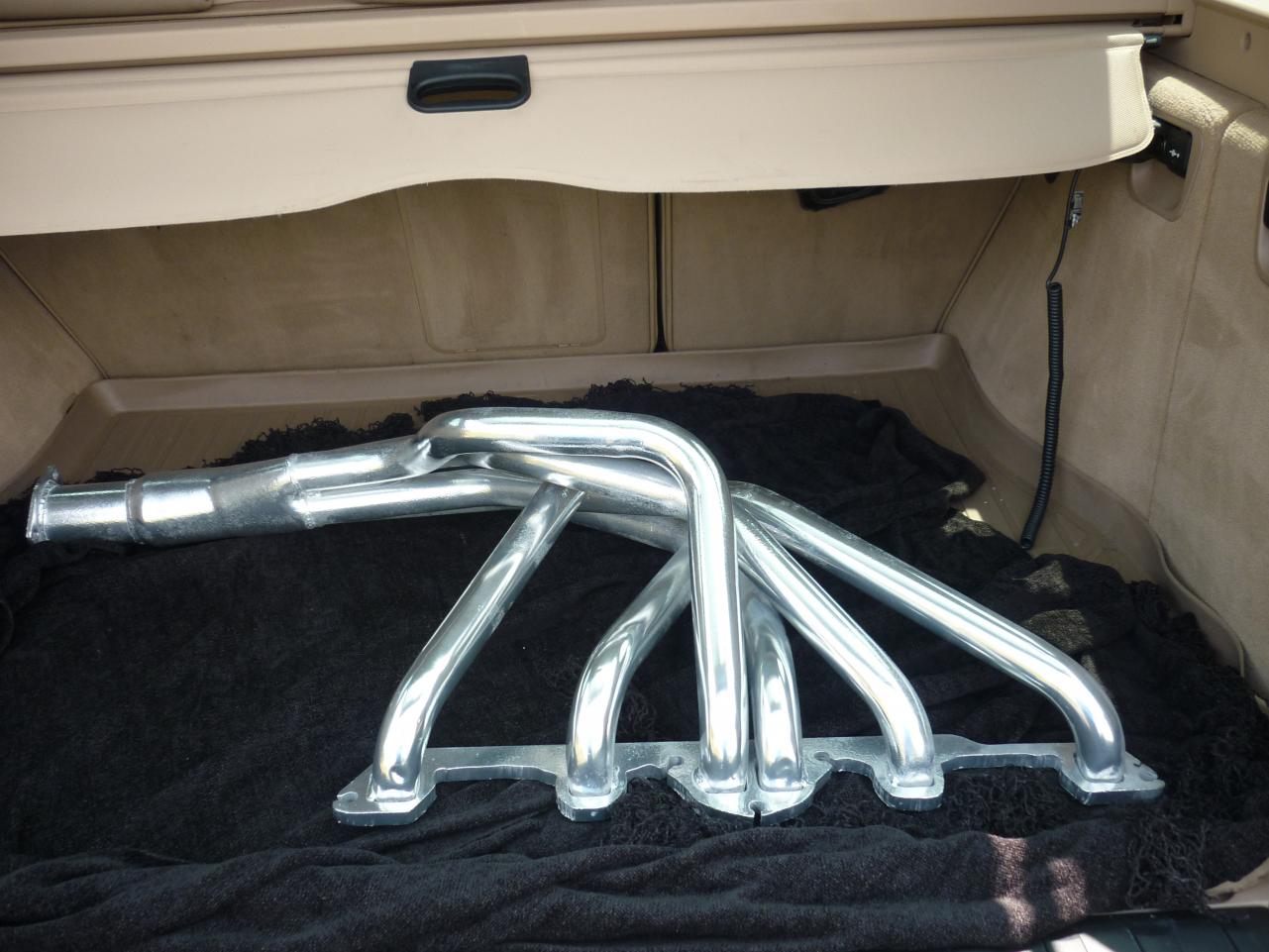

May 8, 201113 yr comment_355132 Leonard your project is looking outstanding! Stunning work as always for ZT!!...........just a thought here, on my engine rebuild last year I send my header to JetHot and had it coated. It will help protect it from rust and reduce heat for those carbs as well. If I remember correctly it was right around $200 give or take. I also had the heat shield done as well - I believe it was $35.....just a thought while I was looking at those beautiful shiny carbs! http://www.jet-hot.com/ Edited May 8, 201113 yr by Travel'n Man Link to comment https://www.classiczcars.com/forums/topic/39497-z-therapy-arrival/#findComment-355132 Share on other sites More sharing options...
May 8, 201113 yr comment_355142 Leonard your project is looking outstanding!Stunning work as always for ZT!!...........just a thought here' date=' on my engine rebuild last year I send my header to JetHot and had it coated. It will help protect it from rust and reduce heat for those carbs as well. If I remember correctly it was right around $200 give or take. I also had the heat shield done as well - I believe it was $35.....just a thought while I was looking at those beautiful shiny carbs! [url']http://www.jet-hot.com/[ATTACH=CONFIG]45118[/ATTACH][ATTACH=CONFIG]45119[/ATTACH]Not to hyjack the thread, but who makes this header? I have the same one on my car and love it but don't know who makes it.Kidd, Its a shame to hide that mill under a hood. Looks really sweet. Link to comment https://www.classiczcars.com/forums/topic/39497-z-therapy-arrival/#findComment-355142 Share on other sites More sharing options...
May 8, 201113 yr Author comment_355147 The header is a pacesetter. Bought new in the box from a private party and thought it was something else. Had a fitment problem (addressed a while back in another thread) with the thickness of the flange but figured it out. Also had to modify the compression washers to clear a couple of the tubes. Going all the way to the back with separate pipes (twice pipes) through a small glass pack and a resonator tip. Travel'n Man, definately doing a plated heat shield. Would like to do the header like you mentioned but am trying to figure out where it all stops. I have almost $14 grand in the car as it is and haven't even fired it yet. Would like to make Canby this year but it ain't looking good.BTW, what should I do to the carbs to keep them pretty? I have a clear coat on the valve cover but not so sure about the carbs. Who is doing what to theirs?Thanks!Leonard Link to comment https://www.classiczcars.com/forums/topic/39497-z-therapy-arrival/#findComment-355147 Share on other sites More sharing options...
May 8, 201113 yr comment_355148 I was actually talking about travelin mans header. I bought mine (same as his) used on Ebay last year when the flat tops went away. I considered the pace setters to save the stainless steel exhaust that the P.O. put on the car but I went with the 2.5 pipe all the way back. I just had to have an exhaust shop remove the 5 foot stainless twice pipe and tie in to the 2.5 inch stainless behind the trannie.I remember the thread you started about the flange issue, and remember thinking that I made the right decision going the way that I did. It would be good to know what I would be looking for if I ever needed to get another set for a new car or to replace what is on mine now. Link to comment https://www.classiczcars.com/forums/topic/39497-z-therapy-arrival/#findComment-355148 Share on other sites More sharing options...
