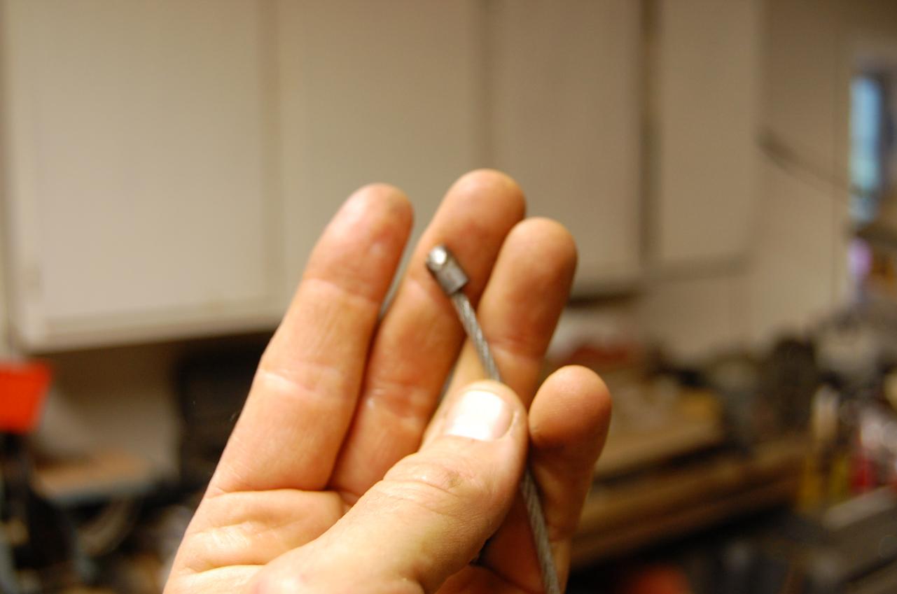

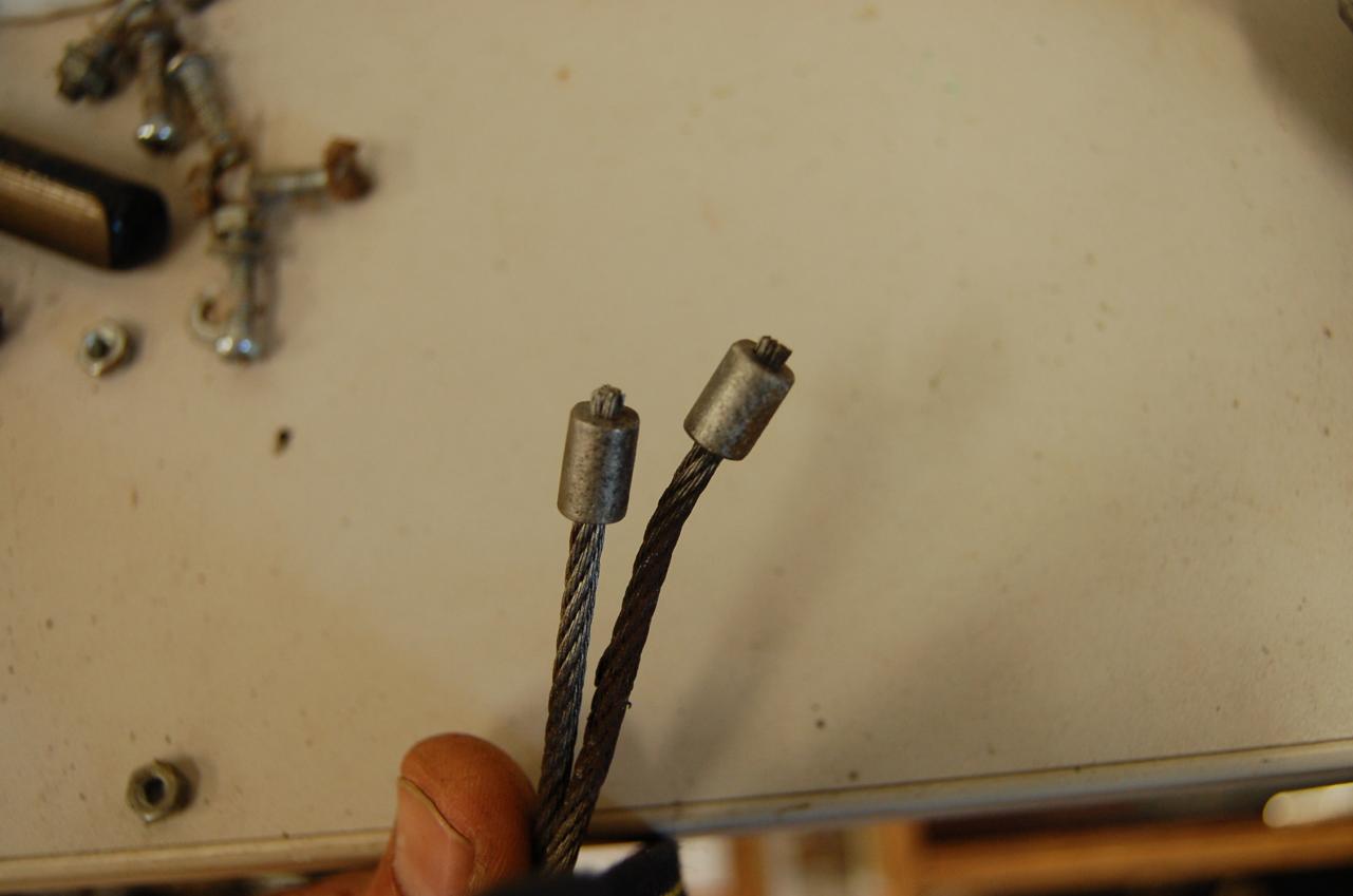

Original cable ends

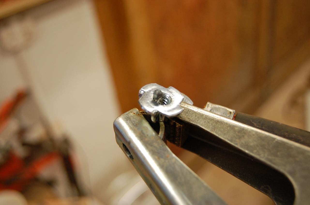

Ready to weld

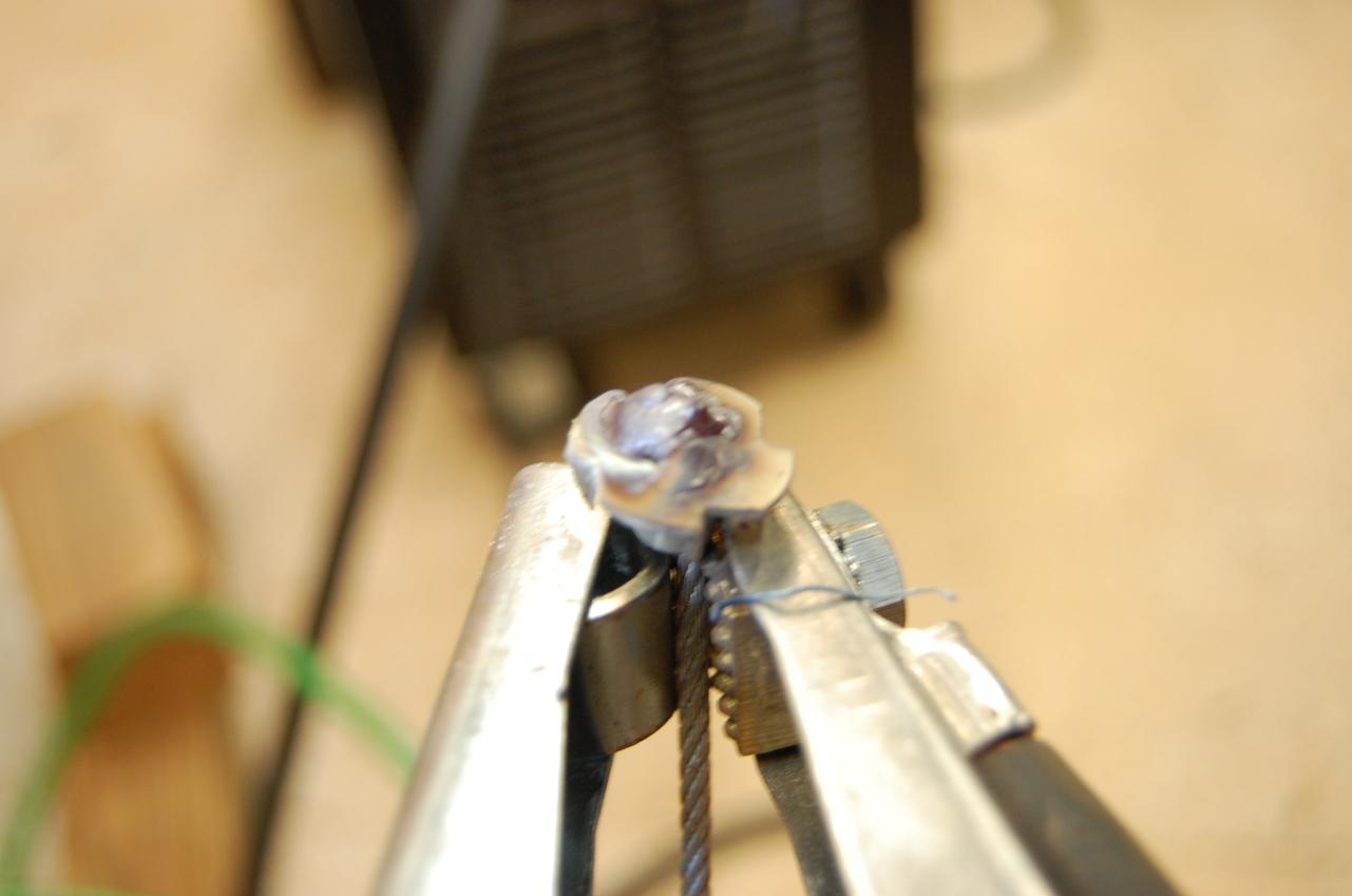

Welded up

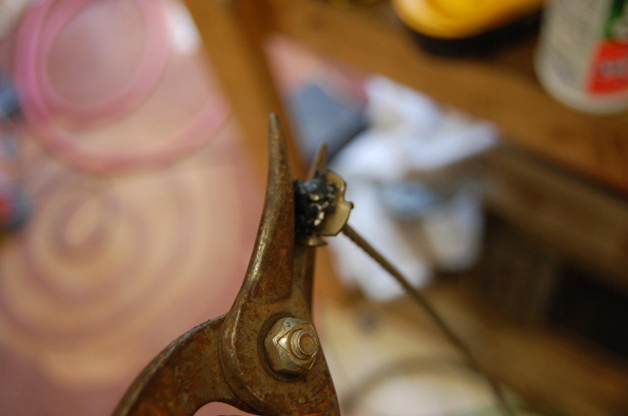

Snip the excess, then grind down

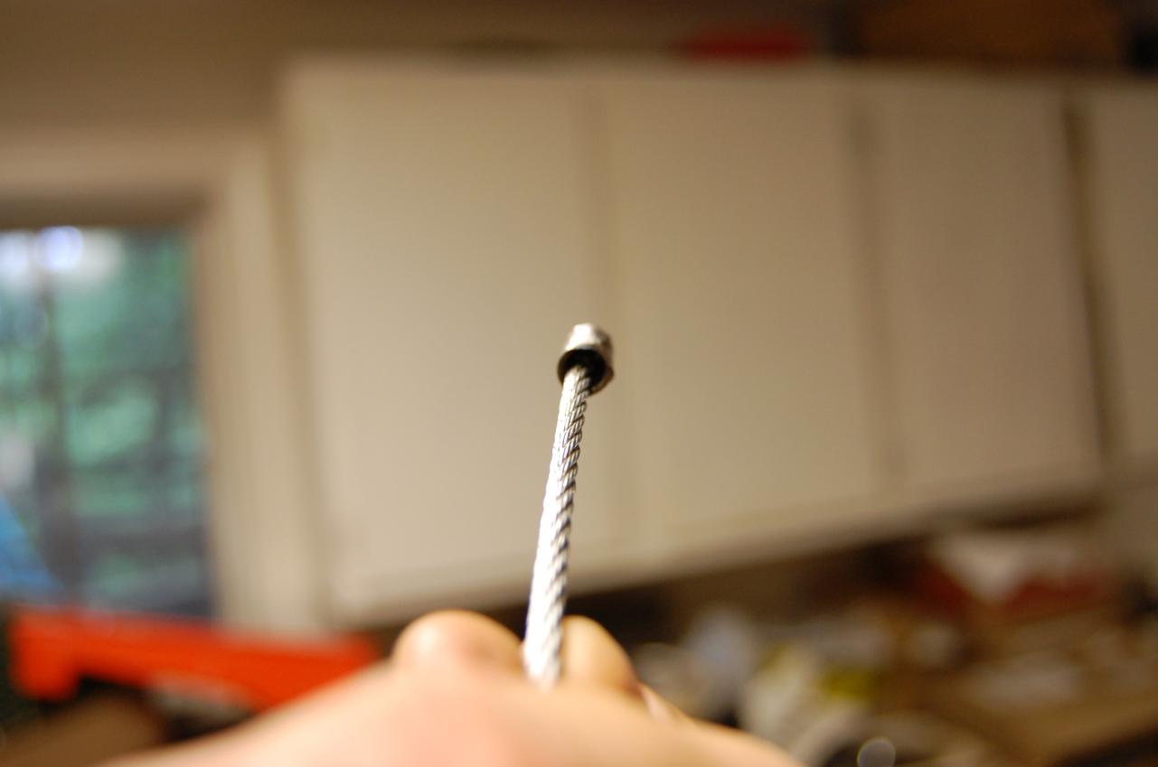

Finished end
