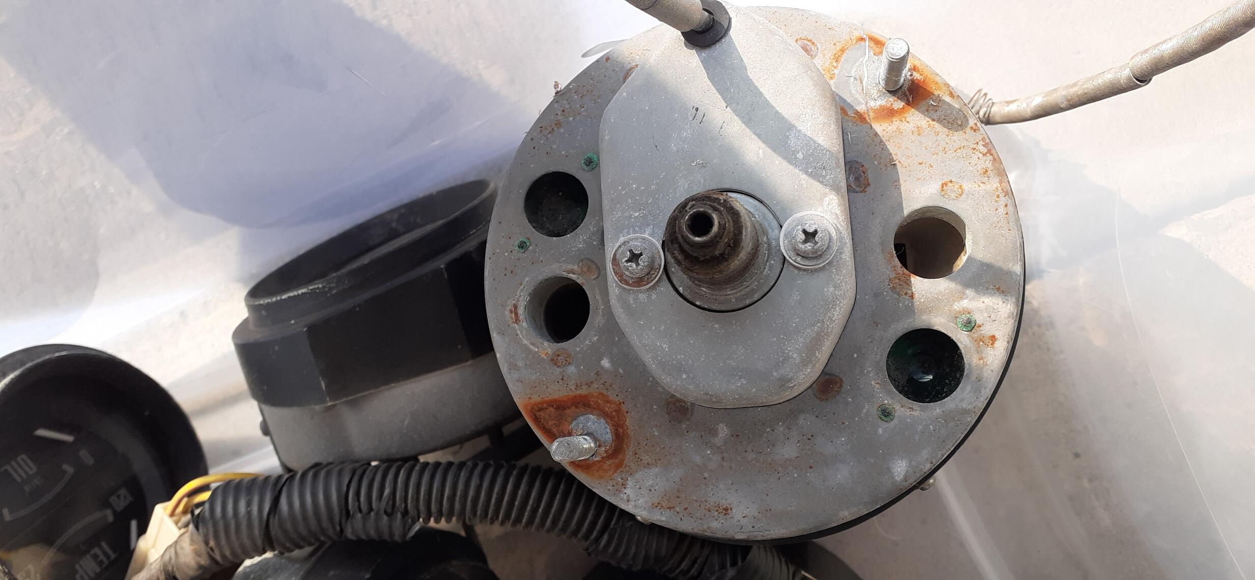

September 25, 20231 yr comment_657472 Is there anyone who has a speedometer from a 240Z and can send me a picture of the back of the speedo. My latest issue on my 73 restoration is that the brake light warning light stays on all the time when the lights are on (only when the lights are on). I'm thinking that on reassembly I may have mixed up the instrument bulb with the warning light bulb. The warning light stays lit when the lights are on even if I disconnect both the emergency brake switch and the brake master cylinder warning switch. Since I can't see the back of the speedo, any switching I would have to do I'd have to do it by feel A picture would help greatly.. Thanks! Link to comment https://www.classiczcars.com/forums/topic/39533-brake-light-in-speedo/?&page=2#findComment-657472 Share on other sites More sharing options...

September 25, 20231 yr comment_657478 2 hours ago, z3beemer said: Is there anyone who has a speedometer from a 240Z and can send me a picture of the back of the speedo. My latest issue on my 73 restoration is that the brake light warning light stays on all the time when the lights are on (only when the lights are on). I'm thinking that on reassembly I may have mixed up the instrument bulb with the warning light bulb. The warning light stays lit when the lights are on even if I disconnect both the emergency brake switch and the brake master cylinder warning switch. Since I can't see the back of the speedo, any switching I would have to do I'd have to do it by feel A picture would help greatly.. Thanks! The gauge illumination and brake light sockets are next to each other. On the top, the high beam light and gauge illumination are next to each other. The brake light bulb has 2 wires, and the gauge illumination has 1 wire, grounding on the speedometer. Link to comment https://www.classiczcars.com/forums/topic/39533-brake-light-in-speedo/?&page=2#findComment-657478 Share on other sites More sharing options...

September 26, 20231 yr comment_657501 Well, the brake light was definitely in the wrong hole. I was able to correct that, and it now works as it should. The high beam indicator also works correctly. Now I have to try to find the open hole to insert the instrument light (by feel). It's times like this I wish I had smaller hands and less arthritis. Link to comment https://www.classiczcars.com/forums/topic/39533-brake-light-in-speedo/?&page=2#findComment-657501 Share on other sites More sharing options...
