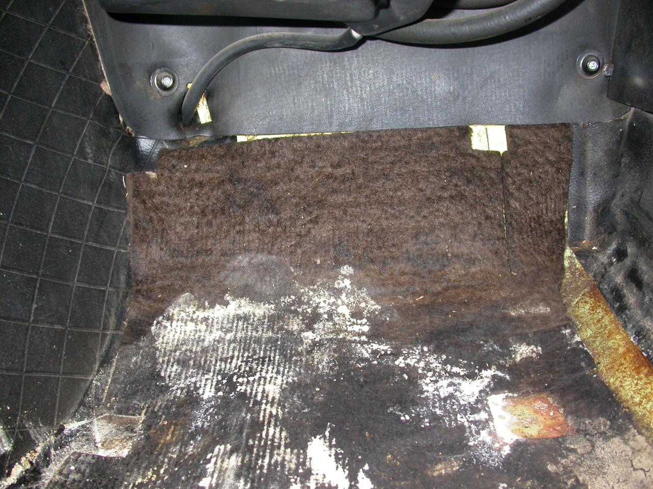

Bob, I know that there was at least two different aftermarket evaporators, each with a different location of the drain tube fitting, that were used with the dealer installed airconditioning systems on the early 240z. I will try to attach a picture of one of the systems showing drain location.
Dan

Thanks EScanlon and AZ 240z, your replies answered my question. I have the flapper with the clamp and hose adapter so I just need to bolt it to the frame. I used AZ 240z photo to locate the hole through the firewall.
Thanks
Bob M
