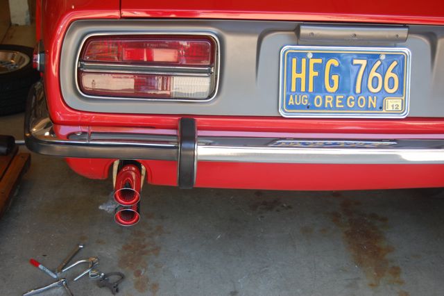

Preview of what's to come. The length of the tips is not finalized (can't do that for certain until I get the MSA system itself), and they will certainly end up shorter, perhaps by as much as 3" each. But this gives you the idea.
Spray the back end of the muffler flat black when it's done and the resonated tips will POP. I think it will look and sound great. I was toying with this idea for a long time. I think I even know which tips you're using, they were on my Summit wish list for months! :)
remember to protect that chrome when you have it welded! The exhaust shop will know though, they do it everyday
:beer:

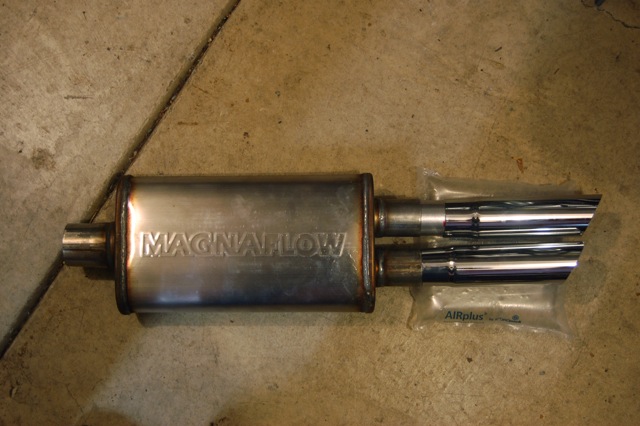

More testing today, and some good news.
1.) MSA reports they shipped the system kit yesterday. I should have it in hand by late Tuesday.

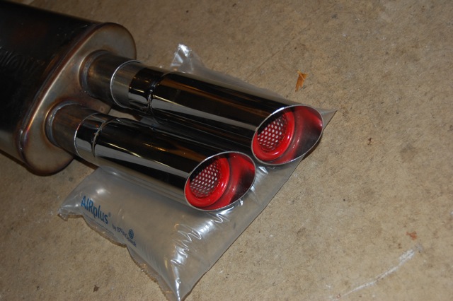

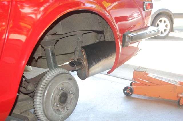

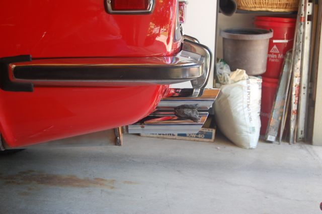

2.) The original plan was to use tips with 2¼" ID inlets over the 2" ID outlets of the muffler. But I changed my mind when I ordered and got 2" ID tips instead. Good call. I took the tips and muffler to a local shop and they expanded the tip inlet to fit snugly over the 2" ID muffler outlets. A much better option.
3.) More mockup and test fitting. Tips and muffler would be easier to position if the tips were 6" long instead of 9", but I'm confident I can make it work.

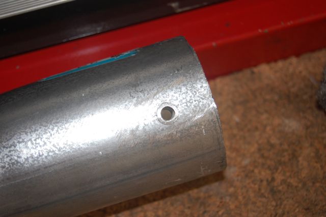

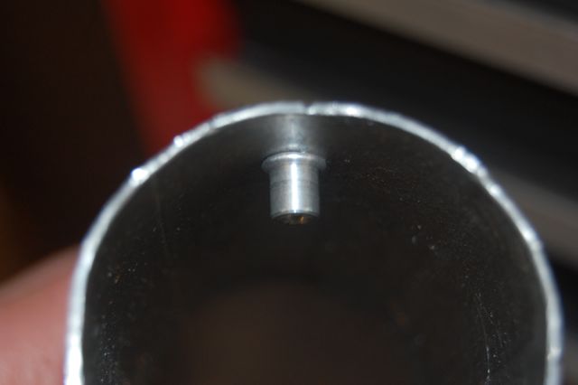

4.) May pass on welding the tips on. I'm now thinking of using rivnuts in the muffler outlets and bolting the tips on. See below for my test rivnut.
Edited by Arne
Excellent "thoughtful planning".
I especially like the rivnut / nutsert implementation.
You will like it when you prep for a show and can take the whole tip to a polishing bench.
a moot btw... I thought of an internal spacer for the 2" to 2.25" pipe and simply using a stock exhaust adapter pipe and slicing it sideways to just have the ring would do the trick... or getting a flat strap of 1" wide sheet metal then hammering/vice-ing 1/8" undulations in it, then wrapping around your inner pipe would do the trick if in a bind.
Yeah, I think the rivnuts will work well. Besides the ability to remove the tips for cleaning, they should allow me to adjust and fine tune the tip fit to make certain the tips are perfectly lined up. (The twin tips on my current Monza are not as well lined up as I would prefer, which is something I want to avoid on this new system.)
I should also be able to attach the rear-most hanger to the tip using one of the rivnuts, and thereby avoid a visible clamp at the rear.
